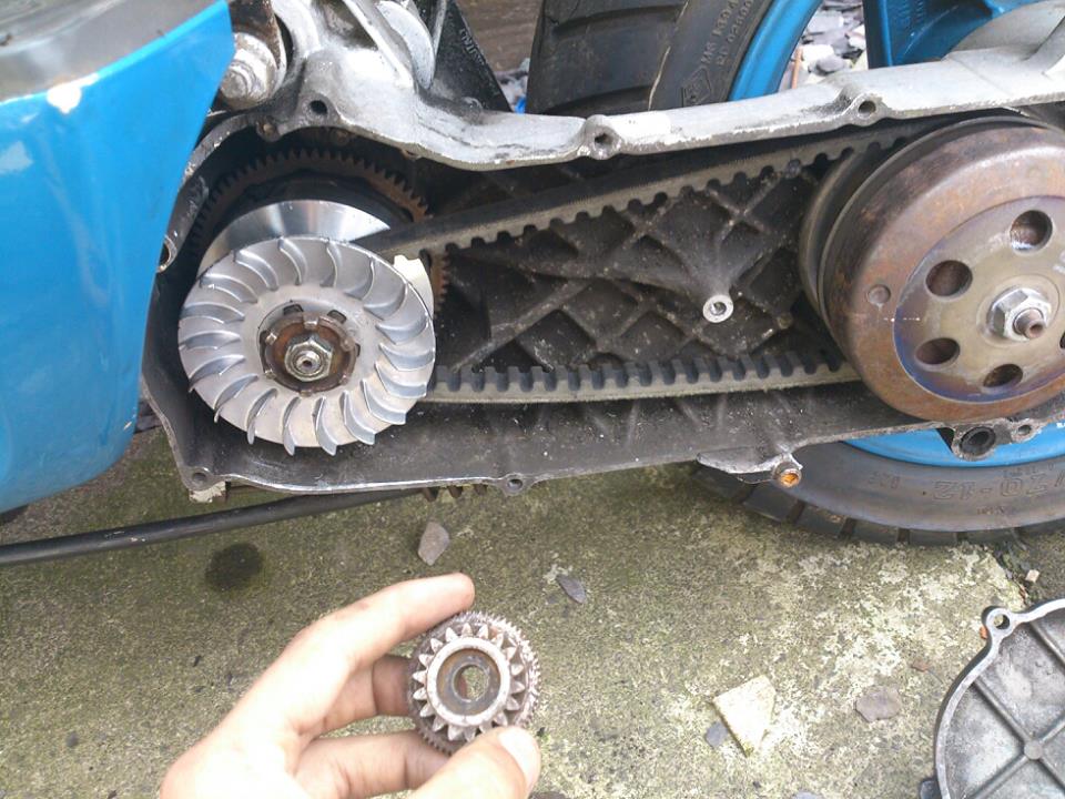

well hello i have a 50cc road legal malaguti and recently the variators teeth have been worn out so i bought a new kit and put the new stuff on then i realize that is a part missing that is a small crank and it something to do with the kick start as ive tryed and will not start

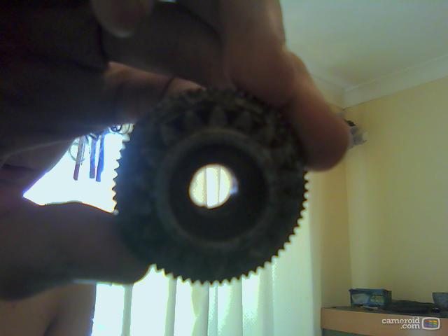

uploaded pic
Hard to see really from the pics.....but I'm guessing that the gear you are holding is the starter gear that meshes between the large toothed cog on the left of the picture and the starter gear......so I think you'll need to pull all that lot off again and you'll probably find where the starter gear is and a stub that this gear sits on between the starter gear and the large flywheel gear....... :wink:
