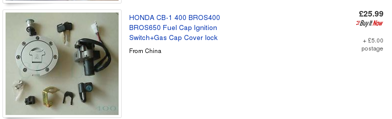

I'd go for the cheapest obvious bits first so on for instance, fleabay there is a kit including the points for 26 quid, or on a UK seller site there's just the points for 22 quid, & if these points pop up easily on a search, imo it means they are a consumable that wears a lot :?
