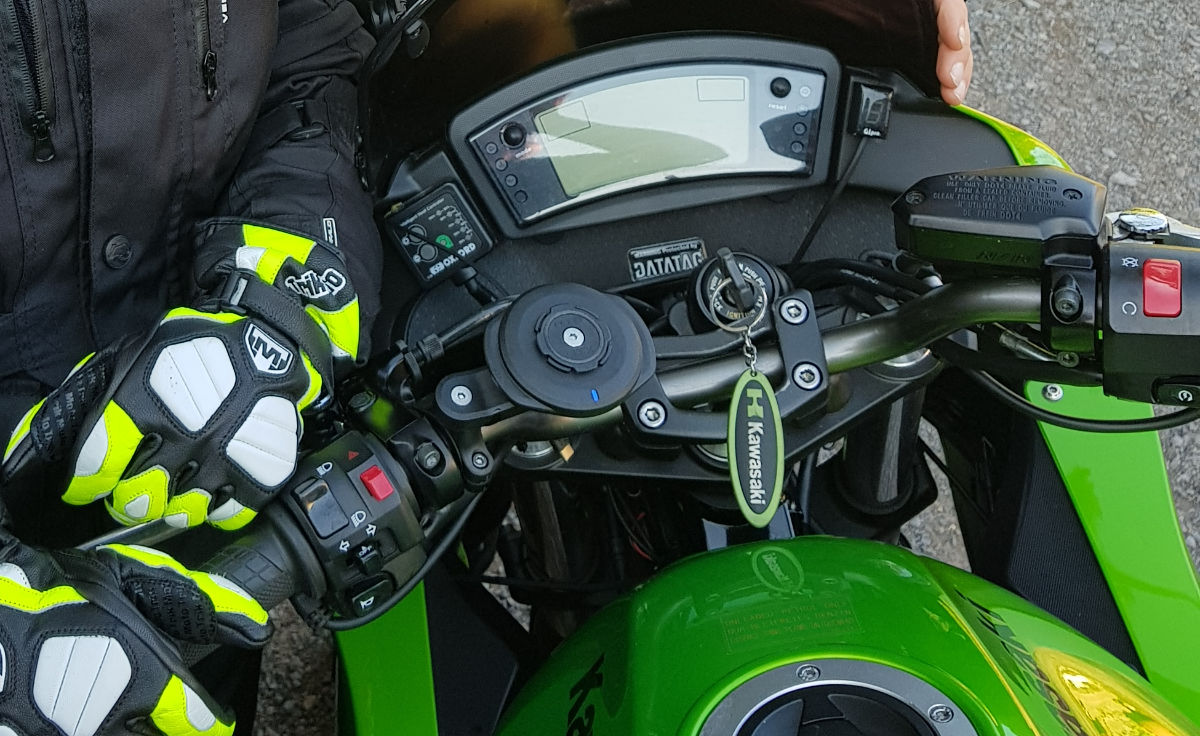

Once your wires are in it's just a case of sympathetically running the wires along your bike and zip tying them up along the way, installing the mount on your handle bar and plugging in the USB to the back.
The mount has a multitude of potential angles, meaning with a bit of playing around you can ensure it's not fowling up the movement of your bars nor obscuring the clocks. In my case I could mount it on the bars themselves, if this is an issue on your bike you can also get adaptors for mirrors or fork stems at the point of purchase.
Here's a pic:
