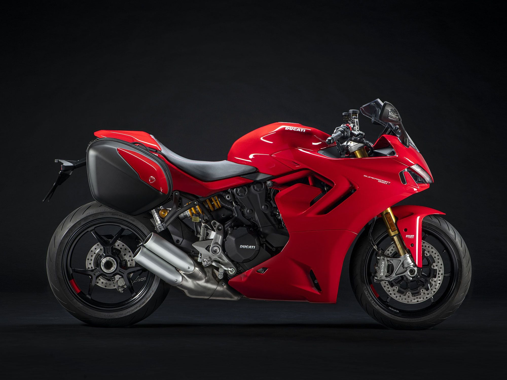

As the Ducati 950 SuperSport enters production, our Italian correspondent Bruno dePrato takes a look back at the past five decades of the SuperSport.
As the Ducati 950 SuperSport enters production, our Italian correspondent Bruno dePrato takes a look back at the past five decades of the SuperSport. (Ducati/)
The new Ducati SuperSport 950 was revealed last November and analyzed here by Seth Richards. Now Ducati has announced that the bike will enter production and is scheduled to go on sale next spring. This is the latest in a lineage of SuperSport Ducati models that runs back to the end of the ’80s, keeping in mind that the mythical Ducati 750 that won the 1972 Imola 200 was based on the first edition of the Ducati “bevel gear” 750 SS.

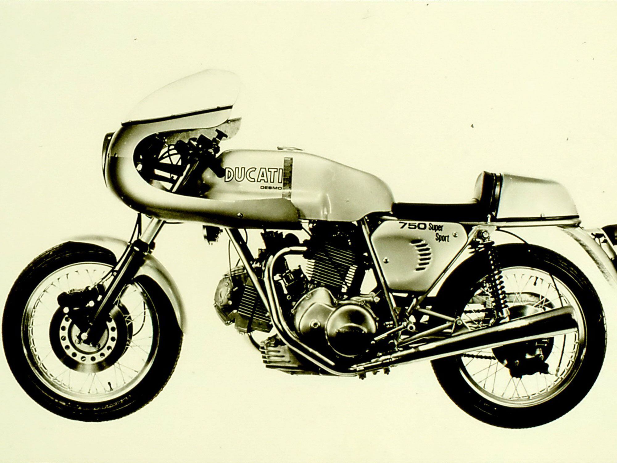

Paul Smart’s 1972 Imola-winning race machine was based on the 750 SS.
Paul Smart’s 1972 Imola-winning race machine was based on the 750 SS. (Ducati/)

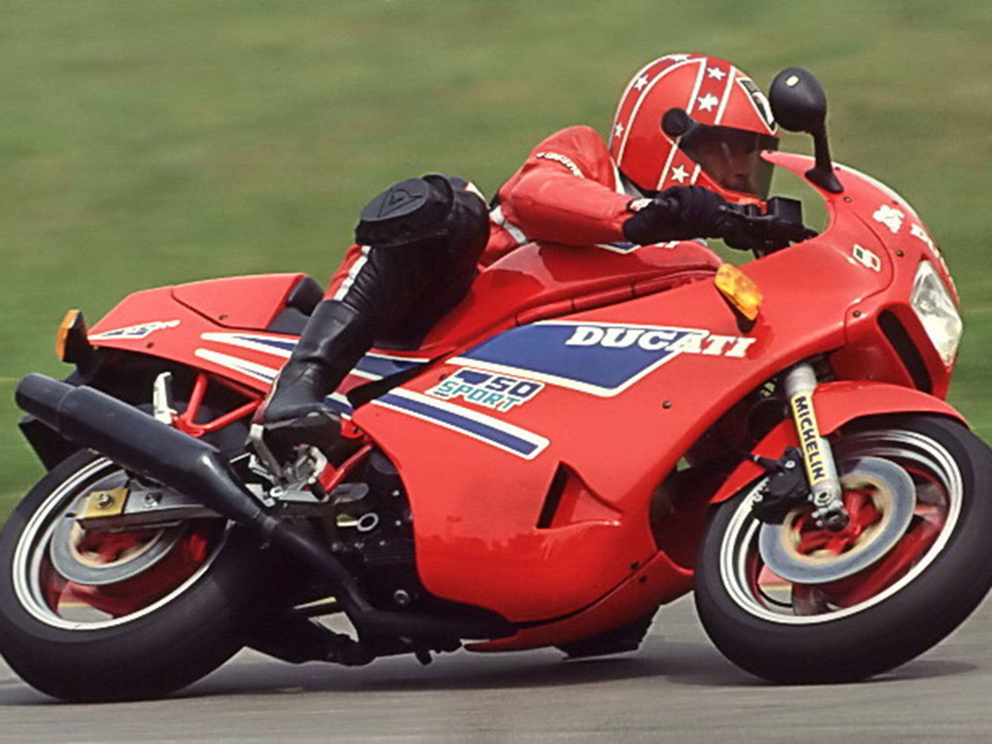

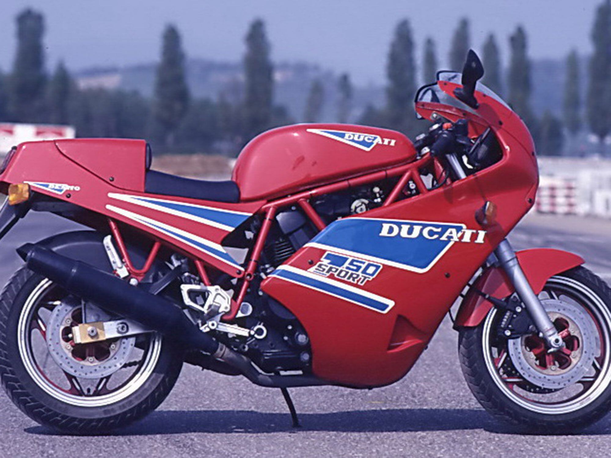

The first Ducati SuperSport 900 model was a huge success largely because Ducati technicians worked quickly to correct the company’s weak first attempt, the 1988 750 Sport, based on the old 750 F1 rolling gear and the Paso 750 power unit. In the very first edition, the chassis was somewhat flex prone due to the rear swingarm structure and the inconsistent quality of its early generation 16-inch radials, and its centrally located Weber twin barrel carburetor didn’t breathe as well at low speeds compared to its installation in the Paso.
The 750 SuperSport was a weak attempt, but the following 900 SuperSport promptly corrected many of the issues.
The 750 SuperSport was a weak attempt, but the following 900 SuperSport promptly corrected many of the issues. (Bruno dePrato Collection/)

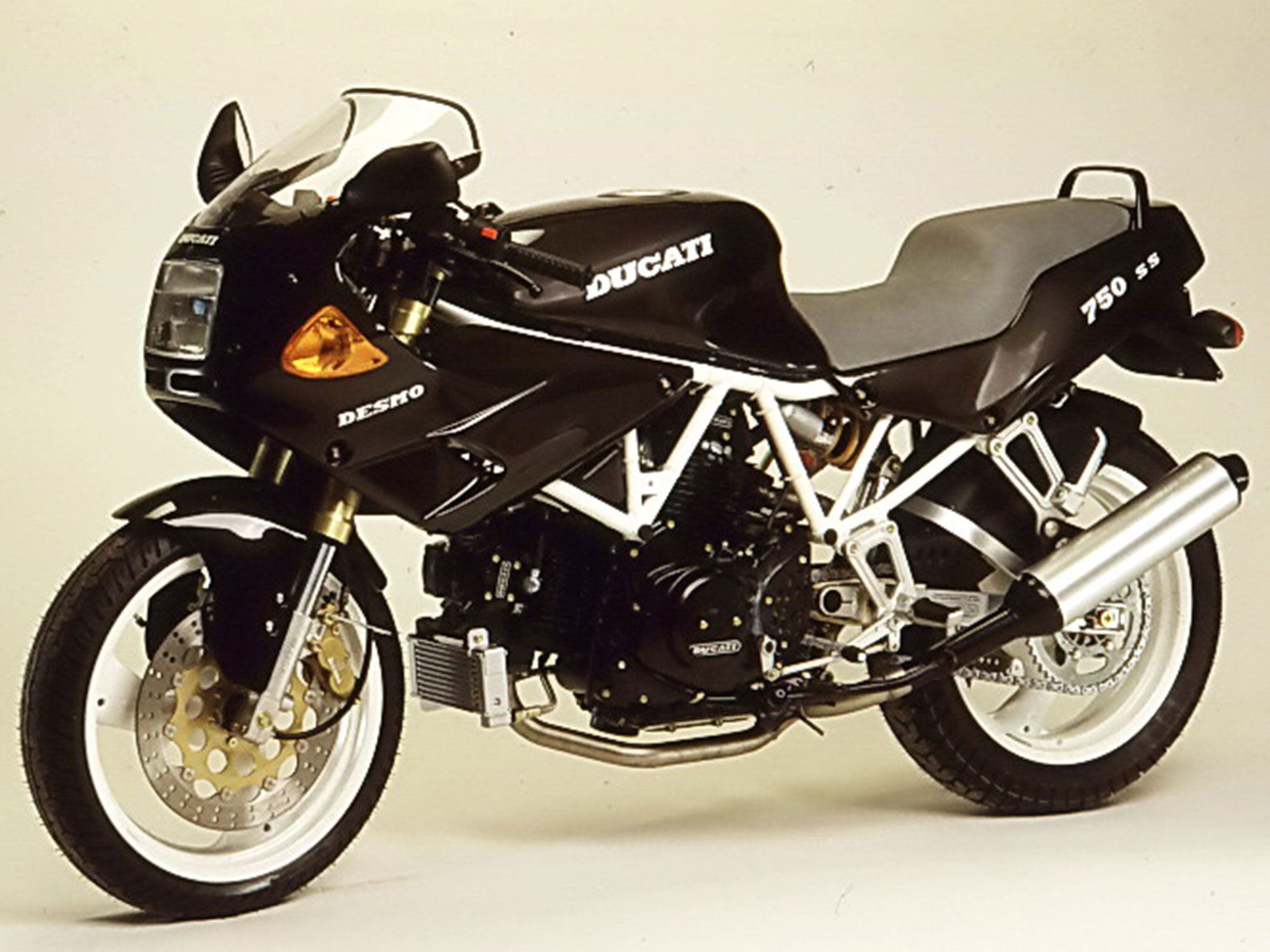

Ducati’s technical team promptly went to work fixing the chassis and installing a new 904cc power unit, giving life to the first 900 SuperSport. The heart of both the old and new bikes was derived from the air-cooled Pantah 500cc SOHC 2-valve desmo designed by Ducati stalwart Dr. Fabio Taglioni. The 904cc version’s 92mm bore and 68mm stroke were housed in a heftier crankcase based on the 851 four-valve desmo’s. This allowed the 900 SuperSport to use Ducati’s new six-speed gearbox. The 904cc engine also received a more effective air-/oil-cooling system that further improved the general efficiency of the 80 hp unit, as improved cooling led to smoother response from the Weber DCOE carburetor.
The 900 SuperSport featured a nicely designed steel-tube trellis frame that set the style for all the units that followed. It shared its 1,450-millimeter/57.0-inch dimensions with the Paso, but not that model’s advanced front end geometry, which at 25 degrees incorporated a steeper steering axis rake. Ducati’s technical team was still strongly tied to their old-style steering geometries, and consequently the 900 SuperSport featured a heavier 28-degree rake angle. The 900 SuperSport was lean, relatively light, and represented an attractive value for the money given its price to performance ratio.
The 1989 750 SuperSport on the track.
The 1989 750 SuperSport on the track. (Bruno dePrato Collection/)

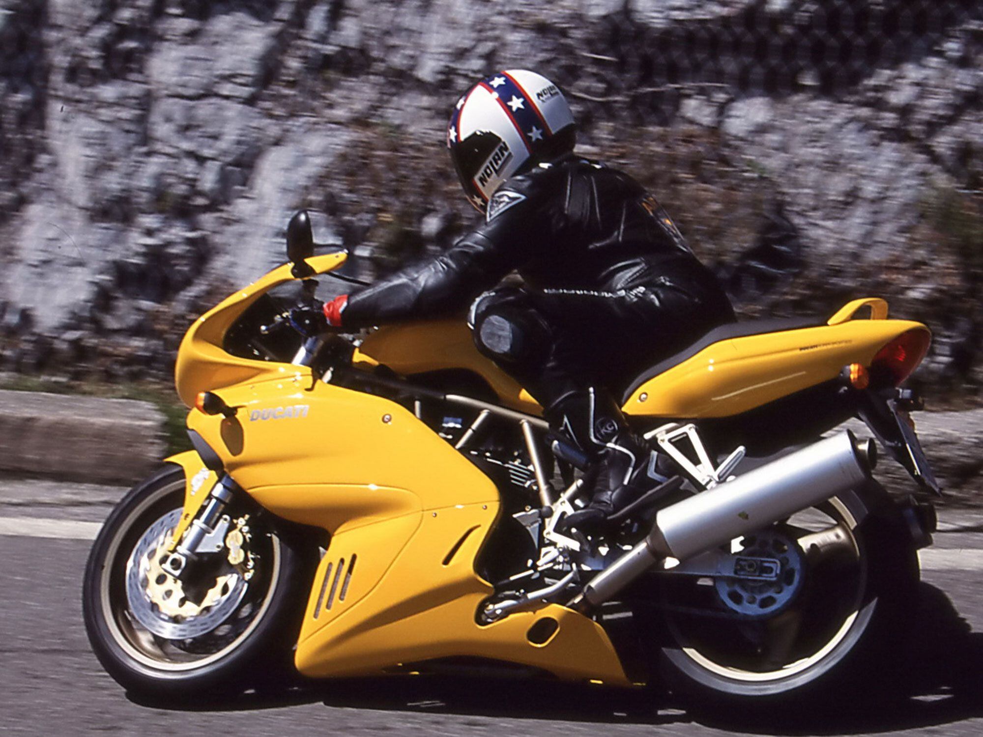

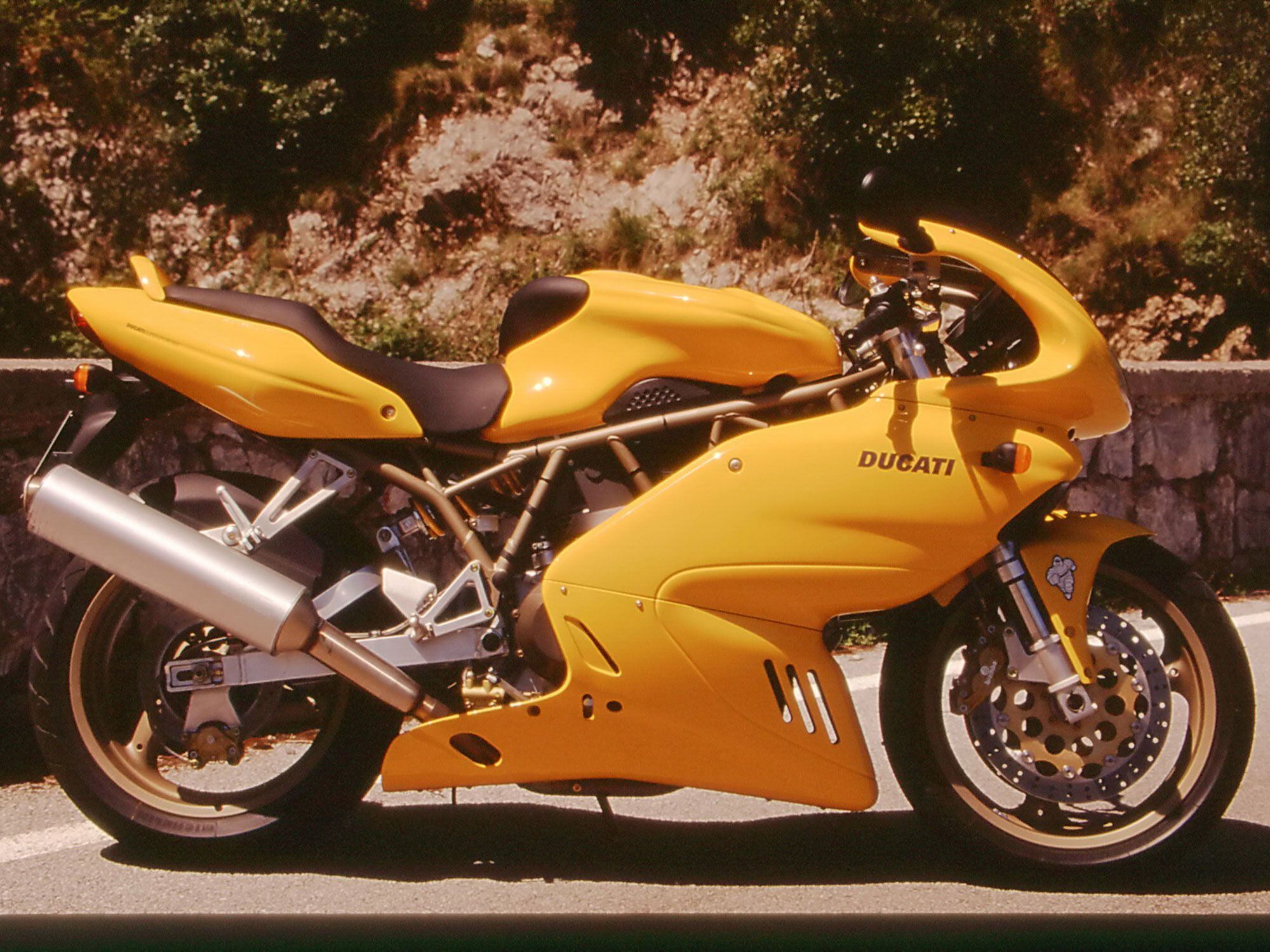

The second-generation SuperSport got more torsional rigidity and a shorter wheelbase.
The second-generation SuperSport got more torsional rigidity and a shorter wheelbase. (Bruno dePrato Collection/)
The new SuperSport models spanned a much shorter 54.9-inch wheelbase and had steeper steering geometry, with 24 degrees of rake and 100mm trail. While the steering geometry numbers meant that the Ducati technical team had fully absorbed Dr. Tamburini’s lessons, the 2.1-inch-shorter wheelbase prevented the new chassis from taking full advantage of it. While the front wheel had indeed been moved closer to the center of gravity, it was only by about a half-inch, once the transition from the previous small-diameter 16-inch tires to the new 17-inch radials was taken into consideration. The “L” configuration of Ducati’s air-cooled SOHC V-twin had no mercy, its shape and placement preventing the front wheel from moving any further back. Thus, a good share of the removed 2.1 inches was gained at the rear, causing a more rearward weight distribution bias.
The shorter wheelbase in turn forced a taller seat height, which grew from 29.5 to 32.3 inches. In the case of a 200-pound rider (me), the combination resulted in a less confidence-inspiring feel. Despite the steeper steering geometry, the rearward weight distribution still forced the front end too wide in the turns. Luckily, the solid frame structure ensured excellent high-speed stability.

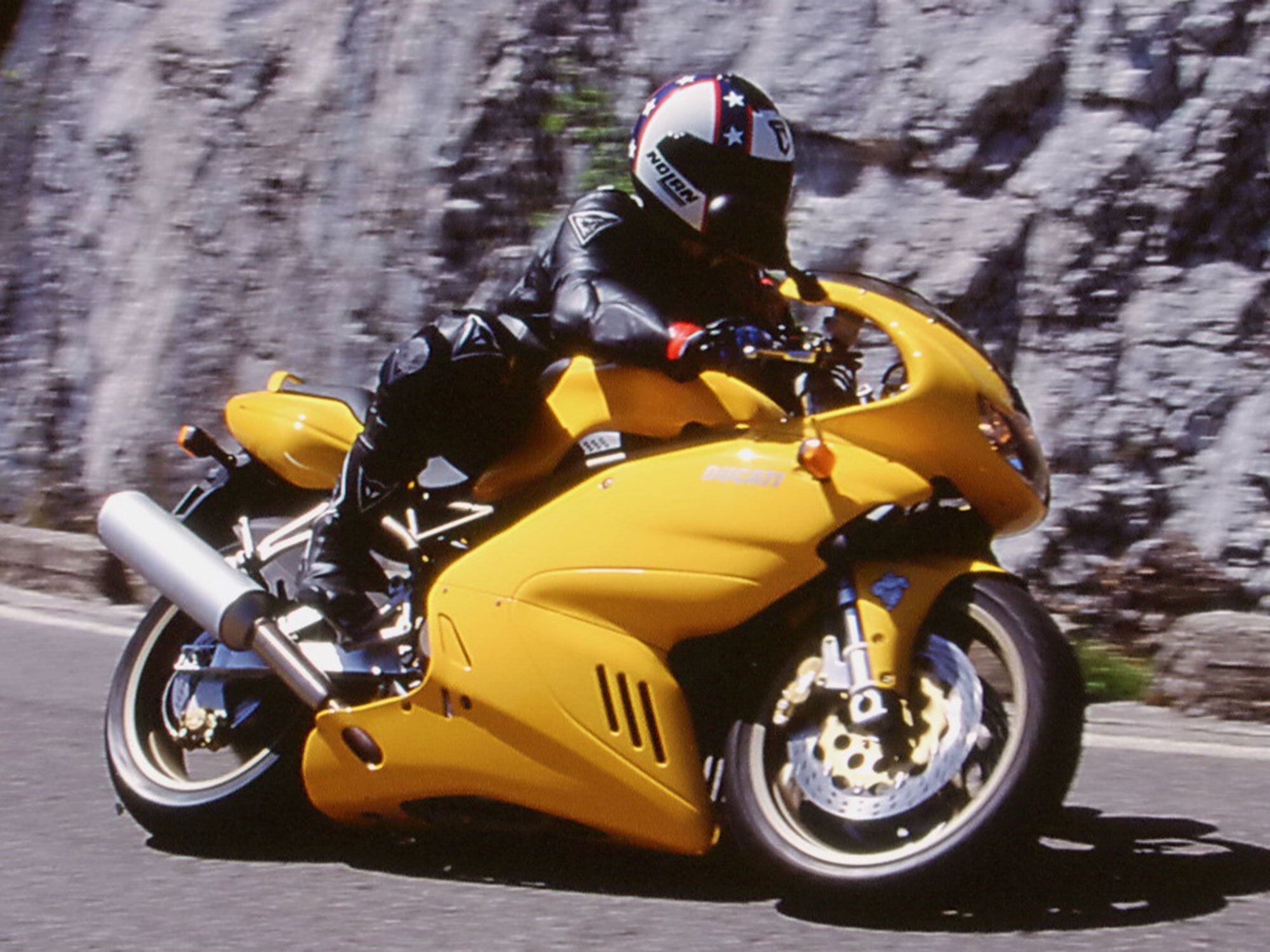

The second-generation SuperSport was an excellent performer.
The second-generation SuperSport was an excellent performer. (Bruno dePrato Collection/)
The bike was a very good performer, thanks primarily to its unusually strong and progressive engine. The motorcycle was very well equipped in all departments, with lightweight Marchesini aluminum wheels, a full Brembo Gold braking system featuring twin 320mm front rotors, an oil cooler, and Michelin Pilot Sport radials. At that stage of its life the 1000 SuperSport was not priced cheaply, at more than 10,000 euros, but it was still a very attractive value for lovers of Italian sportbikes.
And there was one thing about the bike that did not work. Ducati hired South African designer Pierre Terblanche. But his styling for the motorcycle was bulbous, unclean, almost crooked. The previous generation might have looked a bit basic, but it was simple and neat, as expected of a Ducati. The second-generation SuperSport series was a flop. In 2007, Ducati shut down production.
Pierre Terblanche’s design on the second-generation SuperSport was not well received.
Pierre Terblanche’s design on the second-generation SuperSport was not well received. (Ducati/)

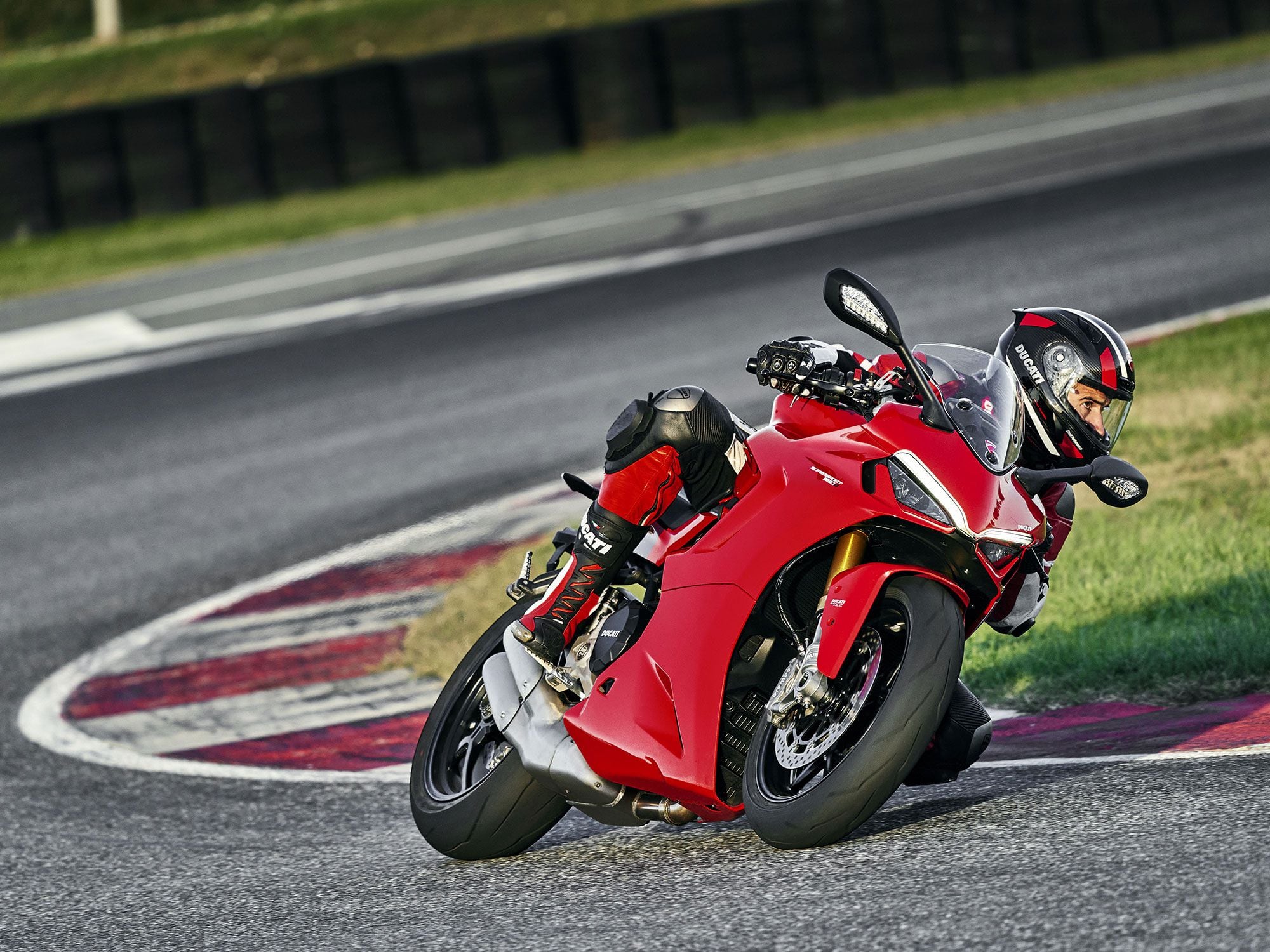

Ten years later Ducati resurrected the SuperSport logo. Cycle World thoroughly tested the bike that, as in previous generations, was intended as the perfect sportbike for the common rider. The bike is state of the art in many respects; its chassis is intended for the Panigale engine, and when teamed with the mildly tuned 950cc Testastretta V-twin, delivers a glorious combination of great dynamic qualities and smooth power delivery. The motorcycle is easy to harness and keep under full control in perfect safety, with the assistance of one of the most advanced electronics suites in the business. It’s a supremely capable sport-touring bike, the likes of which we have been missing for years. It even included nicely designed touring bags, emphasizing the “touring” element of its avocation.

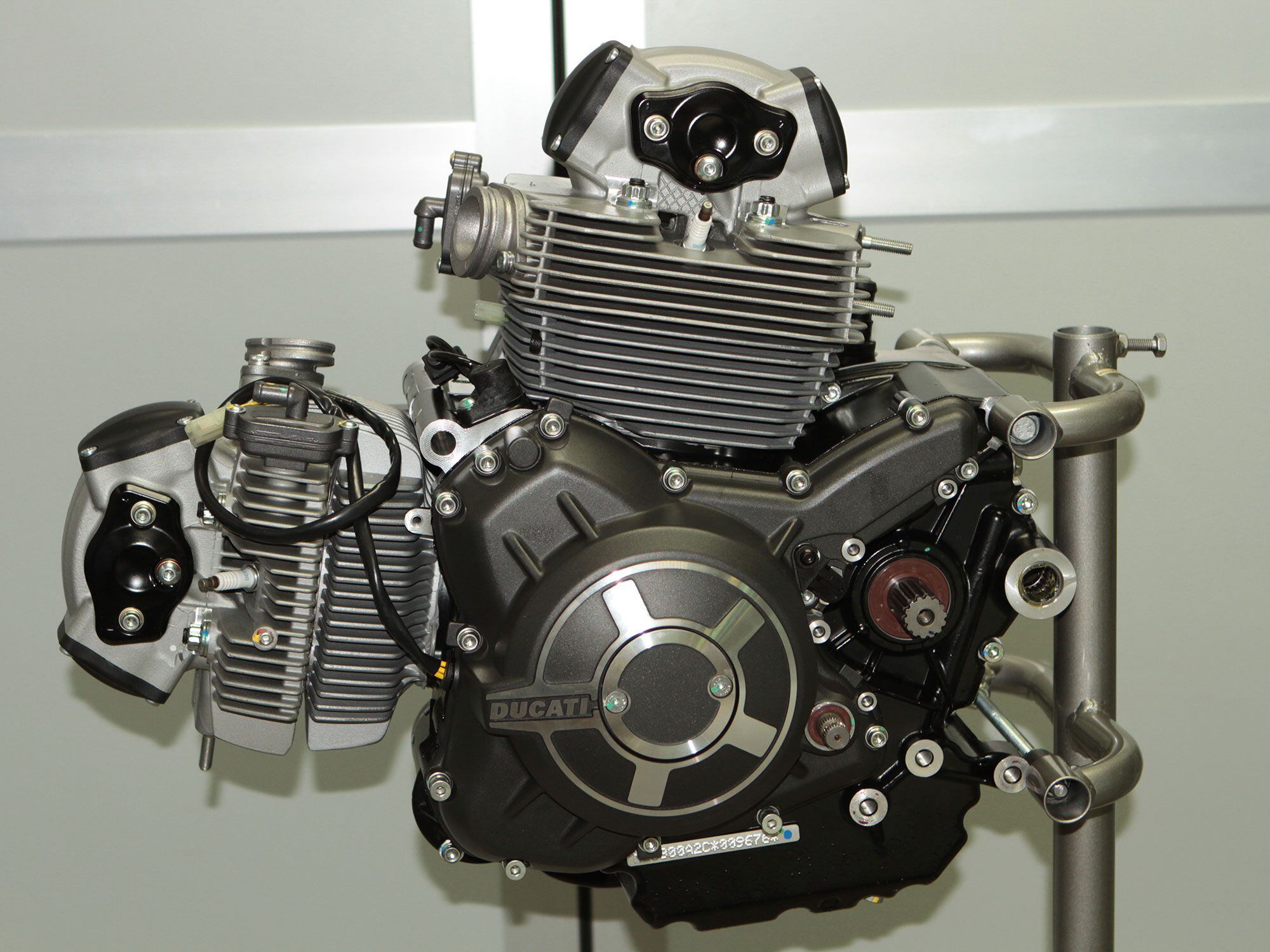

The air-cooled SOHC L-twin at the center of the SuperSport’s success is now powering the highly popular Scrambler line.
The air-cooled SOHC L-twin at the center of the SuperSport’s success is now powering the highly popular Scrambler line. (Bruno dePrato/)
Yet it is not exactly the natural heir of the old SuperSport. This is a much richer, much more sophisticated bike, more expensive, but also more versatile. I would say that, when looking back to the previous generations, it misses the basic, versatile power unit that the air-cooled SOHC V-2 was and that determined the good value for money price.
Will the 950 SuperSport sell 10,000 units like SOHC-powered units that came before it? Only time will tell.
Will the 950 SuperSport sell 10,000 units like SOHC-powered units that came before it? Only time will tell. (Ducati/)
That legendary V-2 still is there—in Ducati’s new 1,100cc, 86 hp edition that might be adequate for an old-style, low-price, basic SuperSport. But I might have gone a bit too far down memory lane. Even in a sport-tourer, today’s riders want state-of-the-art technology, refinement, power in reserve, versatility, comfort, and safety. The Ducati SuperSport 950 coming to the market in about a month enhances the qualities of the previous version, adds all the modern technology that is required of a Ducati, and will get the job done smartly and in style. But probably it will not sell 10,000 units a year like the old ones did.
