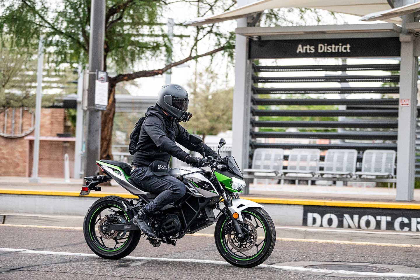

Simple but still stylish, in its own way. The Z e-1 weighs 298 pounds and gets a surprising amount of attention while cruising around town.
Simple but still stylish, in its own way. The Z e-1 weighs 298 pounds and gets a surprising amount of attention while cruising around town. (Kawasaki/)

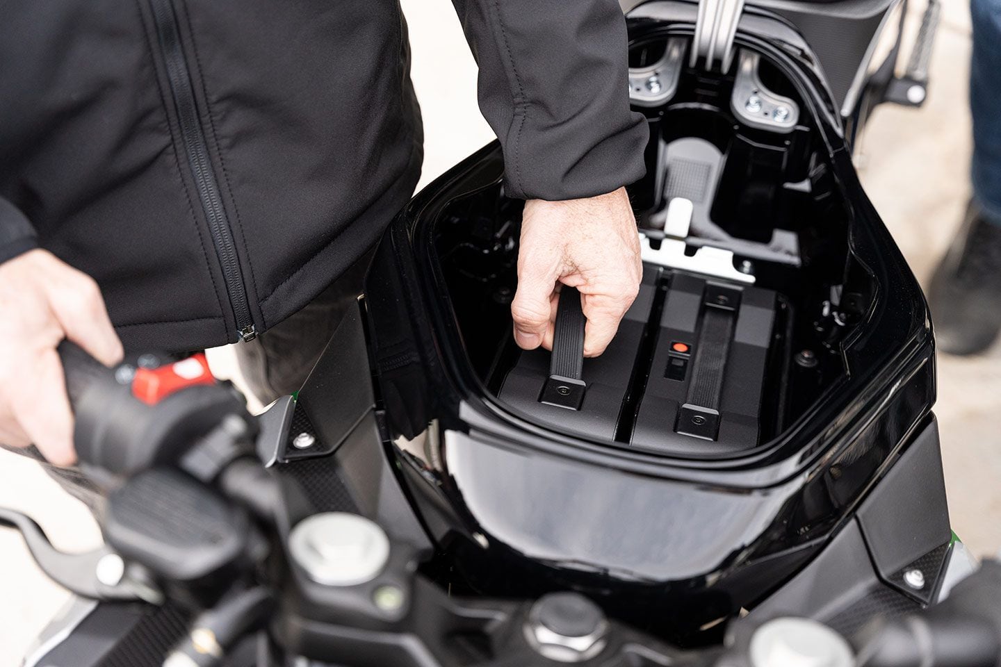

Removable, dual lithium-ion batteries are mounted beneath a faux gas tank and weigh 25.3 pounds each. They have a nominal capacity of 30Ah and a nominal voltage of 50.4V. Total capacity is 60Ah. Range is a claimed 41 miles, which reaffirms the bikes’ intentions as urban commuters and will keep your rides short if you don’t plan to recharge midday (e.g. at work).
Lithium-ion batteries are run in parallel and mounted beneath a “tank cover.” Removal takes just seconds.
Lithium-ion batteries are run in parallel and mounted beneath a “tank cover.” Removal takes just seconds. (Kawasaki/)

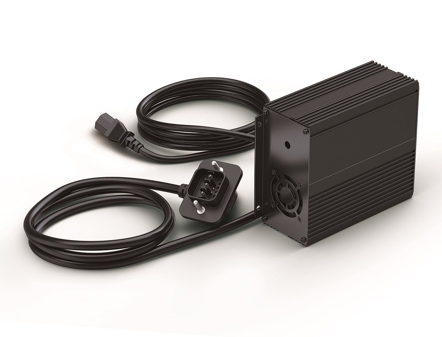

The batteries can be charged on the bike or carried indoors and charged in the comfort of your home or office via the same charger, which plugs into a standard 120V wall socket. Total charge time is 7.4 hours, or 3.7 hours per battery. Worth mentioning is that those batteries will charge simultaneously when in the bike, but can only be charged one at a time when removed, unless you purchase a second charger.
You can, of course, do partial charges. Kawasaki says it takes 1.6 hours to take one battery from 20 to 85 percent charge. That’s not all that different from how you likely use and charge your phone.

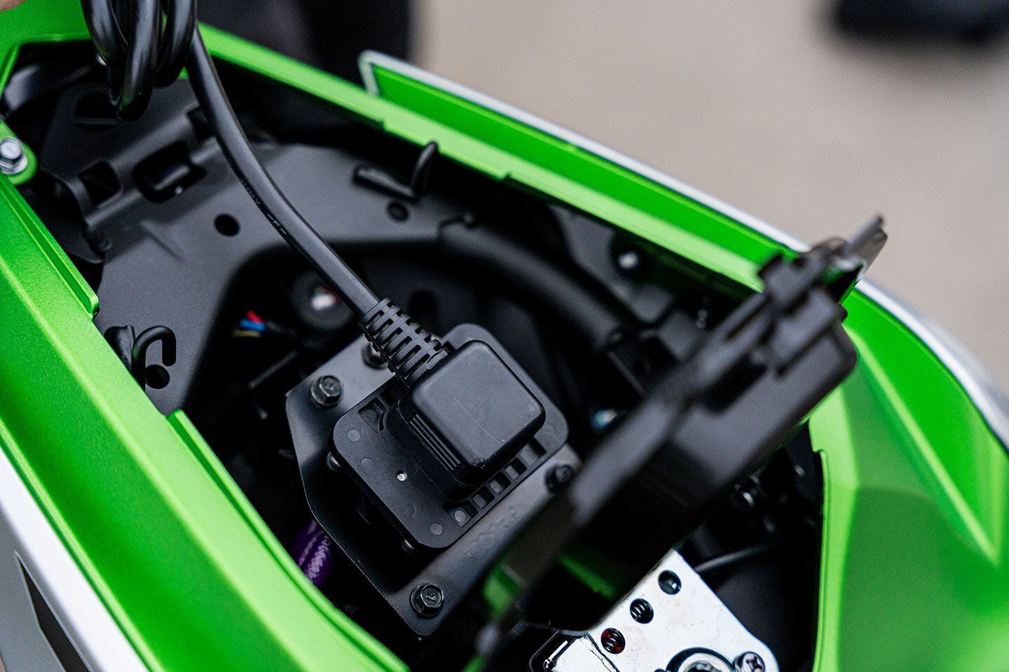

Batteries can be charged one at a time off the bike, or left in the bike and charged simultaneously, by plugging the charger into this charge port in the bike’s tailsection.
Batteries can be charged one at a time off the bike, or left in the bike and charged simultaneously, by plugging the charger into this charge port in the bike’s tailsection. (Kawasaki/)

The e-1’s charger can be plugged into any 120V socket.
The e-1’s charger can be plugged into any 120V socket. (Kawasaki/)

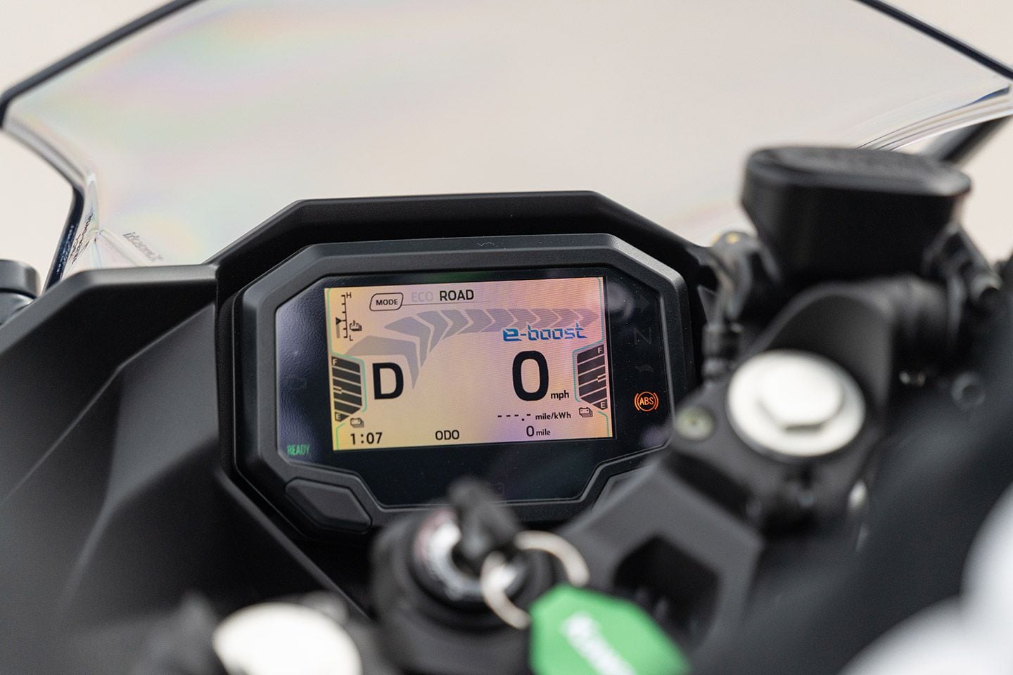

A 4.3-inch TFT display has two battery gauges and other pertinent information. E-boost bars will disappear as that function is used.
A 4.3-inch TFT display has two battery gauges and other pertinent information. E-boost bars will disappear as that function is used. (Kawasaki/)
E-boost status, battery charge, speed, and all other pertinent information is displayed on a 4.3-inch TFT display. Ride information and battery status can also be referenced via Kawasaki’s Rideology app.

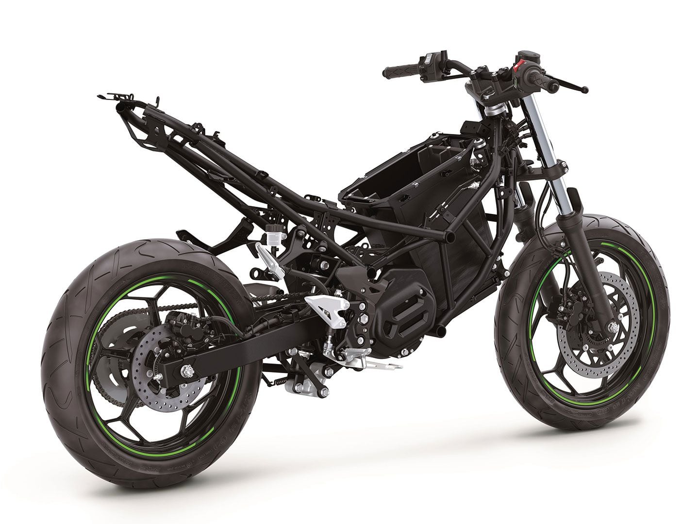

A steel trellis-style frame loosely resembles the chassis used elsewhere in Kawasaki’s lineup but has model-specific rigidity and low mounting positions for the electric motor, which helps lower the center of gravity.
Speaking of weight, the Ninja e-1 and Z e-1 are lighter than the Ninja 500 and Z500 that they’ll share showroom floors with; the Ninja e-1 weighs 309 pounds, and the Z e-1 298 pounds. That’s significantly lighter when compared to the ABS-equipped Ninja 500, which weighs 375 pounds, and the Z500, which weighs 366 pounds.
Related: Most Interesting Electric Motorcycles of 2023
Packaging is important when working with two 25.3-pound batteries. A steel-trellis frame helps keep weight down and provide the necessary room.
Packaging is important when working with two 25.3-pound batteries. A steel-trellis frame helps keep weight down and provide the necessary room. (Kawasaki/)
