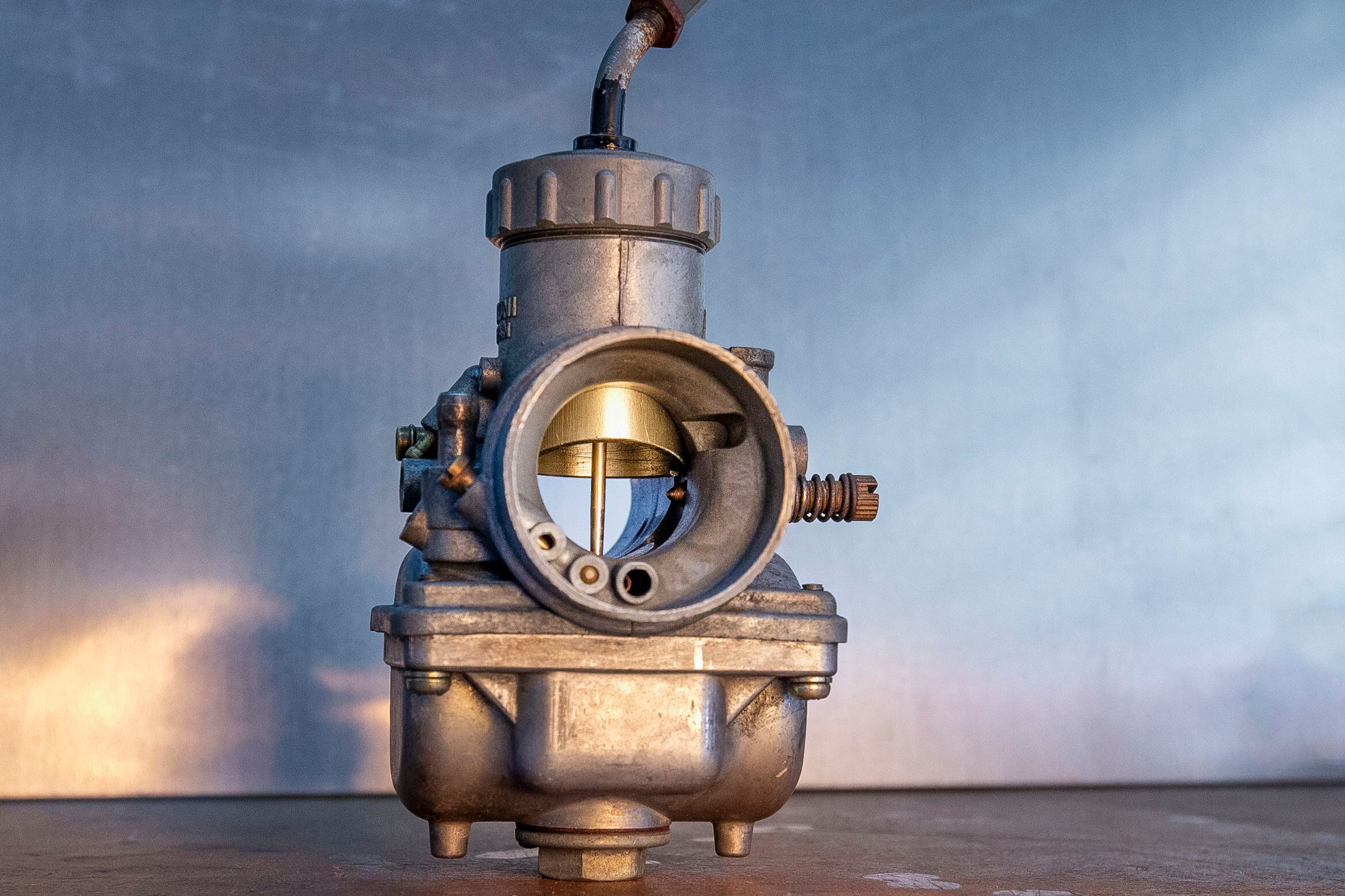

In 1893 Wilhelm Maybach patented the spray carburetor. It made use of the fact that moving air has less pressure than still air: The partial vacuum in fast-flowing intake air allowed the higher pressure in a nearby fuel reservoir (aka float bowl) to push fuel into that intake airstream.
As air moves through the carburetor, fuel is pushed into the airstream.
As air moves through the carburetor, fuel is pushed into the airstream. (Mark Hoyer/)
In the collision of fuel with intake air moving at hundreds of feet per second, the fuel stream was broken up into particles held in roughly spherical form by the fuel’s surface tension (surface tension is what allows the insects known as “water striders” to walk on water). The pressure of the air upon hitting such droplets first flattens, then punches in their upstream faces. Surface tension then pulls them into the form of tiny rings whose wobbly instability causes them to break up into even smaller droplets. The higher the air velocity, the finer the droplet size.
Droplet breakup increases the total fuel surface area exposed to the surrounding air, accelerating fuel evaporation.
