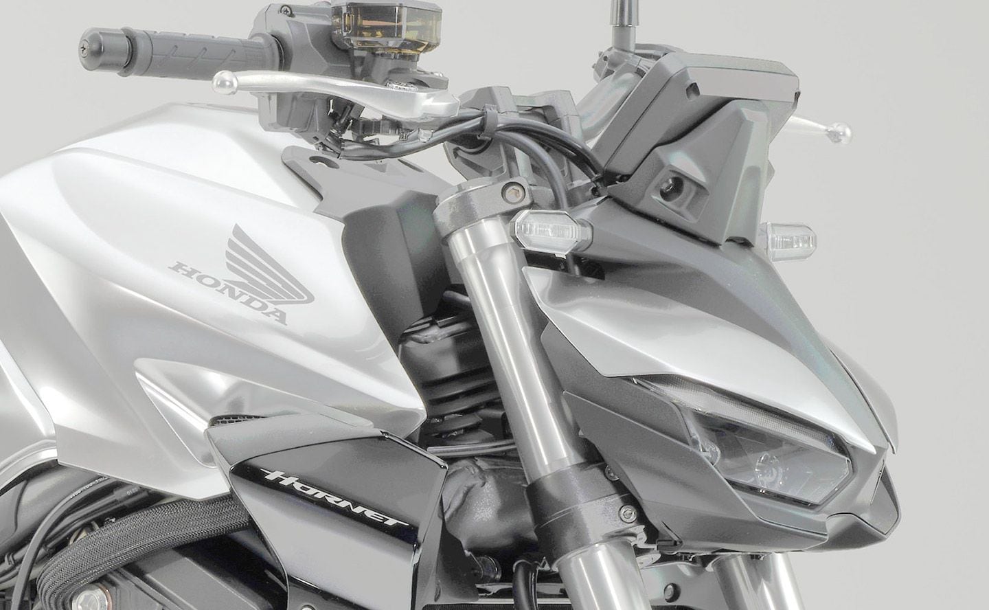

Honda showed its new CB1000 Hornet back at EICMA in Milan last November but has remained tight-lipped about its detailed technical specification because production isn’t expected to start until the second half of 2024.
Now that date is getting closer and more details of the bike are emerging, not least in the form of this patent that illustrates how Honda has incorporated a form of cold-air intake without needing a prominent nose-mounted scoop. Using the bike’s forward motion to push cold air into the airbox helps give the engine a ready supply of denser air to boost performance, but Honda has positioned the intakes farther back, flanking the steering stem and framed by upper and lower frame rails.
Hidden at the front of the tank behind the front cowl are the new cold-air intakes that this patent addresses.

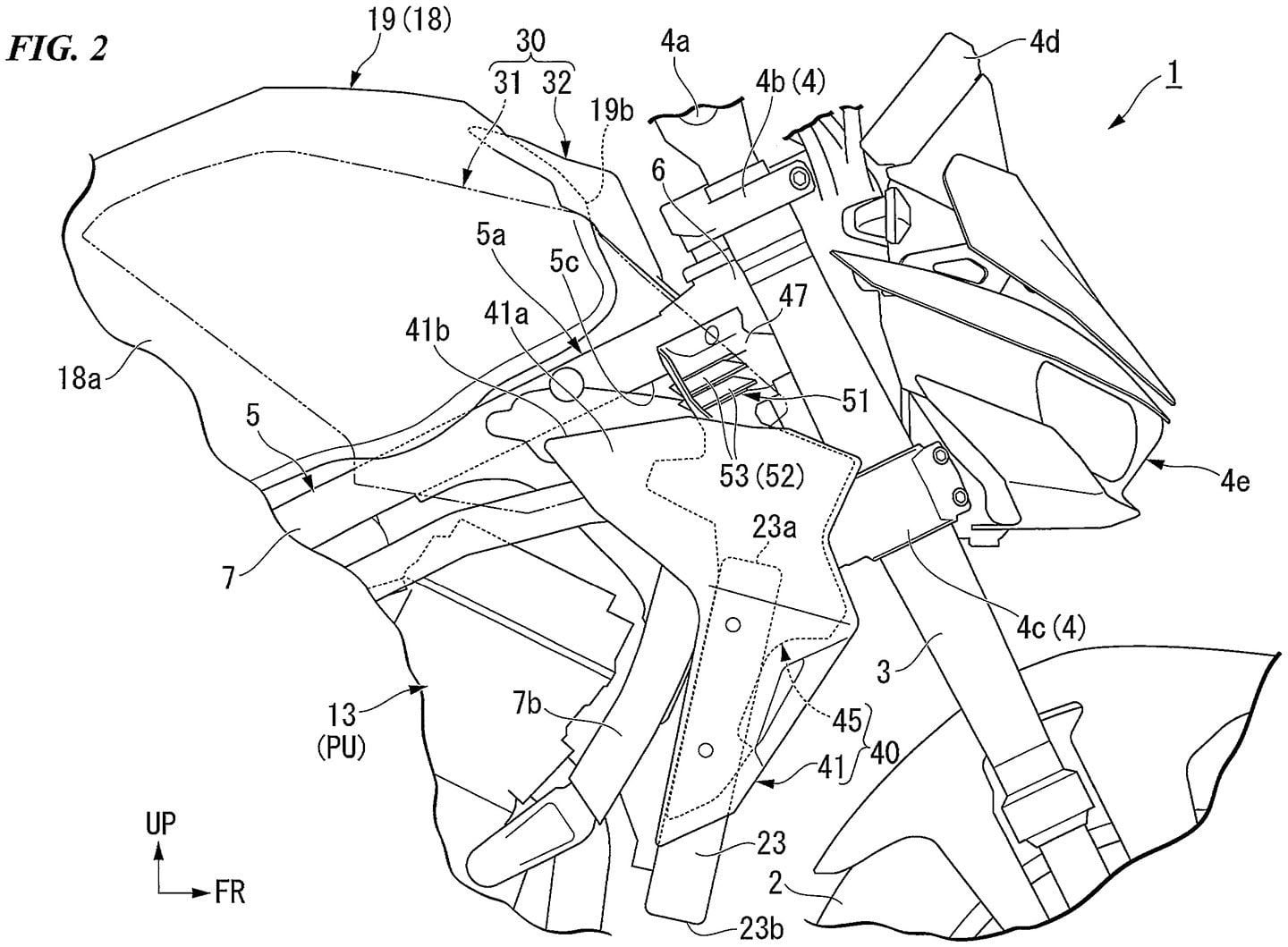

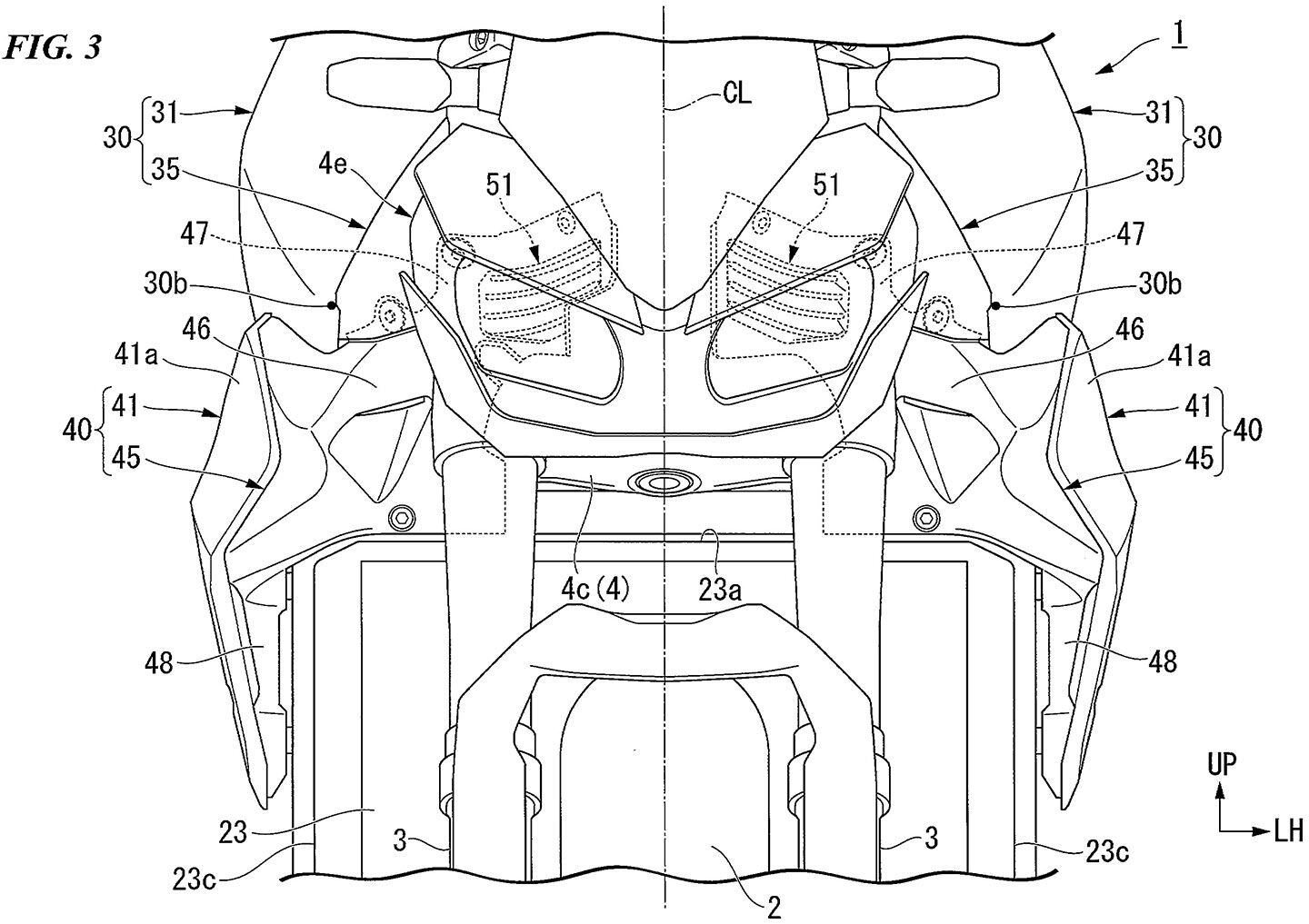

The patent explains that air is encouraged into this area by the side bodywork that thrusts forward on either side of the tank, along with the lower cowls that push air toward the radiator to improve the cooling. As well as improving performance, Honda’s patent says that putting the intakes into this zone also means that the engine’s intake noise is directed toward the rider without being unnecessarily loud. Yamaha has taken a similar path with the latest MT-09, which has ducts that are purpose-made to feed intake sounds up through the top of the fuel tank to the rider.
This patent drawing shows the location of the new intakes (51).
This patent drawing shows the location of the new intakes (51). (Honda/)
It’s actually the louvred covers over the intakes that are key to Honda’s new patent application. While having intakes either side of the front of the frame gives convenient access to the airbox—and air can be channeled toward them by the side bodywork—that part of the frame naturally sits on a slant, matching the bike’s rake. Without the louvred covers over the intakes, they’d face slightly upward, and if the bike was left out in the rain, then water would naturally fall into them. From there, the ducting could take rain into the air filter, which is what Honda wants to prevent. Checking back to the prototype CB1000 Hornet that Honda showed at EICMA, the intakes and louvres can be seen tucked in behind the front cowl.
