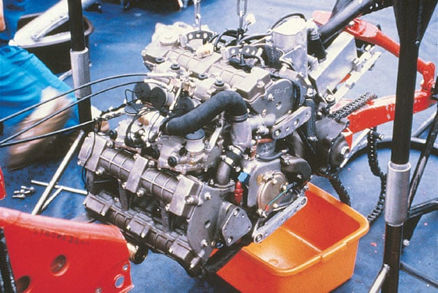

The first step was to test the sealing ability of oval pistons and rings. A simple four-valve test engine, designated Koo, was improvised from an XL250 bottom end. Methods of manufacturing the unusual parts had to be devised. Upon assembly and test in April 1978, this single validated the concept, but making only 10 hp.
This is the 0X oval-piston V-4 that first made 88.7 hp but eventually made 115 hp.
This is the 0X oval-piston V-4 that first made 88.7 hp but eventually made 115 hp. (Honda/)
Next came a dedicated test engine. Koo employed two connecting rods to better distribute acceleration loads into its single wide piston. It would be topped with the planned eight-valve head.
In development they encountered mysterious “missing piston events” when the test engine stopped running and its head was removed, just the two bare con-rods were visible. Where was the piston? In NR testing, cyclic crank twist above 10,000 rpm had caused piston tilting, breaking the piston.
By October—six intensive months later—this engine had been developed to reach 15,000 rpm, making 20 hp. Problems showed up as revs rose: loss of ring seal at 10,000, valve spring failures at 12,000. To each problem were attached engineers and technicians, devising, testing, and building possible solutions—lots of them.

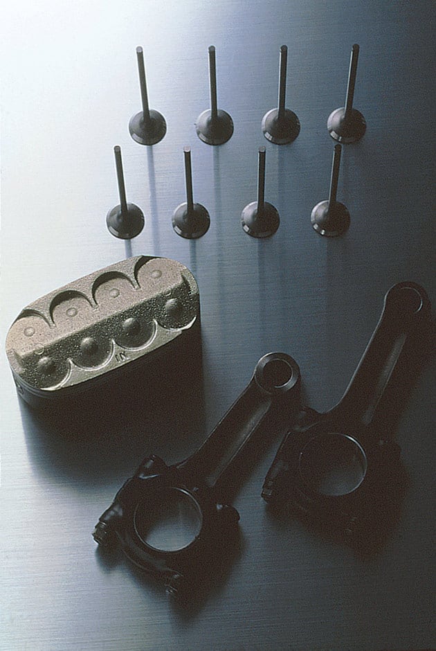

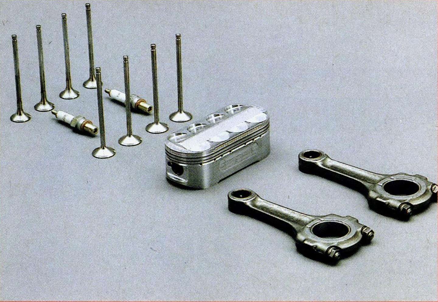

The pressed-together and heavily counterweighted crankshaft and its eight one-piece con-rods turned on needle rollers, just as in so many of Honda’s 1960s GP winners. The front cylinder bank was offset to the left, and the cylinder Vee angle was 100 degrees to provide room for four flat-slide carburetors, each with two 30mm throats. The cam drive was at one end of the crank. Bore and stroke were (93.4 x 41) x 36mm (36mm = 1.417 inches). A round piston of the same area would have a 66.5mm diameter.
Two connecting rods were used on the oval piston to better distribute forces over the wide area of the oval piston.
Two connecting rods were used on the oval piston to better distribute forces over the wide area of the oval piston. (Honda/)
Would magnesium pistons work? Weighing only 60 percent as much as aluminum, they could reduce bearing loads. Nope, they broke up at 17,000 rpm. How about two-piece piston rings, made in the form of J-shaped elements? Kanazawa eventually overcame poor sealing (smoke!) by changing piston shape from flat faces joined by semi-circular ends, to a more-nearly-elliptical section with continuous curvature. It is the flat-faced type that can be seen in Honda’s museum at Motegi.
You can see the curved piston face on the production NR750’s pistons instead of the flat front originally found on the early NR500 test units.
You can see the curved piston face on the production NR750’s pistons instead of the flat front originally found on the early NR500 test units. (Honda/)

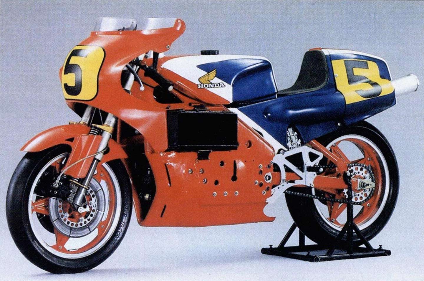

Meanwhile, the bike to carry this engine was equally heavy with innovation, having a thin aluminum monocoque chassis, an “upside-down” Showa fork, carbon brakes, and side-mounted radiators. Many production bikes today share technologies originally developed for NR500.

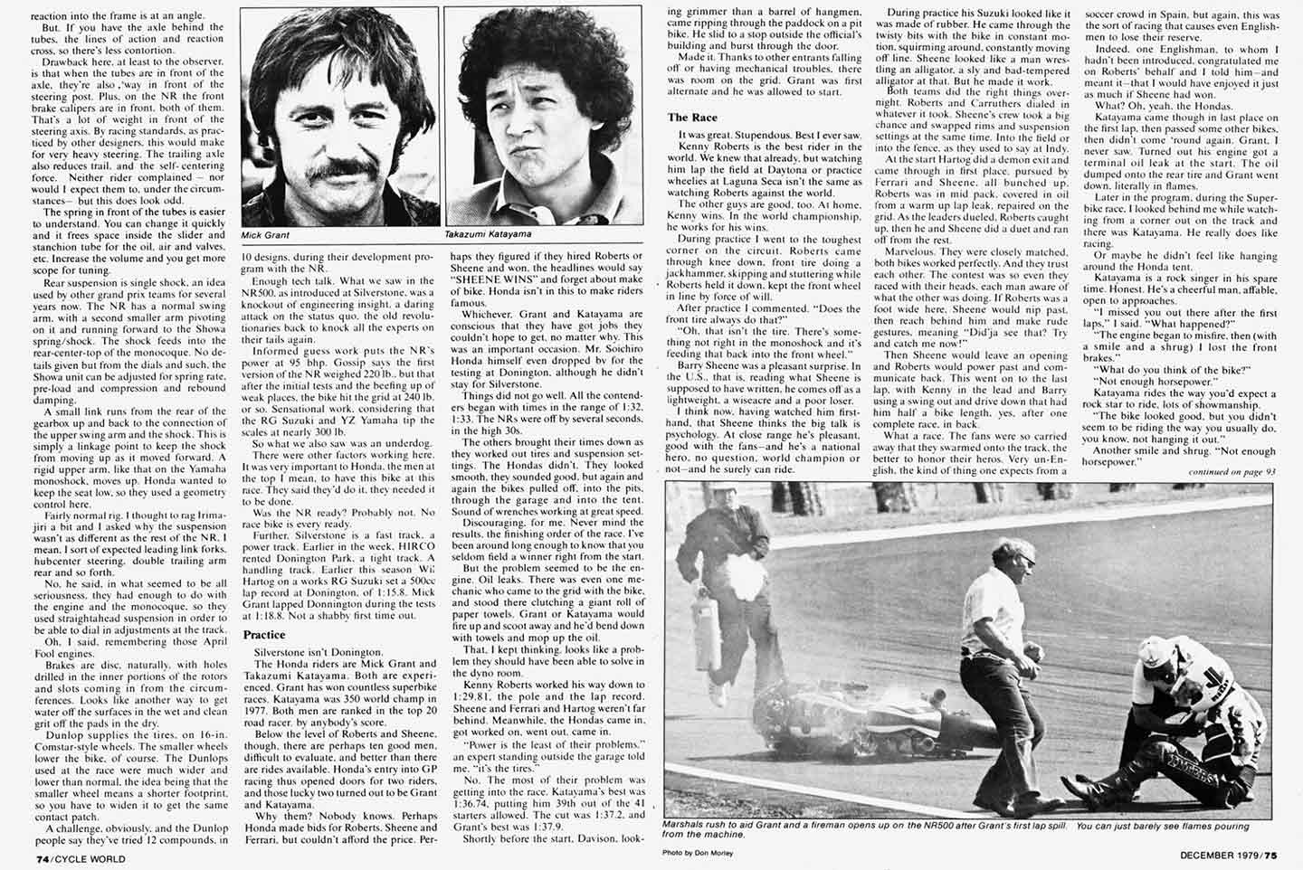

<i>Cycle World</i> Editor Allan Girdler reported on Mick Grant’s and Takazumi Katayama's less than impressive debut on the NR500.
<i>Cycle World</i> Editor Allan Girdler reported on Mick Grant’s and Takazumi Katayama's less than impressive debut on the NR500. (Cycle World/)
Grant later revealed, “They didn’t want me and Katayama coming last and second-to-last so they told us they only put in enough fuel for a few laps, and to put on a show, then stop.”

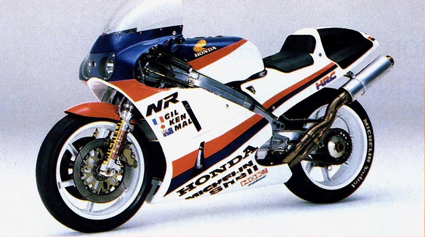

NR work continued—the 2X version reached 125 ps in 1982, and 1983′s 3X variant reached the original goal of 130 ps at more or less 19,000 rpm. Two basic roadblocks remained: Two-stroke power was now rising steeply, and second, the NR was still 60 pounds heavier than its competition. Two-stroke power growth was coming from subtle changes to cylinder ports and exhaust pipe shape, while four-strokes had to raise rpm to boost power—an expensive process.
Honda’s urgent weight reduction program was partly successful, yet the 40 extra pounds of the NR’s machinery-packed cylinder heads remained. Jorg Moller, designer of Franco Morbidelli’s title-winning 125s, said at the time, “Ideas remain important in the design of two-strokes. But for four-strokes, it is only money.”

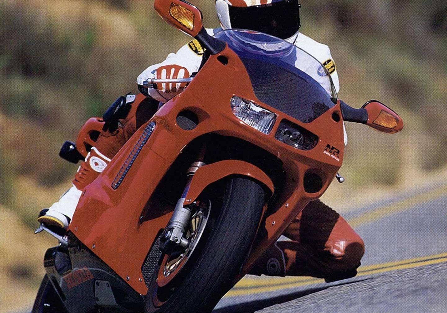

Just 300 street-legal production 1994 NR750 units were built.
Just 300 street-legal production 1994 NR750 units were built. (Brian Blades/)
Oval pistons were banned from Formula 1 use, but Honda did produce some 300 examples of an NR750 production bike. Like so many limited-production exotics, they were gobbled up by collectors and now repose in temperature- and humidity-controlled rooms.

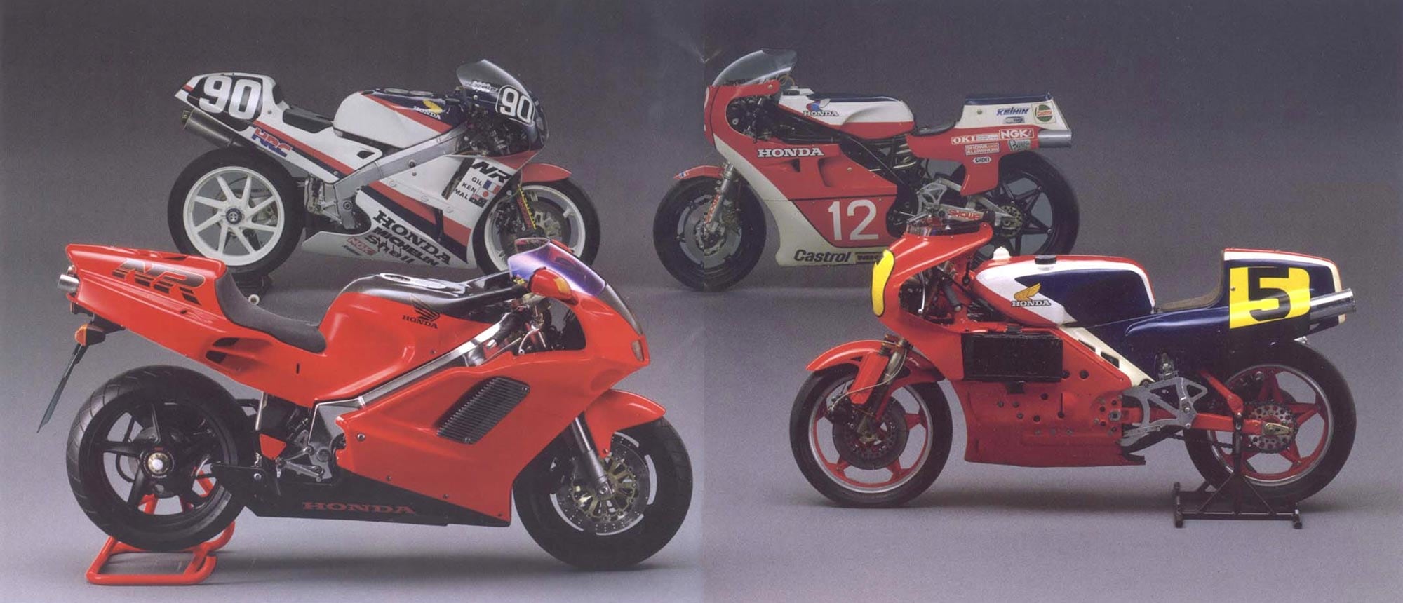

From the NR500 (right front) came the 1981 Suzuka 200-Kilometer winning NR500 (2X) ridden by Kengo Kiyama (right rear), the NR750 Endurance Racer (left rear), and the 1994 NR750 production model (left front).
From the NR500 (right front) came the 1981 Suzuka 200-Kilometer winning NR500 (2X) ridden by Kengo Kiyama (right rear), the NR750 Endurance Racer (left rear), and the 1994 NR750 production model (left front). (Honda/)
