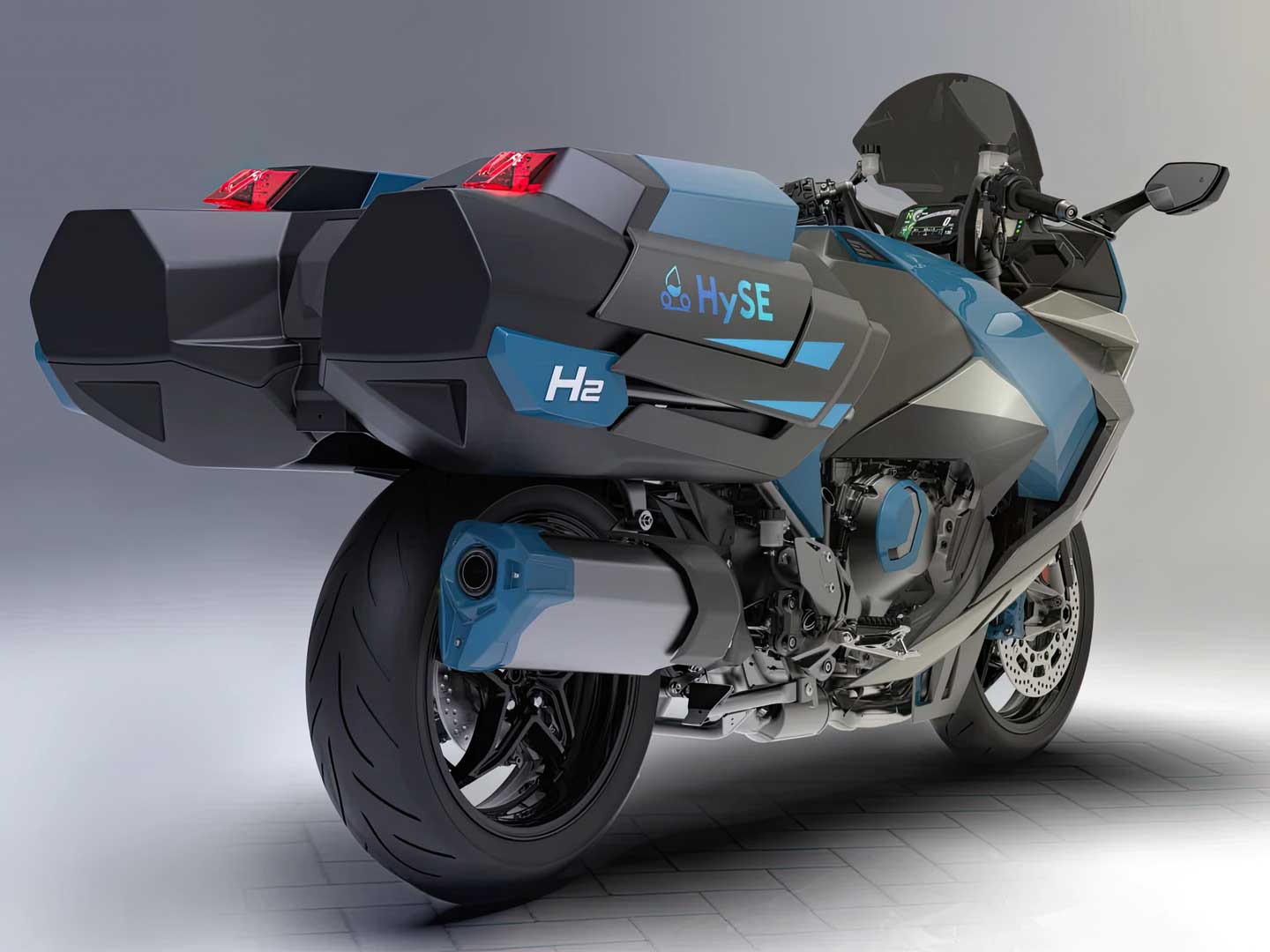

NASA engineers used to say, “Hydrogen is huge.” If we compress the hydrogen that we’ve electrolyzed from water to 10,000 psi, it takes six times the volume of the pressurized gas to equal the energy in one volume of gasoline or other liquid hydrocarbon fuel. That means to functionally replace 4 gallons of gasoline with hydrogen at 10,000 psi, we must carry 24 gallons of hydrogen. That is why images of hydrogen-powered bikes of the future look like tourers with what appear to be side bags and top trunk but are actually packed with long slender pressure tanks.

Tanks for storing hydrogen need to hold six times the volume to be equal to gasoline.
Tanks for storing hydrogen need to hold six times the volume to be equal to gasoline. (Kawasaki/)
When I Googled the weights of such pressure tanks I found that volume-for-volume they weigh about nine times what gasoline tanks weigh.

Kawasaki has demonstrated its hydrogen-powered sport-tourer recently.
Kawasaki has demonstrated its hydrogen-powered sport-tourer recently. (Kawasaki/)
