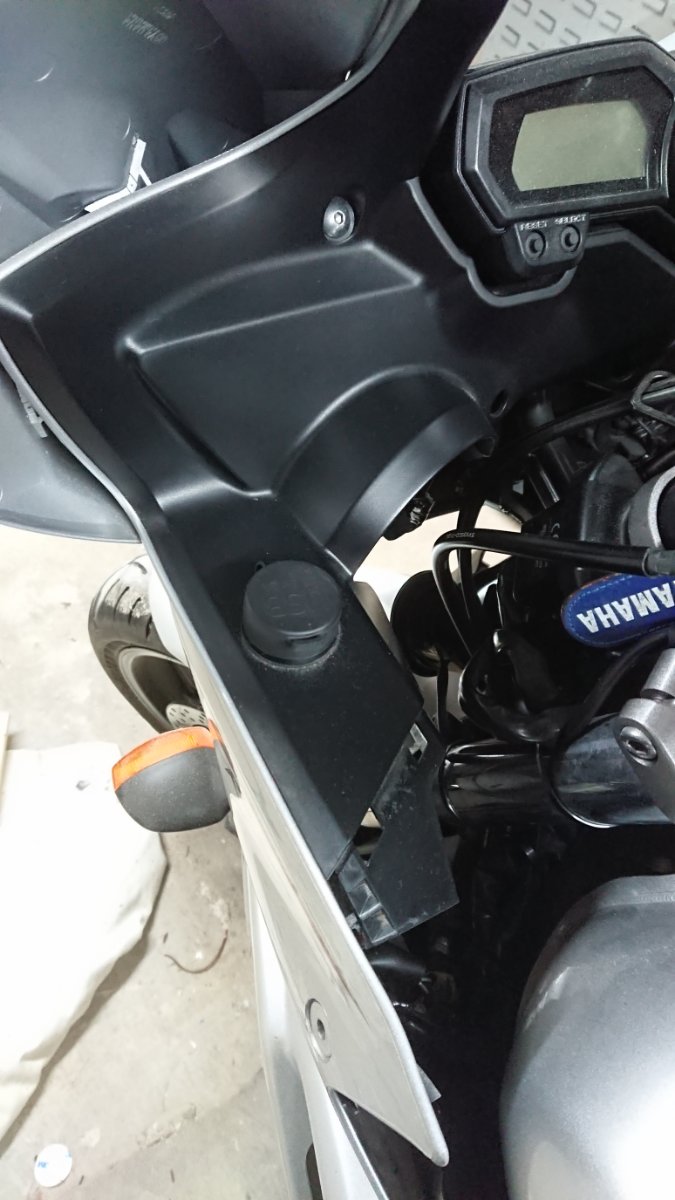

Took a few more pics of the installation may be of use to a blind man, fairly straight forward.

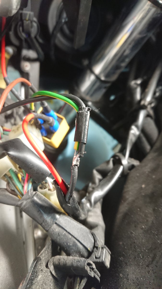

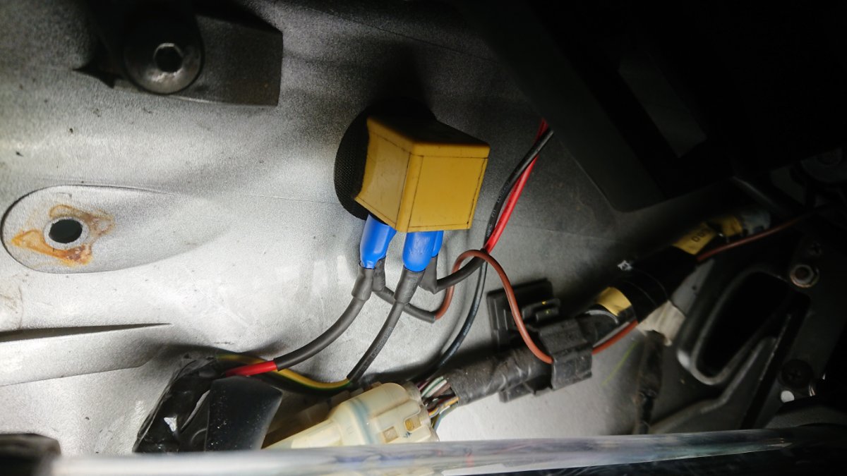

Had some left-over Velcro from sena so tucked it up under plastic, should be right out the way of any water, didn't want to cut loom wires to use heat shrink so soldered and then very sticker tape.

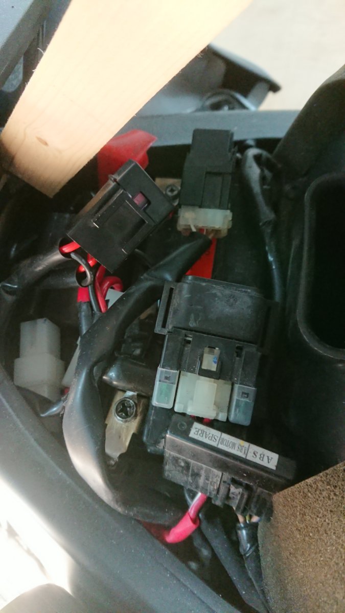

Fuse lives near battery, negative for relay taken from negative to usb.

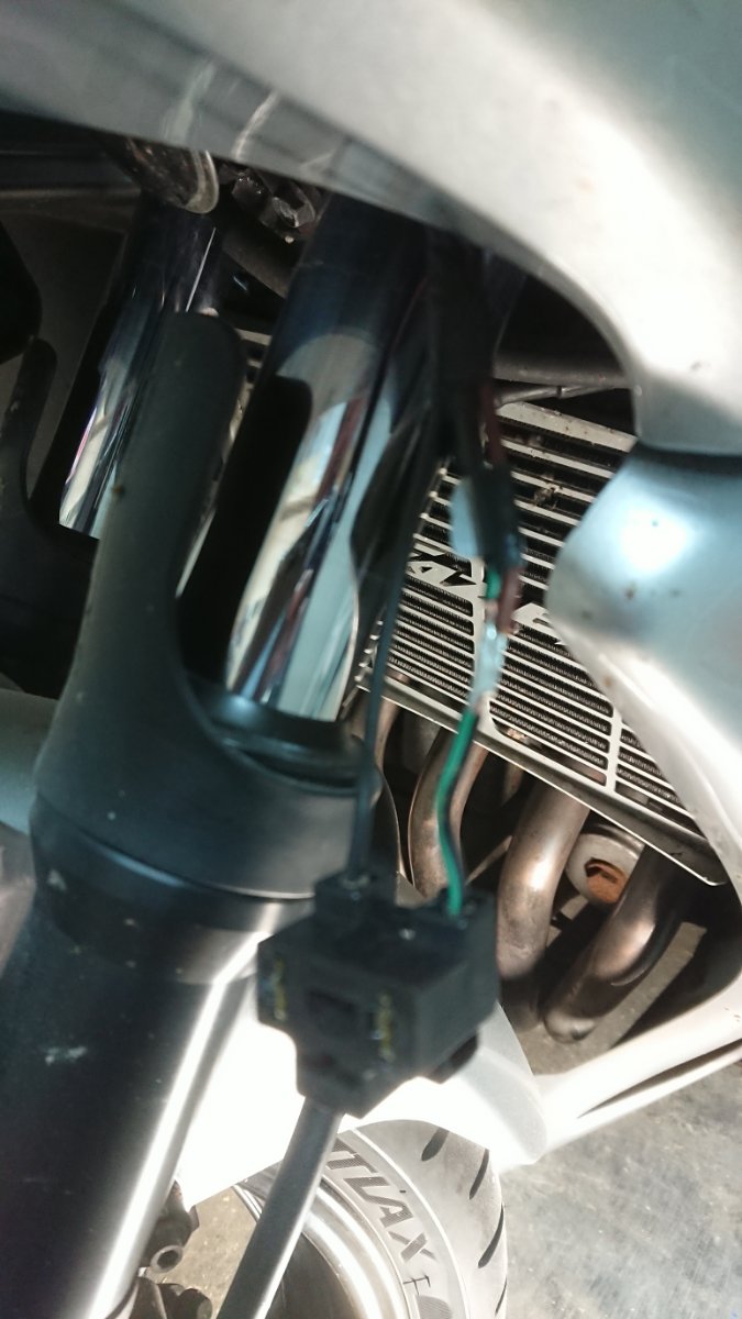

Switched live for relay taken from dipped beam, one of the reasons I put it where it is.

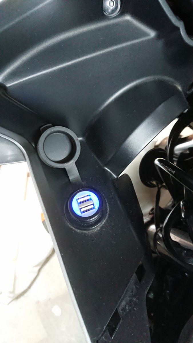

Just need to reposition it slightly to straighten cable out.
