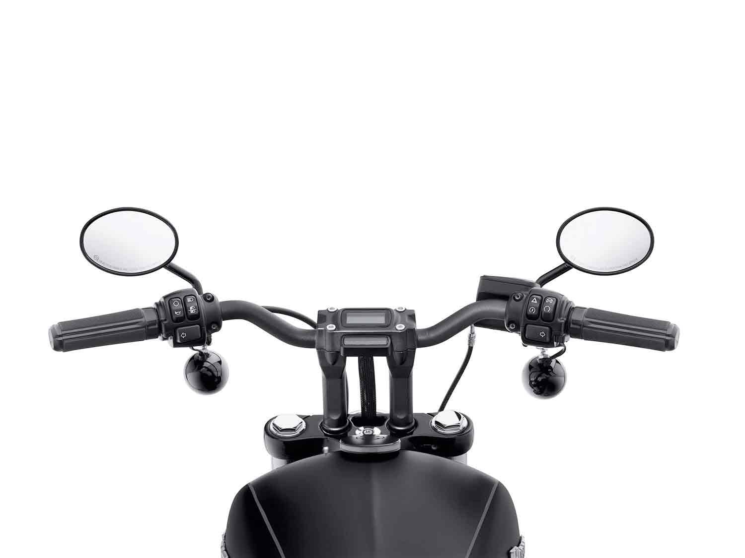

The 1-inch Moto Bar (mounted on 5.5-inch risers) is straighter and lower than the stock mini-apes, effectively dropping shoulders and lessening fatigue at speed, especially on long distances.
The 1-inch Moto Bar (mounted on 5.5-inch risers) is straighter and lower than the stock mini-apes, effectively dropping shoulders and lessening fatigue at speed, especially on long distances. (Harley-Davidson/)

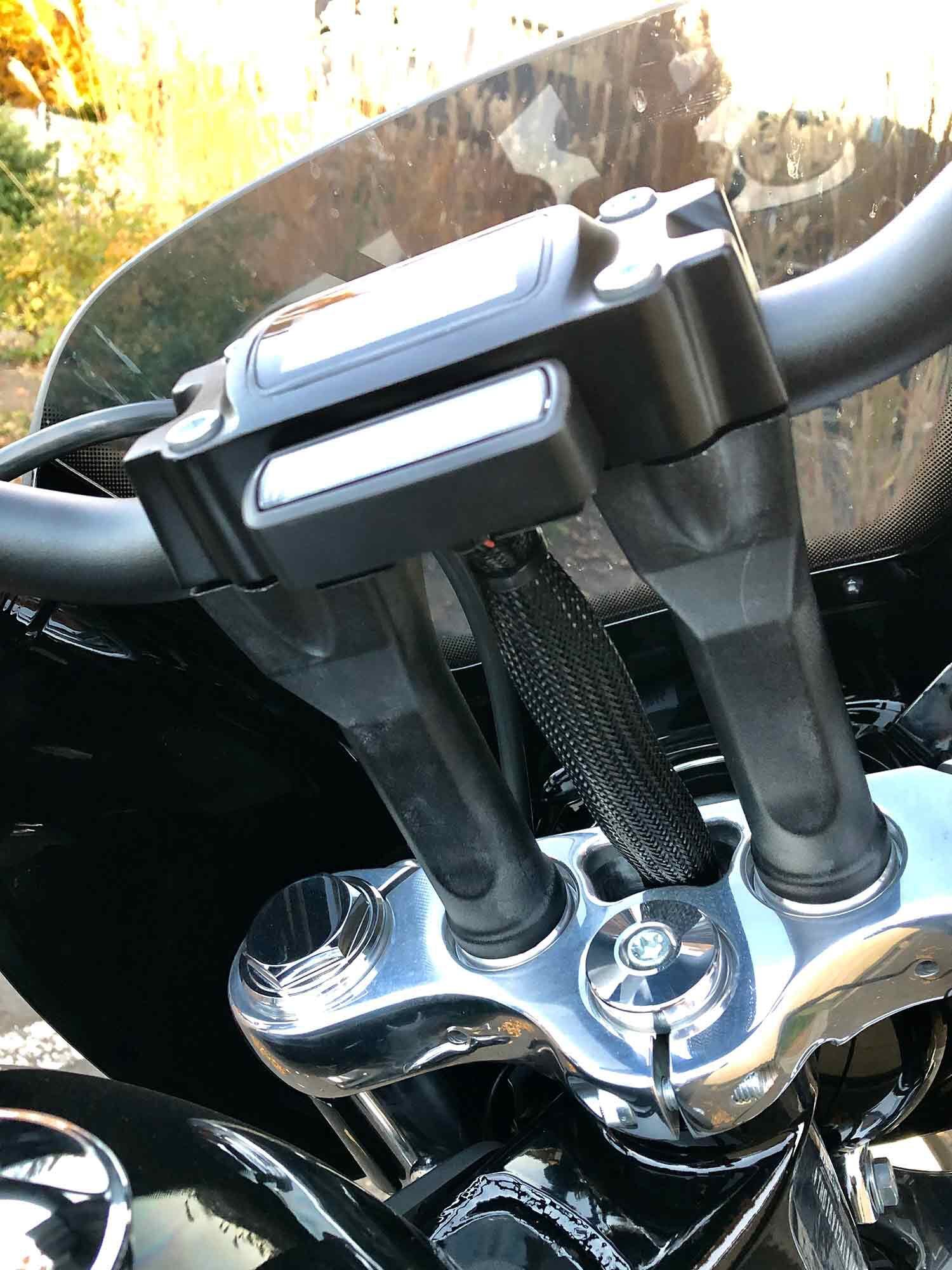

First up was the handlebar swap, which consisted of Harley’s Moto Handlebar combined with a Tall Riser kit (of course H-D makes you get a separate, bike-specific top clamp for the gauge. And it’s not cheap). The 1-inch Moto Bar sits atop the 5.5-inch-tall risers, putting it significantly lower than the stock mini-apes for a dramatic change in the riding position. I found my torso canted slightly forward rather than back and upright as with the apes, with shoulders dropped and my arms now punching a bit down rather than skyward. It was a more natural and comfortable setup for my stubby limbs, and the straightish bar had enough pullback for an easy (if somewhat extended) reach.

Keep in mind the Standard’s factory handlebar is internally wired; the accessory Tall Risers also require a separate top clamp for the gauge.
Keep in mind the Standard’s factory handlebar is internally wired; the accessory Tall Risers also require a separate top clamp for the gauge. (Andrew Cherney/)
A couple of longer trips confirmed the new bar setup was a solid improvement, giving me a better grip as well as more feedback from the bars. There’s a solidity to the bar/riser combo with fewer vibes, and you feel more connected to the bike, though I felt I lost some of the low-speed maneuverability the ape bars afforded. It was still a reasonable trade-off for the added comfort at speed. Not counting the additional clamp and cables, the bar and riser add $130 and $170 (respectively) to our running total.

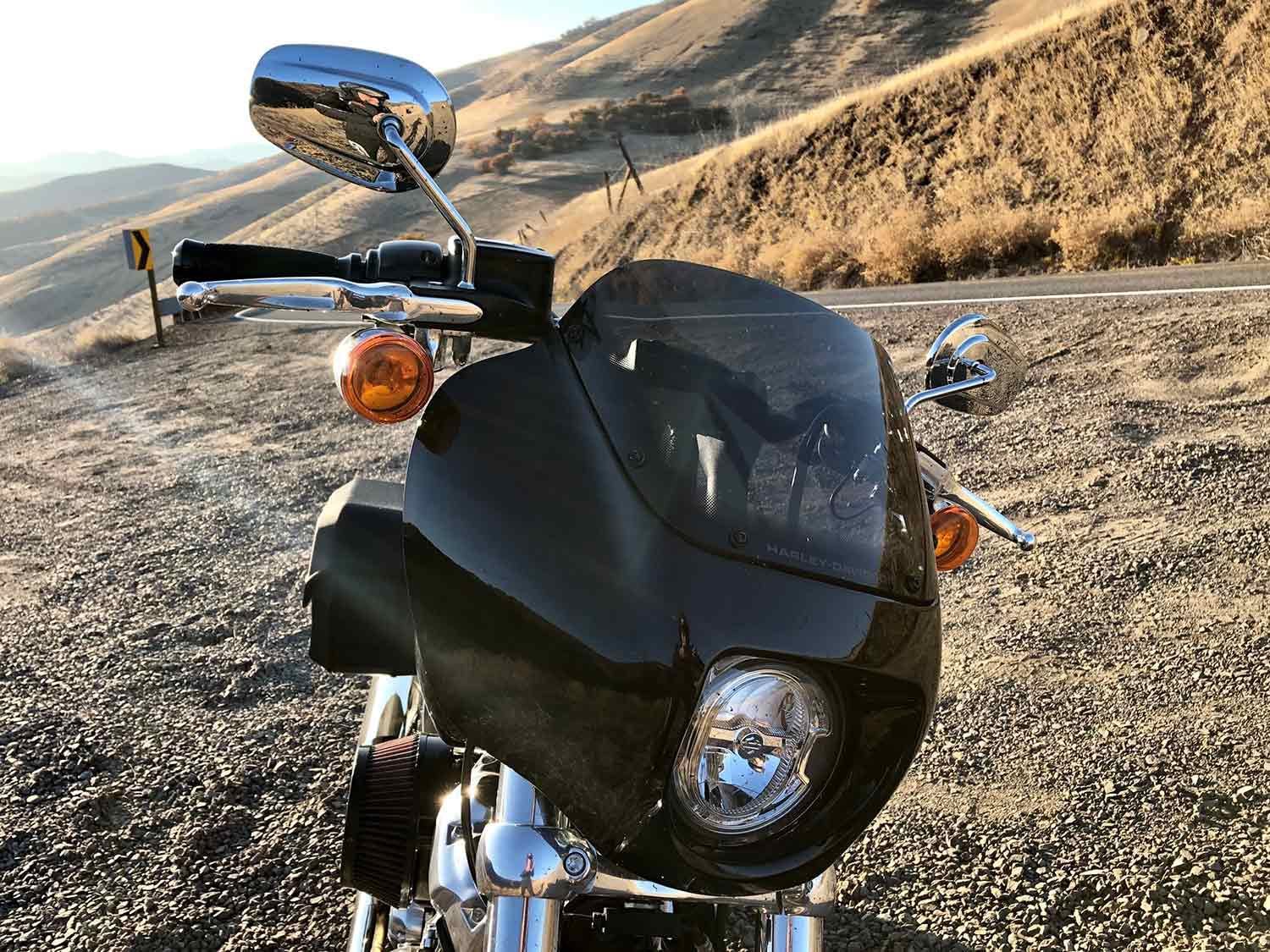

The Softail Quarter fairing gives the Standard a more finished custom look and adds wind protection.
The Softail Quarter fairing gives the Standard a more finished custom look and adds wind protection. (Harley-Davidson/)
Next up was the new Softail Quarter Fairing (which of course requires a separate mounting kit) to give me at least some wind protection on long hauls. The fairing instantly gives the Standard a finished look with a more fluid silhouette for an instant aesthetic upgrade to the stocker’s ho-hum vibe. A smoked windscreen occupies the top of the fairing and, though it sits fairly low, offers enough of a break to keep the wind off my chest. The whole unit is small enough to not be visually intrusive, and big enough to give you welcome coverage from wind blasts (it’s more noticeable at higher speeds). For better coverage on big-mileage trips, I would probably add a Laminar Lip to redirect more air. Combined with the bars, the fairing was just the ticket for high-speed hauling making for a marked difference on longer rides, even more so if I tucked down behind the shield’s bubble.
Top portion of the new fairing consists of a short, smoke-tinted shield.
Top portion of the new fairing consists of a short, smoke-tinted shield. (Andrew Cherney/)
The fairing and Moto Bar/Tall Risers are parts of H-D’s Coastal Package, but I skipped that kit’s BMX pegs and two-up seat; the serrated pegs would do me no favors if I wanted to extend my legs out on the road. MSRP for the fairing is $355 and $100 for the mounting kit.

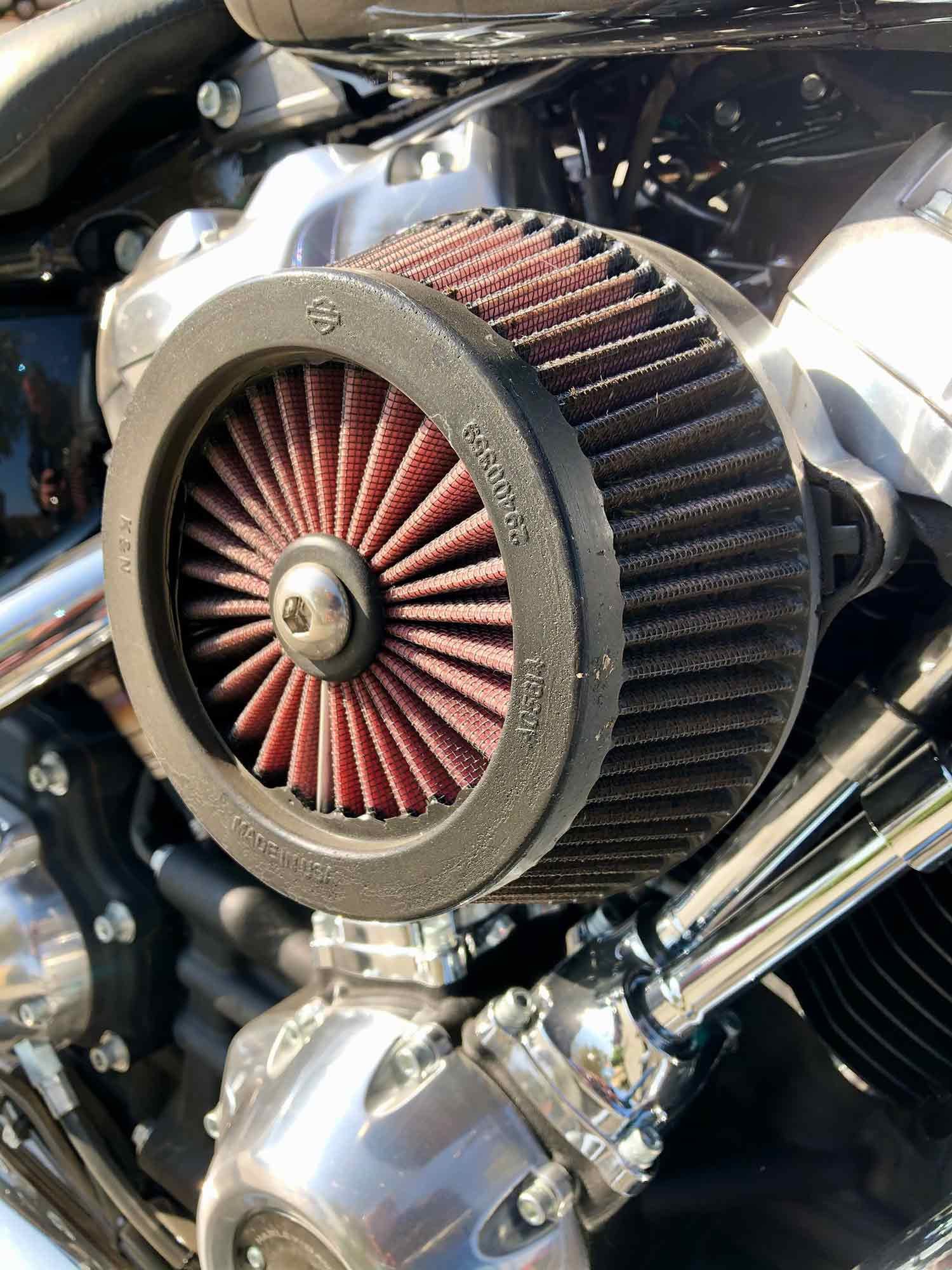

The Brawler one-piece seat is longer and narrower but not necessarily lower than the stocker. It is more comfortable. (Andrew Cherney/)Screamin’ Eagle Extreme Flow Cleaner improves the look of the engine bay while flowing substantially more air.
Screamin’ Eagle Extreme Flow Cleaner improves the look of the engine bay while flowing substantially more air. (Andrew Cherney/)
We also wanted to perk up the Milwaukee-Eight 107 a bit so we went for a basic Stage 1 upgrade, swapping in a higher-flow air filter and less restrictive exhaust system (with an ECM calibration at the dealer) for freer breathing. The power increase was slight, but if nothing else, the upgrade was simple and nonintrusive.

Helping matters was the fact that the open-face Screamin’ Eagle Extreme Flow Air Cleaner not only flows more air than a traditional high-flow filter, but it tidied up the dull look of the stock engine bay, plus the M-8′s intake sound is a bit beefier. We fitted a set of Screamin’ Eagle Street Cannon Mufflers to handle the exhales and to richen up the exhaust note, and added Goldilocks-level tone; not too loud, not too quiet, and just enough low-frequency bark. The air filter set us back $205, while the Street Cannons rang in at $550 (plus $110 for the Satin End Caps) giving us a running subtotal of $1,870.
