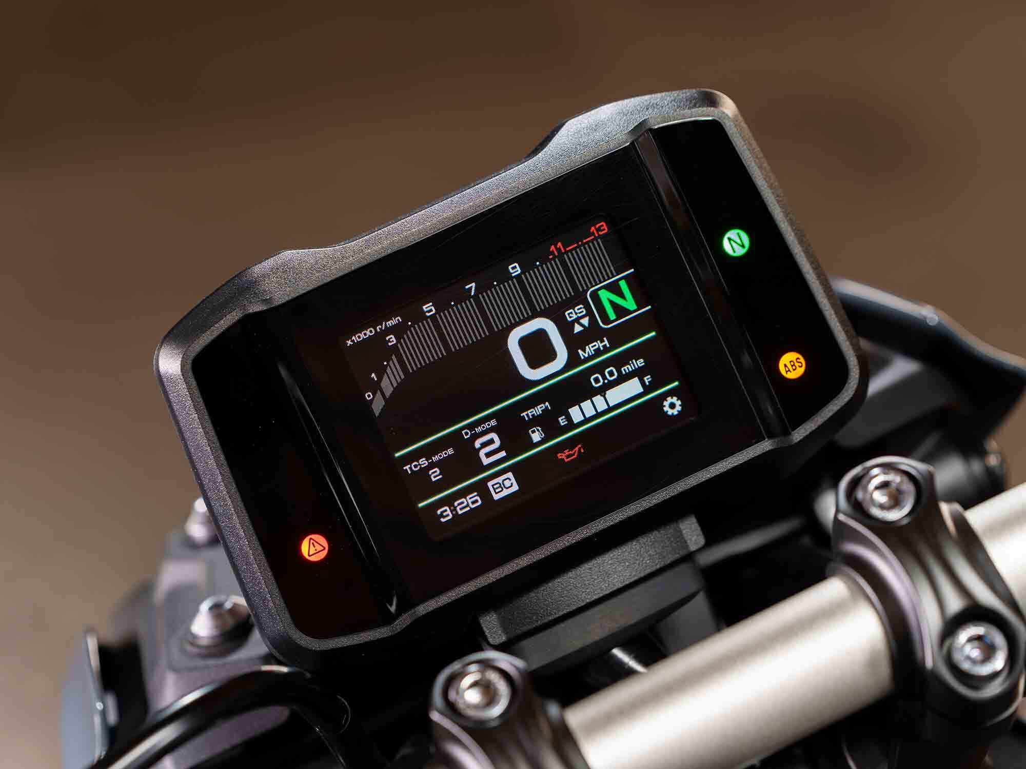

The new suite of electronic rider aids and rider modes is controlled via a handlebar switch and the full-color TFT dash.
The new suite of electronic rider aids and rider modes is controlled via a handlebar switch and the full-color TFT dash. (Yamaha/)
Along with chassis and engine changes, the new 09 gains an impressive array of new electronic riding aids that Yamaha says were directly derived from those of the R1 superbike. A new six-axis IMU (Inertial Measurement Unit) tracks exactly what the bike is doing in 3-D space, allowing very sophisticated traction control, lift control (anti-wheelie), and slide control systems to be implemented by the 09′s ECU. This is helped by a new electronic ride-by-wire throttle system that allows the control system to work at multiple levels: spark, fuel, and throttle, depending on the exact need. A new full-color TFT display and dedicated handlebar buttons allow the rider to select from four different throttle maps and three different levels of each of the other control systems, with the additional option of disabling any one or all of them altogether. The IMU also feeds data to the ABS system, allowing it to be mapped to respond appropriately to rider lean. Before starting a ride, you can select either this mapping or a conventional ABS map that ignores the IMU; but unlike the other rider aids, you can’t switch the ABS off. Yamaha also included a quick-shifting system with a shift sensor that allows clutchless up- or downshifts, and allows the rider to turn the system off if desired.

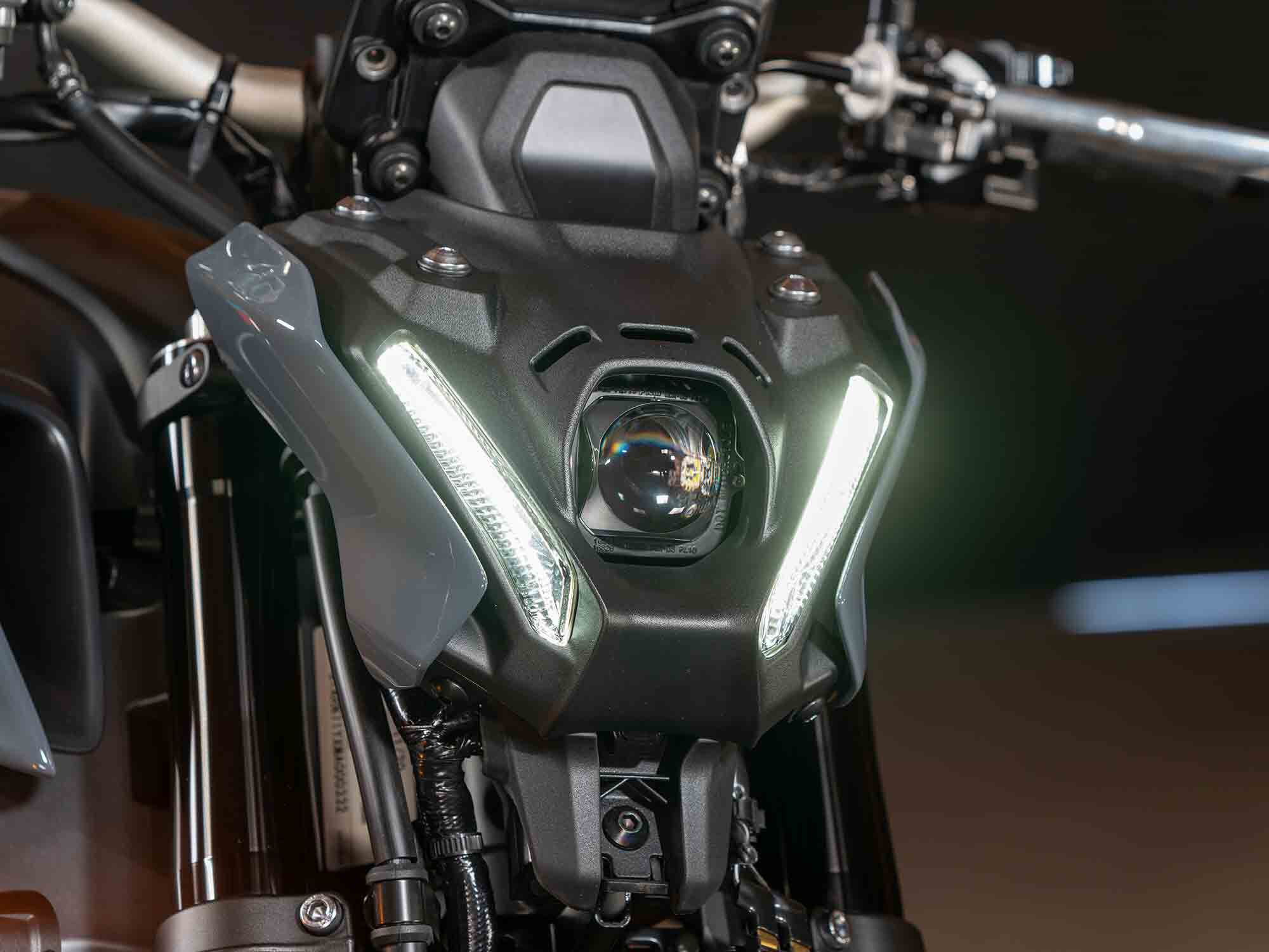

The MT-09′s headlight is a bold design to say the least, but the LED and dual-lens-in-series headlight is effective.
The MT-09′s headlight is a bold design to say the least, but the LED and dual-lens-in-series headlight is effective. (Yamaha/)
Probably the most controversial feature of the new bike is the new and extremely compact dual-beam LED headlight, which allows everything carried on the fork to be pulled back closer to the bike. Whether you like the looks or not, you’ll likely appreciate the bright and well-defined light pattern provided by multiple LEDs and a dual-lens-in-series projector design.
