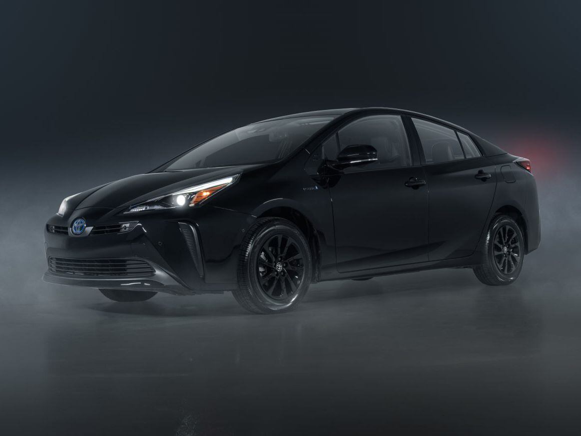

A hybrid’s gasoline engine gives it long range and easy fill-ups, while its electric powertrain takes over at low speeds and in stop-and-go traffic for better fuel efficiency. But does this work for motorcycles?
A hybrid’s gasoline engine gives it long range and easy fill-ups, while its electric powertrain takes over at low speeds and in stop-and-go traffic for better fuel efficiency. But does this work for motorcycles? (Toyota/)
There are still a good many people who refer to a Toyota Prius as an electric car, yet it most certainly is not: a Prius is a gasoline/electric hybrid, which runs on its internal combustion gasoline engine in those parts of its performance envelope where it is advantageous, and on a small (150-pound) battery and electric motor in conditions where they are more efficient.
Why not just run on the battery all the time? Because the market purpose of Prius was mileage improvement rather than perfection. It avoided the pure electric’s limited range by being able to cruise nearly 600 miles on its gasoline engine. When the Prius first came to market in 2000, coal was still generating 50 percent of US electricity, and was generating 48.2 percent of it in 2008. Today, though, coal has declined to generating 19 percent of our electrical power, while natural gas has risen from 15 percent to 40 percent of US electricity production in 2020.
