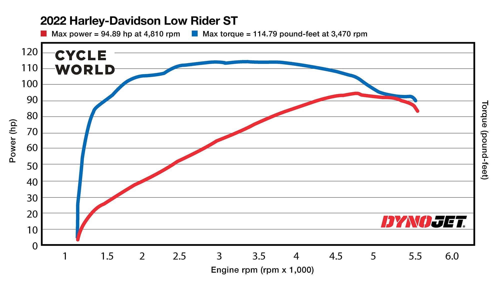

Horsepower and torque figures of the 2022 Harley-Davidson Low Rider ST.
Horsepower and torque figures of the 2022 Harley-Davidson Low Rider ST. (Robert Martin Jr./)
As part of Cycle World’s regimented testing protocol, we ran the 2022 Harley-Davidson Low Rider ST on our in-house Dynojet 250i dynamometer, recording horsepower and torque figures ahead of an upcoming first ride review. The ST produced a peak 94.89 hp at 4,810 rpm and 114.79 pound-feet of torque at 3,470 rpm, which is right in line with the measured performance of the M-8 117-powered Low Rider S we last had on the dyno.
