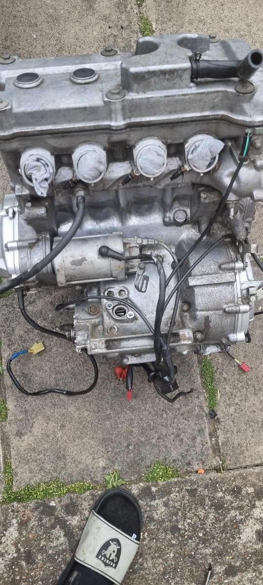

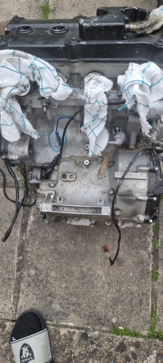

Adrian Posted May 26, 2022 Posted May 26, 2022 The first engine its from 1991 and second 1996 But second engine have a hole, I don't know what is that If anyone can help me please Quote
Mississippi Bullfrog Posted May 26, 2022 Posted May 26, 2022 Looks like it's where the speedometer sensor sits. Quote
Fozzie Posted May 26, 2022 Posted May 26, 2022 It is the speedometer sensor, the older F2 uses a drive on the front wheel. The engines aren't really interchangeable without transplanting an entire F3 loom over. Quote
