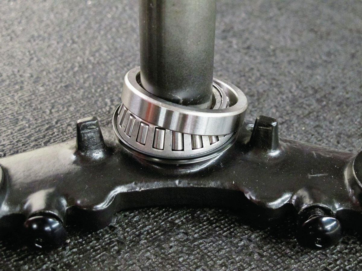

There are two steering-head bearings, upper and lower. Typically, each consists of an upper and lower grooved race with roughly 20 hard steel balls distributed around the grooves between them. In some steering heads, heavy-duty taper rollers are used instead of balls and races.
Heavy-duty tapered bearings are most commonly used on modern motorcycles.
Heavy-duty tapered bearings are most commonly used on modern motorcycles. (Motorcyclist/)
New bearing races and balls are the only remedy for dented races. Replacement is a job for an experienced and mechanically competent person. The basic mechanics are to place the bike on a stand with the front end supported in the air, then remove the top fork crown, unload the head bearings by unscrewing the threaded steering-head preload adjusting nut near the top of the steering stem, and removing the rest of the fork. The races in the steering head can be removed, by careful use of a drift pin and hammer, and replaced with new. This was a familiar task for older motorcyclists, who well remember sticking the new bearing balls to the upward-facing ball races with grease, then ever-so-carefully reinserting the steering stem into the steering head, installing the top race, and securing all in place with the preload adjusting nut.
