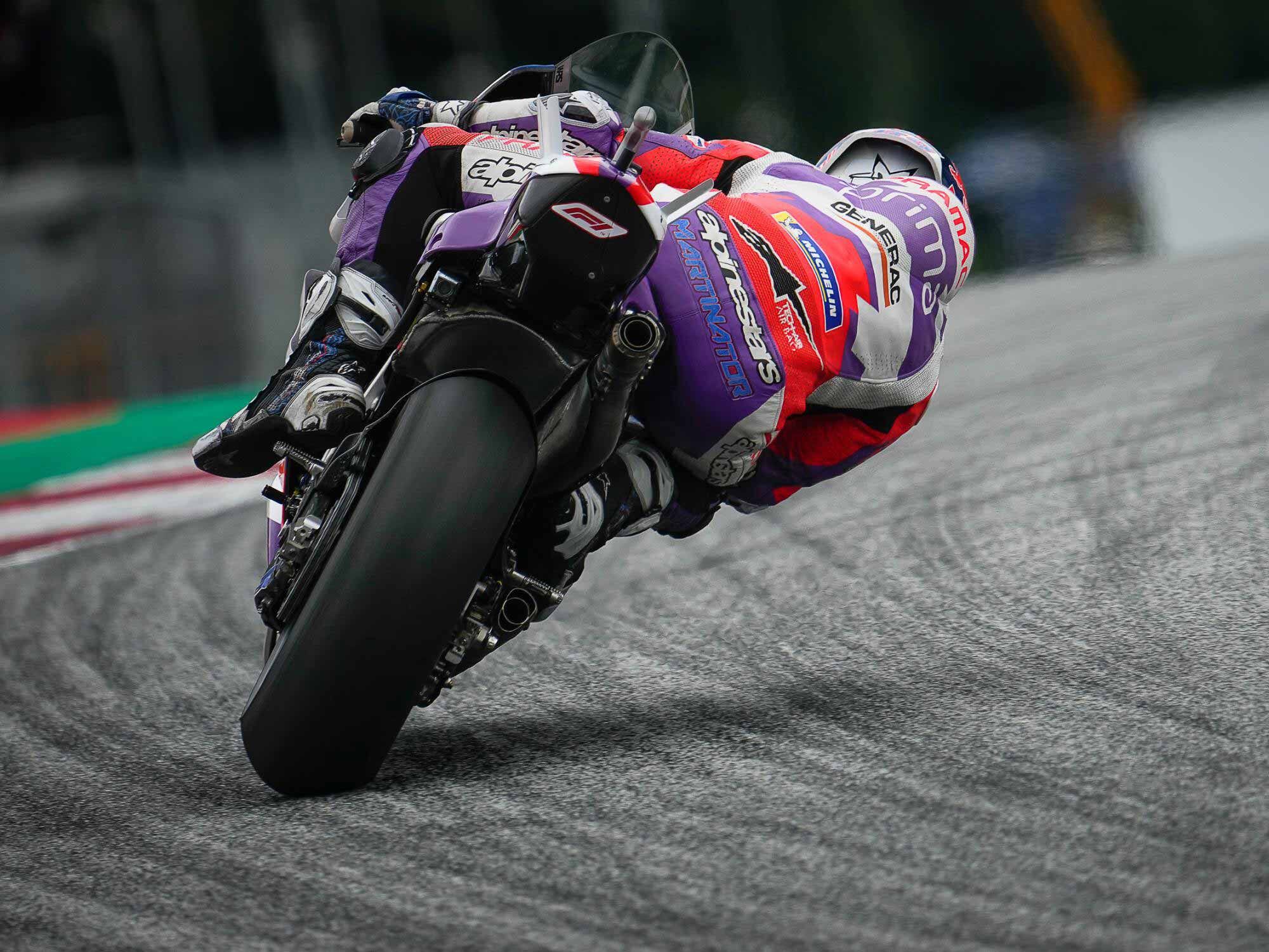

On those occasions when Dorna video coverage has presented a MotoGP rider’s lean angle, we have seen incredible values, as much as 63 degrees from the vertical, implying that the tires are laterally generating twice the acceleration of gravity to turn the bike. Watch films from earlier times and you’ll see nothing like this.
Indeed today’s actual MotoGP lateral acceleration may be greater than this, suggesting that the actual lean angle of the machine/rider combination may surpass the lean angle of the bike alone—because the rider is so offset to the inside.
When riders shift their weight to the inside during turning, they are doing all they can to push the bike toward upright. There are two reasons they do this.
Tire flex is greater on the edges than in the center.
Tire flex is greater on the edges than in the center. (MotoGP/)
The first is to preserve the vulnerable tire edges. These are less supported by the air-filled carcass and therefore flex more than the rest of the tire, making them more likely to lose grip from excess temperature.
Second, although manufacturers narrowed engines and mounted them higher, both measures aimed at increasing cornering clearance, grounding remains possible.

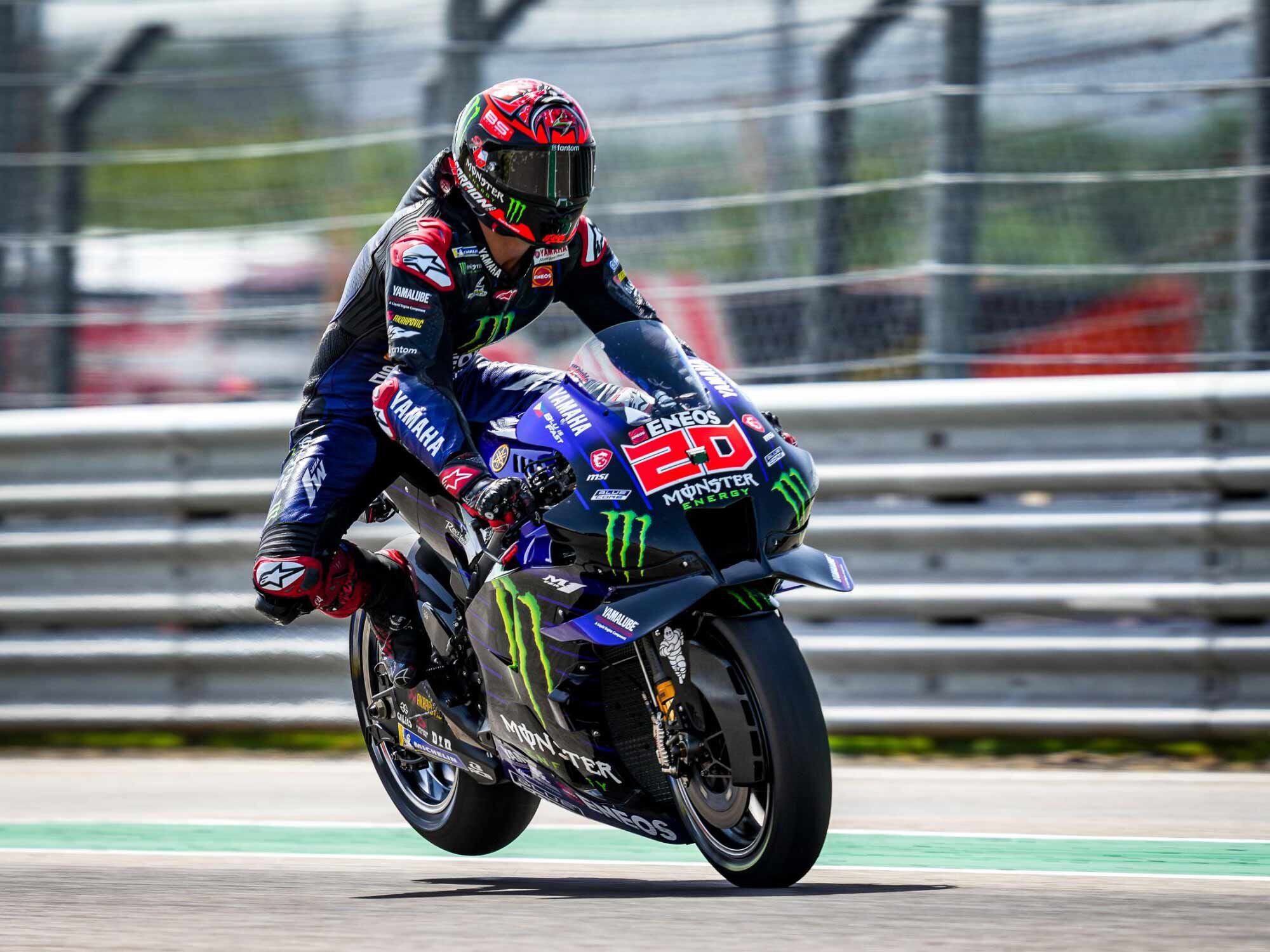

Now consider braking. The front brake on Barry Sheene’s championship-winning 1976 Suzuki two-stroke was a pair of 290mm steel discs, capable of reliable operation up to 500–550 degrees Celsius. His front rim was 2.5 inches wide. In MotoGP today Brembo offers discs in three diameters and a variety of weights (because more heat must be stored on certain tracks). Those diameters are 320, 340, and (for tracks like Motegi or Phillip Island) 355mm. Their carbon-carbon material operates reliably up to 800 degrees Celsius and exceptionally to 1,000 Celsius. Front rim widths are 3.5 or 4.0 inches.
The tires Sheene used were capable of handling the braking force from his Suzuki’s modest-sized discs over a speed range topping at about 180 mph. Today’s much more capable fronts must handle braking from speeds up to 220 mph. Since kinetic energy varies as the square of speed, the brakes on today’s 357-pound MotoGP bike must deal with 49 percent more energy from its higher top speed and maybe 13 percent more energy as a result of the increased all-up weight.

The forces applied to MotoGP tires are far beyond what modern production street tires are expected and capable of handling.
The forces applied to MotoGP tires are far beyond what modern production street tires are expected and capable of handling. (MotoGP/)
Now for acceleration. At 114 hp, Sheene’s Suzuki was making 37 percent more power than the 1,000cc production four-strokes of its time. Moreover, four years earlier at Daytona, the new 750 two-strokes from Suzuki and Kawasaki had destroyed every tire that was tried on them through practice—and destroyed them so dramatically that Don Emde won the 1972 200-mile event on a little 350 two-stroke Yamaha twin running on traditional all-weather (patterned tread) racing tires.
Engine output has more than doubled since then, with present-day MotoGP engines likely giving about 280 hp.
Such performance is out of reach of wide-range production tires—especially those designed decades ago and made in narrow sizes! Therefore I must interpret Mr. Rue’s Avon Speedmaster proposal as either tongue-in-cheek, which I appreciate, or as a variant of the suggestions sometimes made seriously: that current MotoGP spec-tire supplier Michelin be asked to reduce performance. It should supply, for example, tires that skid off turns at 1 G rather than 2, or tires that turn to grease, blister, or chunk when called upon to transmit 2.6 times more power than that of a 1972 Suzuki.
