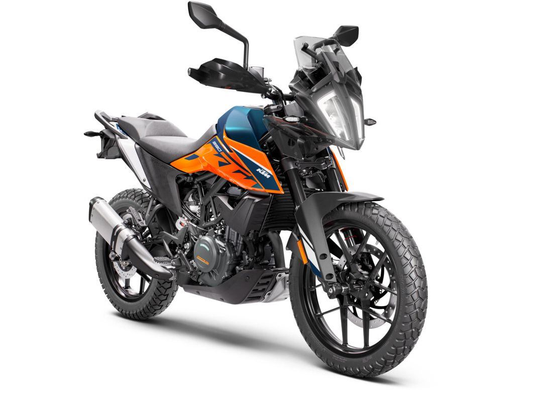

For 2022, KTM sprinkles some more ADV pixie dust on the 390 Adventure to bring it closer to its larger siblings. Updated electronics with off-road ride modes and “more robust” cast wheels make this latest offering even more capable. New paint makes it visually closer to KTM’s Dakar bikes as well.

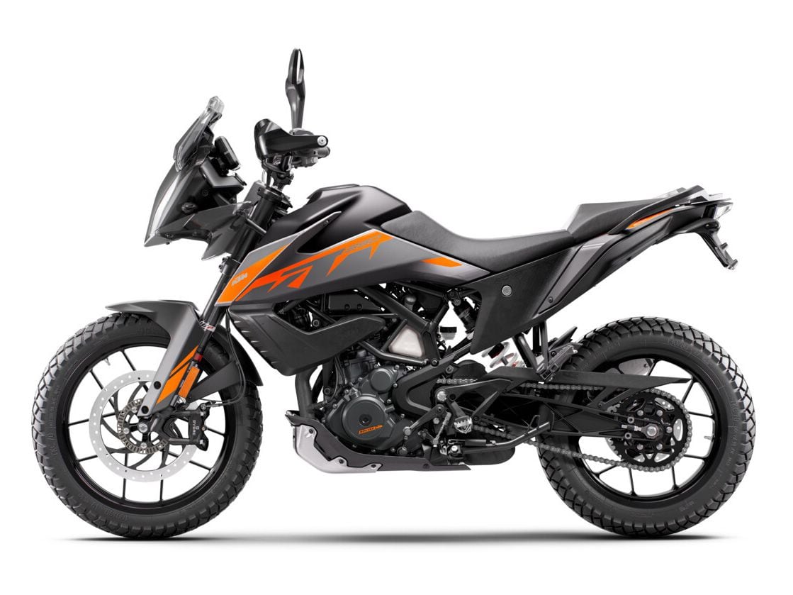

The bike is still essentially the same machine, with an unaltered steel trellis frame wrapped around a 373cc single-cylinder DOHC water-cooled engine making an impressive 43 hp and 27 lb.-ft. of torque. Recently updated to meet Euro 5 emissions limits on KTM’s home continent, that mill gets a new suite of electronic rider aids for 2022.
The traction control system now has an off-road mode alongside the standard street setting, allowing more wheelspin before stepping in to cut torque. Meanwhile, updated ABS now includes a cornering system that works when the bike is banked.
The 2022 bike also gets new 10-spoke cast alloy wheels said to be stronger than the previous hoops.

The Adventure’s Euro 5–compliant 373cc single-cylinder engine is the same engine that can be found in the 390 Duke. Although motivated by a sub-400cc single, the bike has plenty of big-bike attitude, as confirmed in our first ride aboard the small ADV, where we noted, “This isn’t a beginner’s-only, low-spec and -tech affair. No, this is a motorcycle befitting KTM’s Adventure badge.”
This liquid-cooled single doles out 37.5 hp at 8,970 rpm and 23.2 lb.-ft. at 6,990 rpm when spinning its rear wheel on our Dynojet 250i rear-wheel dyno. There’s plenty of torque for dirt or road applications, as well as ample power for the highway, although riders should expect to use the upper edge of the rpm range when running at freeway speeds. With the wind at our backs, we noted that its top speed could get over the ton and into triple digit speeds.

KTM says the new cast alloy wheels provide increased stiffness compared to the outgoing units.
