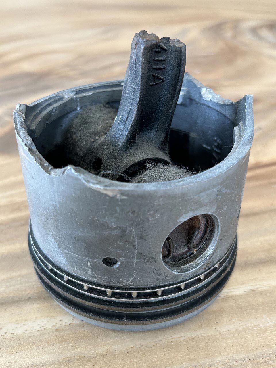

“Let he who is without oil cast out the first rod.” Book of Detonations, Chapter 1
“Let he who is without oil cast out the first rod.” Book of Detonations, Chapter 1 (Mark Lindemann/)
