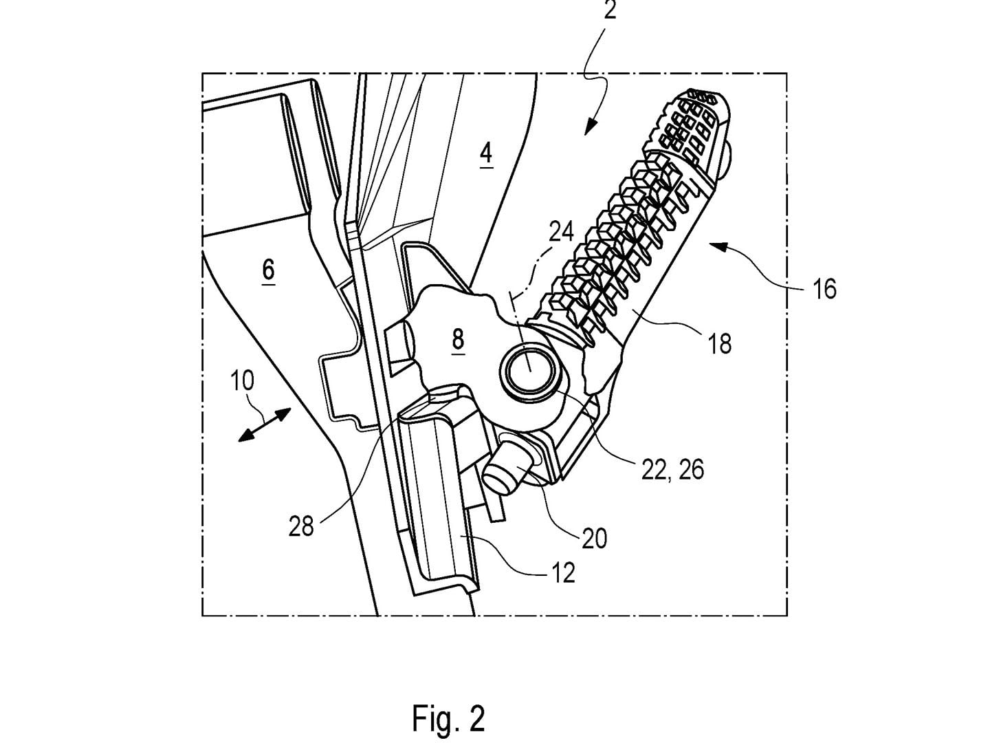

When the footpeg is folded up the pin (20) comes out of the toothed channel and allows adjustment.
When the footpeg is folded up the pin (20) comes out of the toothed channel and allows adjustment. (BMW/)

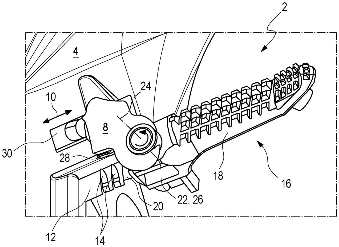

The system illustrated in the new patent is incredibly simple—the sort of thing that makes you wonder why it hasn’t been done already. It shows riders’ footpegs that are mounted in a slotted carrier that allows them to slide, but there’s no need to loosen bolts to move them. Instead there’s a sawtooth patterned set of notches machined into the aluminum hanger below the adjustment slot and a stud that extends inward, directly opposite the peg itself, to fit into it. The peg itself is hinged like those on most bikes. When the peg is extended into its normal position, the stud opposite it locks into one of the notches, preventing it from sliding along the slot in the carrier. To adjust the peg, you simply fold it upward, disengaging that stud from the notches so the whole unit can slide along its adjustment slot.
When folded down into place for riding, the pin locks into the toothed channel (12).
When folded down into place for riding, the pin locks into the toothed channel (12). (BMW/)

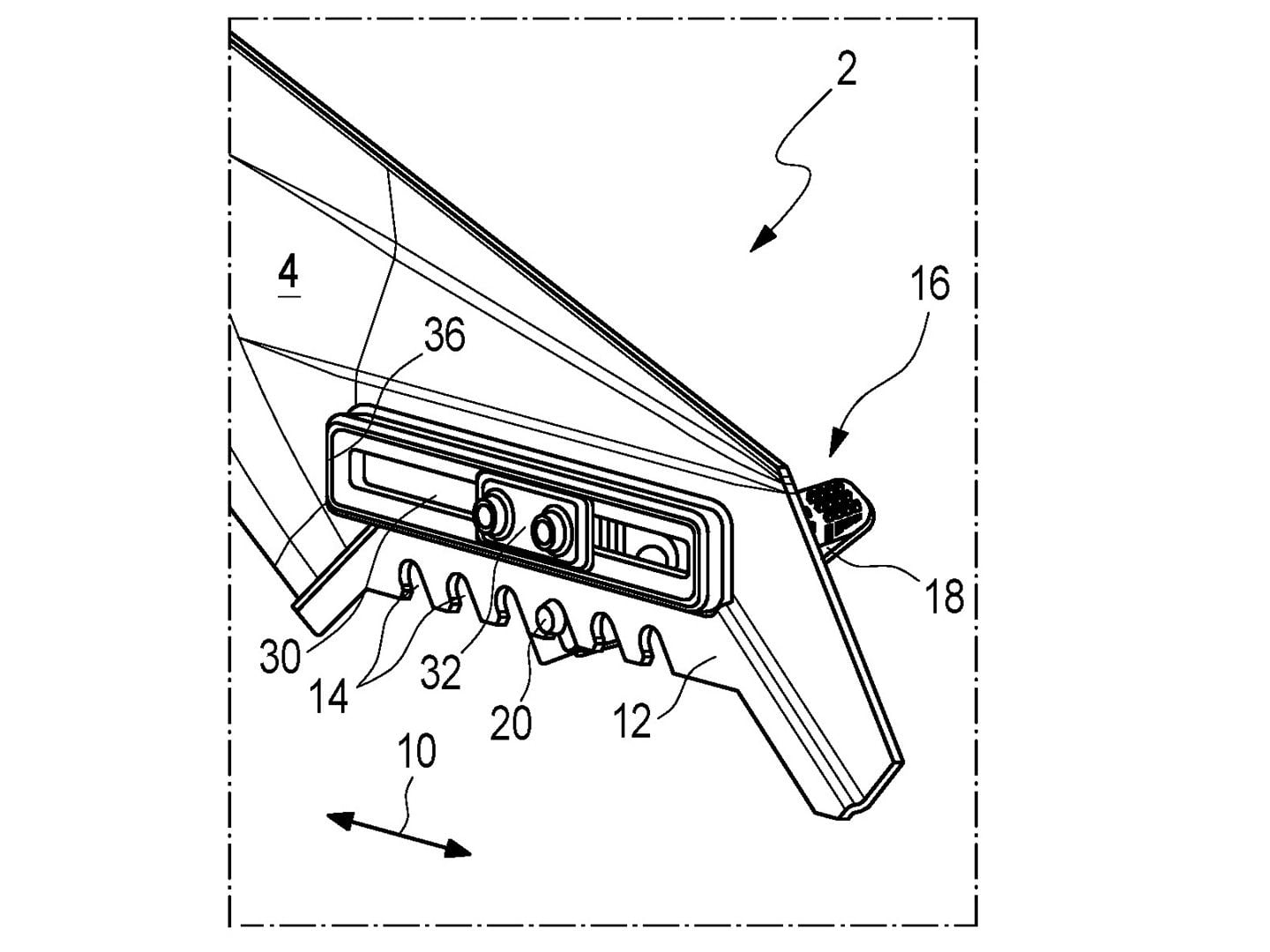

The backside view shows the pin (20) locked into the toothed notch in the track.
The backside view shows the pin (20) locked into the toothed notch in the track. (BMW/)

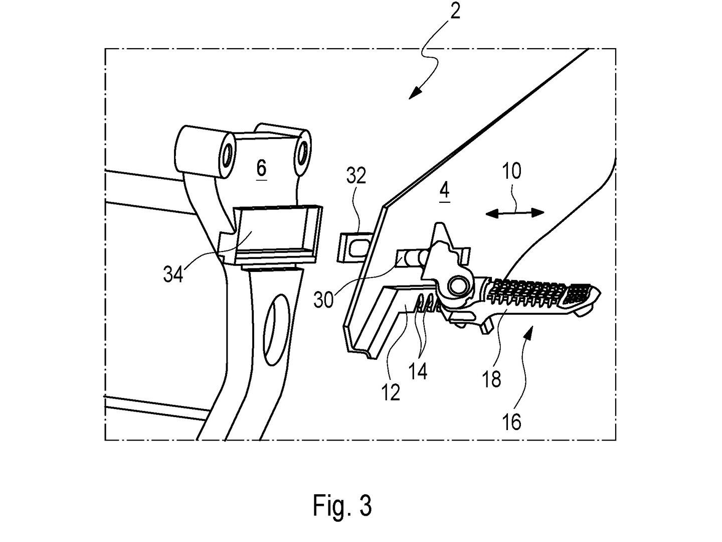

Since this is a patent application and BMW wants to cover all the bases, the document does go on to say that “if the tilting vehicle can be driven by an internal combustion engine, a shift lever or brake lever arranged on the locking means can also be moved when the locking means is adjusted.” But the illustrations don’t show how a gearshift and rear brake might be attached.
What the illustrations do show is a set of pegs mounted on an aluminum rear frame section, with the swingarm pivot clearly visible and two bolt holes to mount to the main section of the bike’s chassis. It’s a pretty common layout, but not one that matches any bikes in BMW’s current lineup. What it does match quite closely is the patent for a large electric bike that we wrote about earlier this year, which featured much the same bolt-on swingarm pivot area, attaching to a big, structural battery case.
