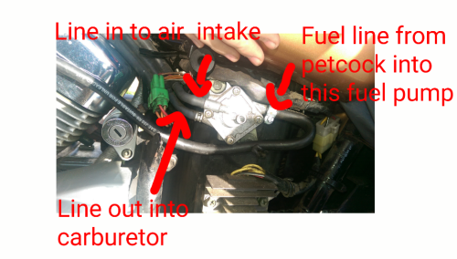

  1. See I figured that but I've put it to the front and it doesn't look right there as I've fixed the headlight recently and never seen it around that area... So update today is that it's firing and starts for about 2 seconds then cuts out It's a 2000 reg

  3. I have this Petcock in my tank (see attached) and that you've linked me to behind it. So I have fuel line from tank petcock that leads to the fuel pump, a fuel line from the pump into the carburetor and then I have a vacuum line from the air intake to the rear of the attached petcock and from the carb I have one line going in to my air filter.
  4. All connected up as indicated above, I've seen the t piece. So thus far I have back of the petcock into the air intake pipe and there's a tpiece on that, that leads to this (see image)

  7. I already have 2 pipes running to the tap at the moment and I'm pretty sure they're right. I can't think what else this would attach to...must be something important. If it helps I blew through it today in hope I'd find a link and fuel came directly out the pipe that attaches to the petcock that is used for priming fuel through. I've attached a picture with what I mean.
