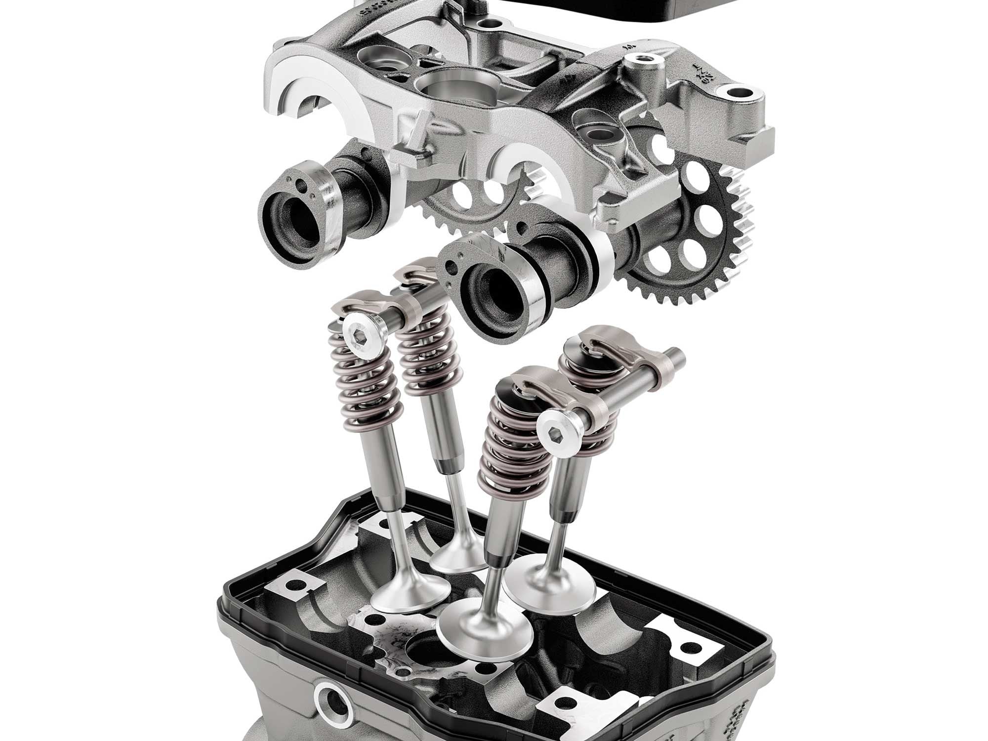

A modern four-stroke single valve train laid out about the head in which it sits.
A modern four-stroke single valve train laid out about the head in which it sits. (KTM/)

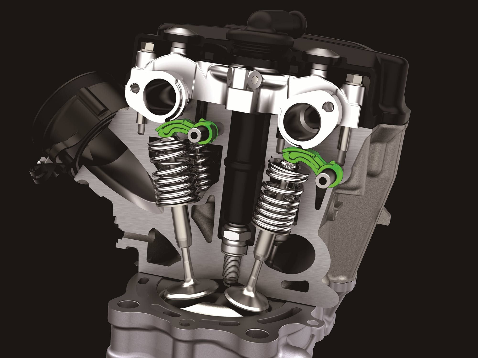

Valves are smoothly accelerated and decelerated by the cam lobe (here with a finger follower in between the two).
Valves are smoothly accelerated and decelerated by the cam lobe (here with a finger follower in between the two). (Kawasaki/)
