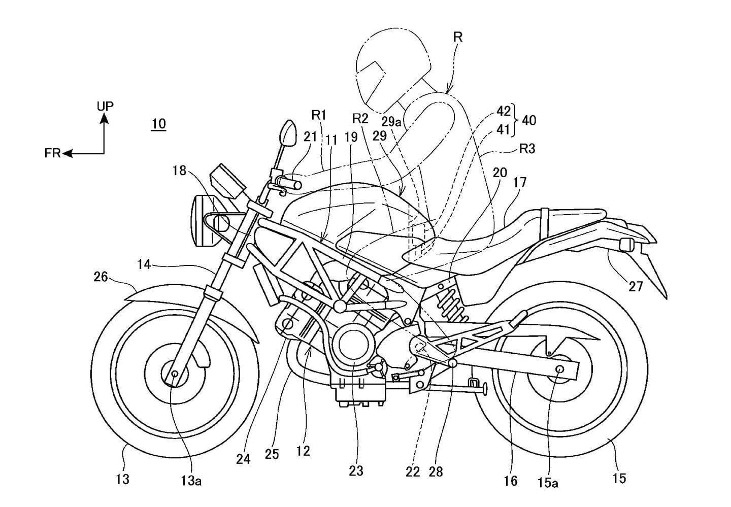

Honda’s concept is designed to deploy the airbag from the back section of the tank, with the airbag wrapping around the rider and then detaching so that when the rider leaves the bike, the airbag will be with them.
Honda’s concept is designed to deploy the airbag from the back section of the tank, with the airbag wrapping around the rider and then detaching so that when the rider leaves the bike, the airbag will be with them. (Honda/)

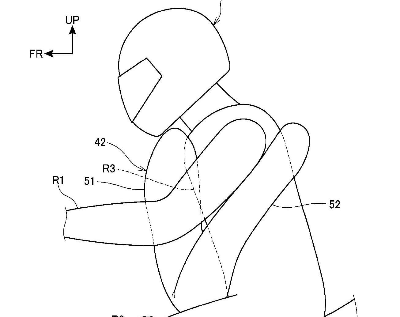

The proposed airbag would wrap around the rider’s torso.
The proposed airbag would wrap around the rider’s torso. (Honda/)

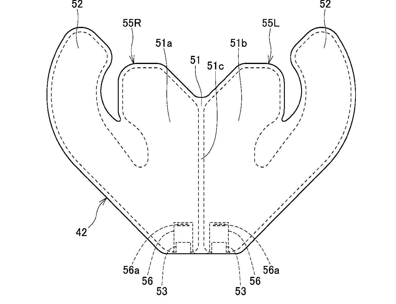

The idea is to create an airbag that, like those in cars, doesn’t need to be visible or thought about, but when activated it works more like a wearable airbag than the car-style design used on the current Gold Wing. It’s illustrated as being mounted in the rear section of a bike’s fuel tank area, under a cover, and when activated by an acceleration sensor that can detect impacts, it inflates. So far it appears to be a conventional airbag. But there are two key differences. The first is the bag’s shape. Instead of a balloon-like design it’s sculpted into a “W” shape, with outer sections that extend under the rider’s arms and a central part that goes against their chest. As it fills with air, it wraps around the rider and holds them, rather like a life jacket.

The second difference is that, once inflated, the airbag detaches from the bike and its inflators—two inflators are used—seal themselves to maintain pressure. It all happens in a fraction of a second, as soon as an impact is detected and before the rider separates from the bike, so when the rider does come off, the airbag remains wrapped around them, not attached to the bike. The result is like having a protective jacket that you weren’t wearing when the accident started.
Honda’s latest patent on the system revolves around the complexities of the separation system, showing how the airbag detaches once the pressure inside it equalizes with the pressure inside the two inflators. It’s a design that needs to be relatively simple to keep costs down and to ensure reliable operation without multiple electronic or moving parts, so when activated—even after years of dormancy—it can be relied upon to do its job.

Very interesting. This airbag patent, when it comes into production, is going to be revolutionary due to a number of reasons. The biggest benefit that nobody seems to realize or talk about with this airbag system is its placement relative to where the most common injury of a motorcyclist in a crash is, the pelvis. Because this airbag is mounted right on the rear section of the fuel tank, where in a crash, the rider often impacts the tall gas tank, the common and dreaded pelvic fractures that are very serious, can be mitigated to levels for which we never have seen before. This is a huge step forward in motorcycling safety. The airbag cushioning on the gas tank can act like a crumple zone, making the impact less severe in crashes. For more explanation and an in depth analysis on the dangers of high riding gas tanks, here is an article: https://www.motorcycle.com/ask-mo-anything/ask-mo-anything-gas-tanks-and-pelvic-injuries.html
