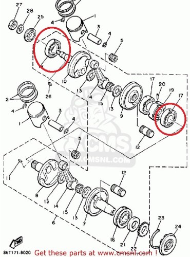

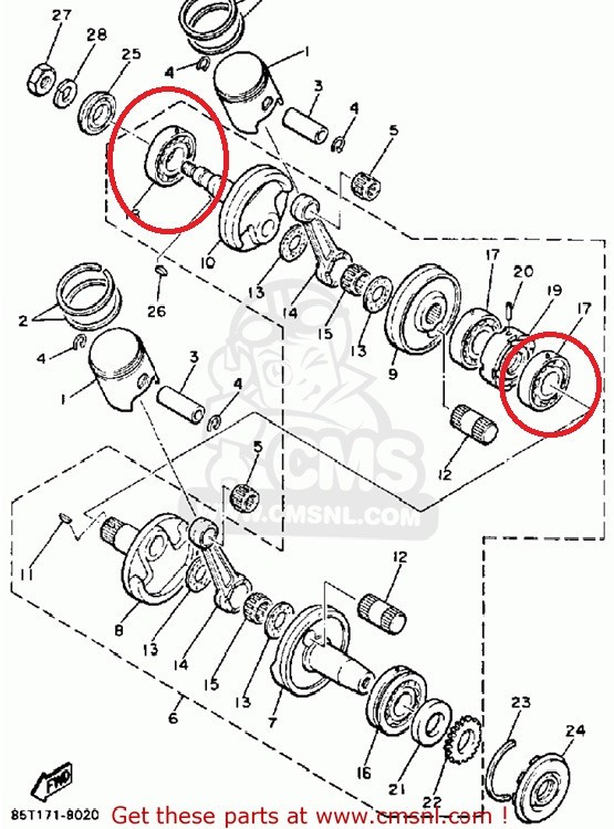

Capt Sisko Posted Thursday at 17:26 Posted Thursday at 17:26 Sorry if this is going to burst you bubble of enthisuasm, but you've probably bought a dog in need a trip to the vets, possibly it's final trip. Crankshaft bearings are what allow the internal rotational parts of the engine (in this case the crank, which then has the conrod & piston attached to it)) to spin whilst attached to the none rotational part, i.e, the engine casing. The illustration isn't from your bike, but the principle is the same. I've highlighted the Crank Bearings and as you can see the other components spin on the said bearing. Obviously there's a bit more to it than that and of cousre these bearings can be replaced, but it's an engine out, split the engine cases and specialist tools job to extract & refit the beating. Doable but no cheap. Quote
