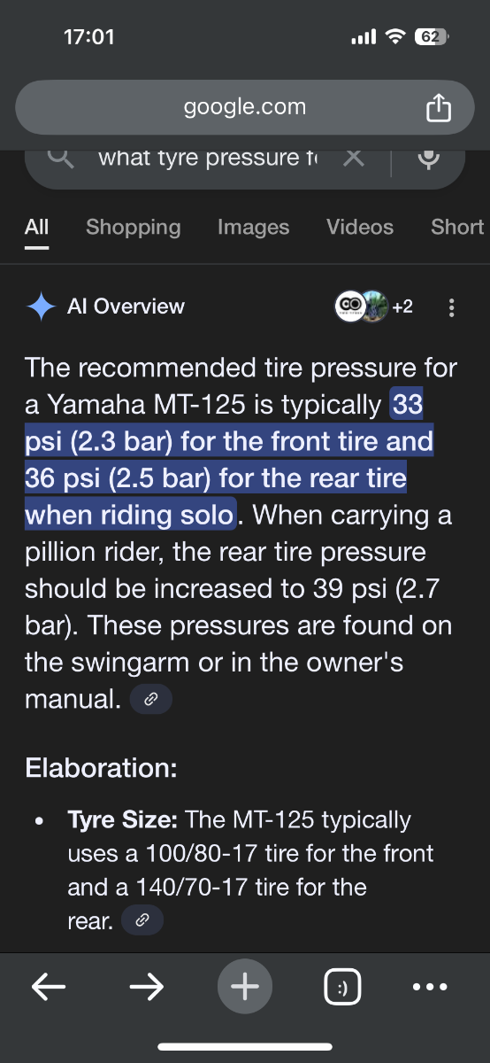

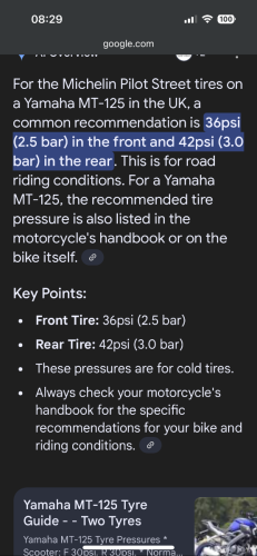

This may sound odd, but check your tyre pressures. If they have dropped  you could be altering the footprint of how much rubber there is in contact with the tarmac, and this can have an effect on how the bike turns.
