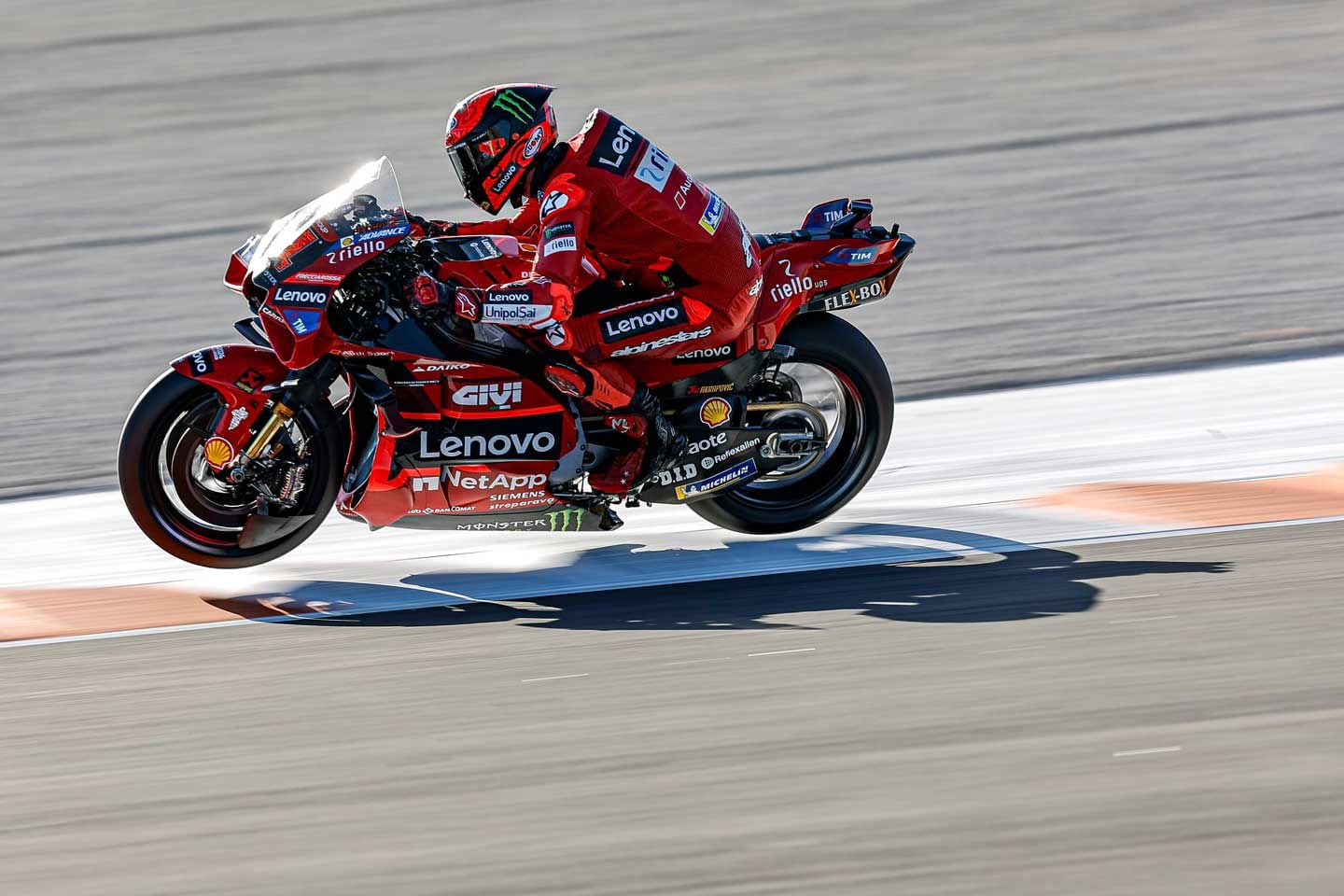

Rear squat—and indeed any reduction in center of gravity height—during acceleration while upright allows the rider to accelerate a bit harder before hitting the “wheelie limit” set by front wheel lift.
Rear squat allows the rider to accelerate harder by lowering the CG. Wheel lift limit is increased as the rear squats.
Rear squat allows the rider to accelerate harder by lowering the CG. Wheel lift limit is increased as the rear squats. (Ducati/)
Rear squat while accelerating, still leaned over in a corner takes weight off the front tire, reducing its ability to steer the motorcycle, and so causing it to run wide. This is corrected by setting the swingarm pivot at the correct height, allowing drive chain tension to generate a lift force that cancels acceleration squat.
