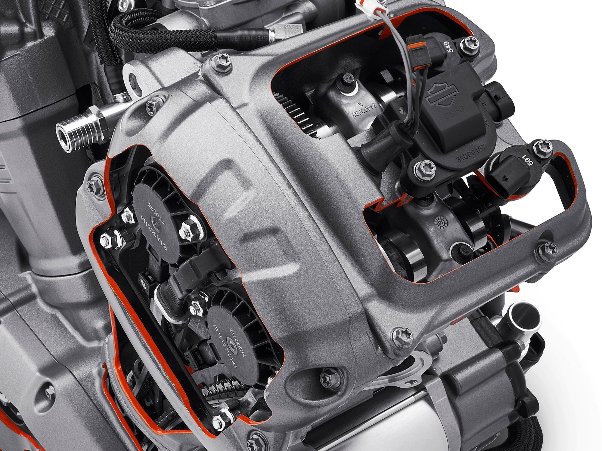

Driving cars with VVT cam phasers demonstrates the strong torque VVT provides at lower revs, <i>without</i> torque fade farther up the rpm scale. The 1250′s cam phasers are hydraulic and controlled by solenoid plungers. At rest, the intake cams default to full retard while the exhaust cams go to full advance, the positions of minimum valve overlap and strong bottom torque.
Hydraulic cam phasers actuated by solenoid plungers control the Pan America’s VVT cam timing.
Hydraulic cam phasers actuated by solenoid plungers control the Pan America’s VVT cam timing. (Harley-Davidson/)
Boz said, “As a function of VVT, we have a super-broad powerband. People who ride KTM and BMW have said it <i>feels</i> more powerful than the competition.”

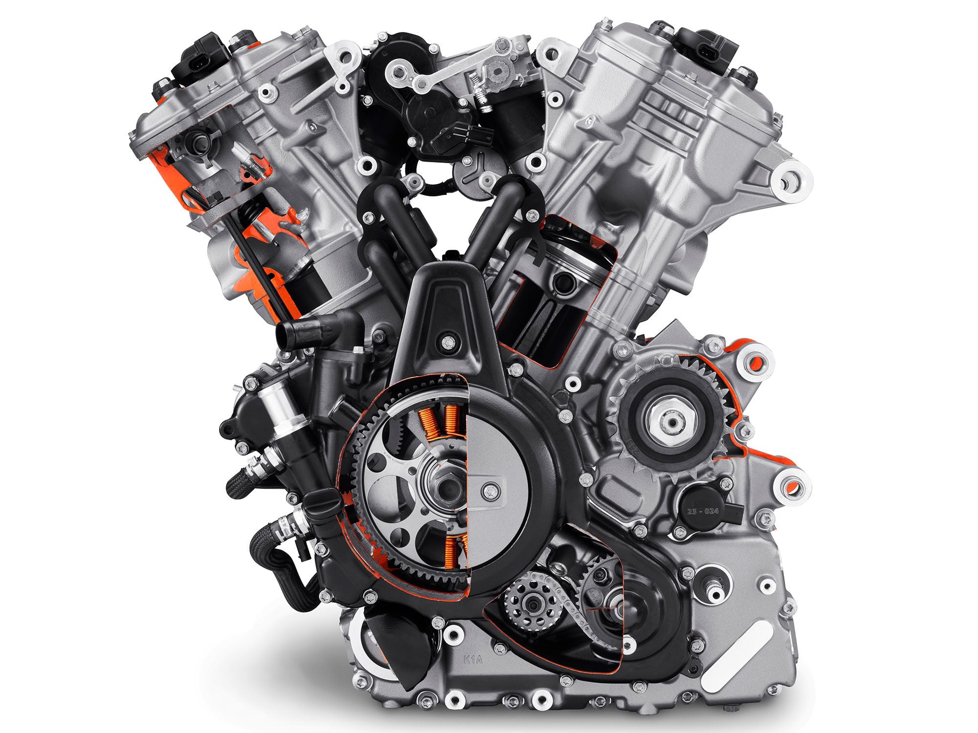

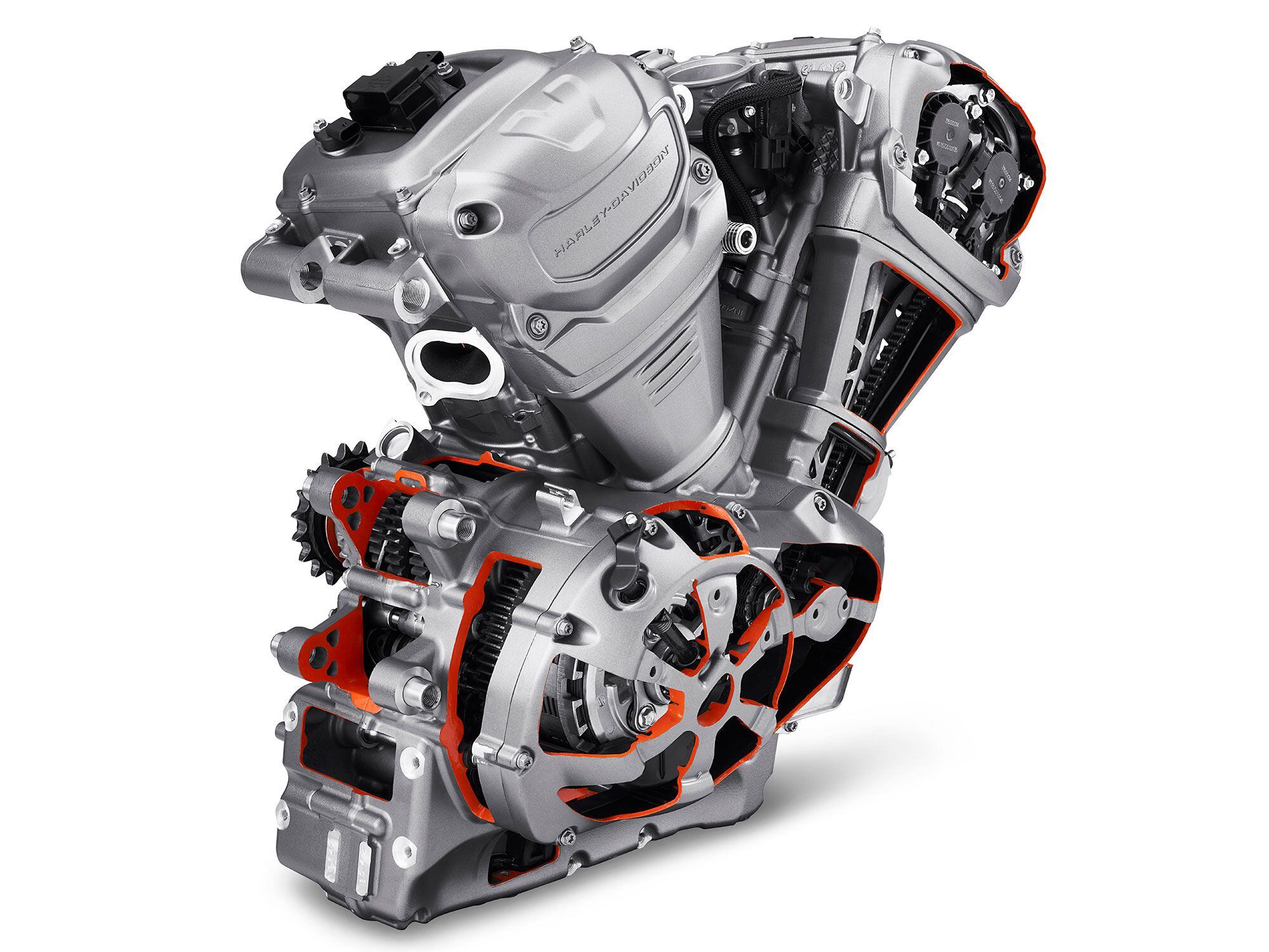

The 1250 engine breaks Harley’s long-stroke tradition with its oversquare 1.46 ratio of bore to stroke. The large 105mm bore provides room for four large valves (the exhausts are internally sodium-cooled) that supply the air needed to make power at 9,000 rpm. Peak torque of 94 pound-feet comes at 6,750, but in engines with this kind of wide, flat torque, this is misleading: This peak is not a spike, but merely the highest point on a nearly flat line.
The 1252cc Revolution Max engine produces a claimed 94 pound-feet of peak torque and 150 horsepower.
The 1252cc Revolution Max engine produces a claimed 94 pound-feet of peak torque and 150 horsepower. (Harley-Davidson/)
The 1250′s crankshaft has two crankpins, staggered at 30 degrees to each other. This reduces primary shaking force and spaces top dead center of the two cylinders (the rear is offset to the left) 90 degrees apart. A primary balance shaft deals with both shaking and rocking. A secondary balance shaft is located between the cams of the front cylinder, geared to one of the cam phasers. This shaft therefore gives a different vibration at idle, making the engine feel “alive,” but runs smoother at freeway speeds. Balance shafts save weight, for without them bikes would need heftier structure just to survive their own vibration.
Why not balance everything to zero? Michael Carlin, Chief Engineer Powertrain, said, “In Milwaukee-Eight we intentionally kept some vibration, because otherwise it doesn’t feel right.”
Cylinders are separate, with weight-saving Nikasil hard-plating instead of iron liners. Why not integrate the cylinders into the case, as some other makers do? It wouldn’t be a Harley if there were no way to boost displacement! Each cylinder head has dual ignition. Generally, twin plugs improve idle quality, reduce emissions, and allow higher compression.
The foundation of engine reliability is its oil system. To make centrifugal force boost oil pressure rather than weaken it, they chose the best: Formula 1-style oil feed into the end of the Revolution Max 1250′s crank rather than traditional feed through the main bearings. There are three scavenge pumps: one for the crank chamber; one for the clutch case, where there’s a baffle to keep oil off the spinning clutch; and one for the alternator cavity. Scavenge capacity is enough to pull a significant vacuum on the crankcase, allowing use of friction-reducing low-tension piston rings, a concept from NASCAR. These are examples of the attention given to cutting parasitic losses in this engine. Rotating parts are high above the wet sump oil level, preventing them from creating an oil storm and losing energy that should be going to the rear wheel. A measure of success here is the claimed 48 mpg city/highway fuel mileage.

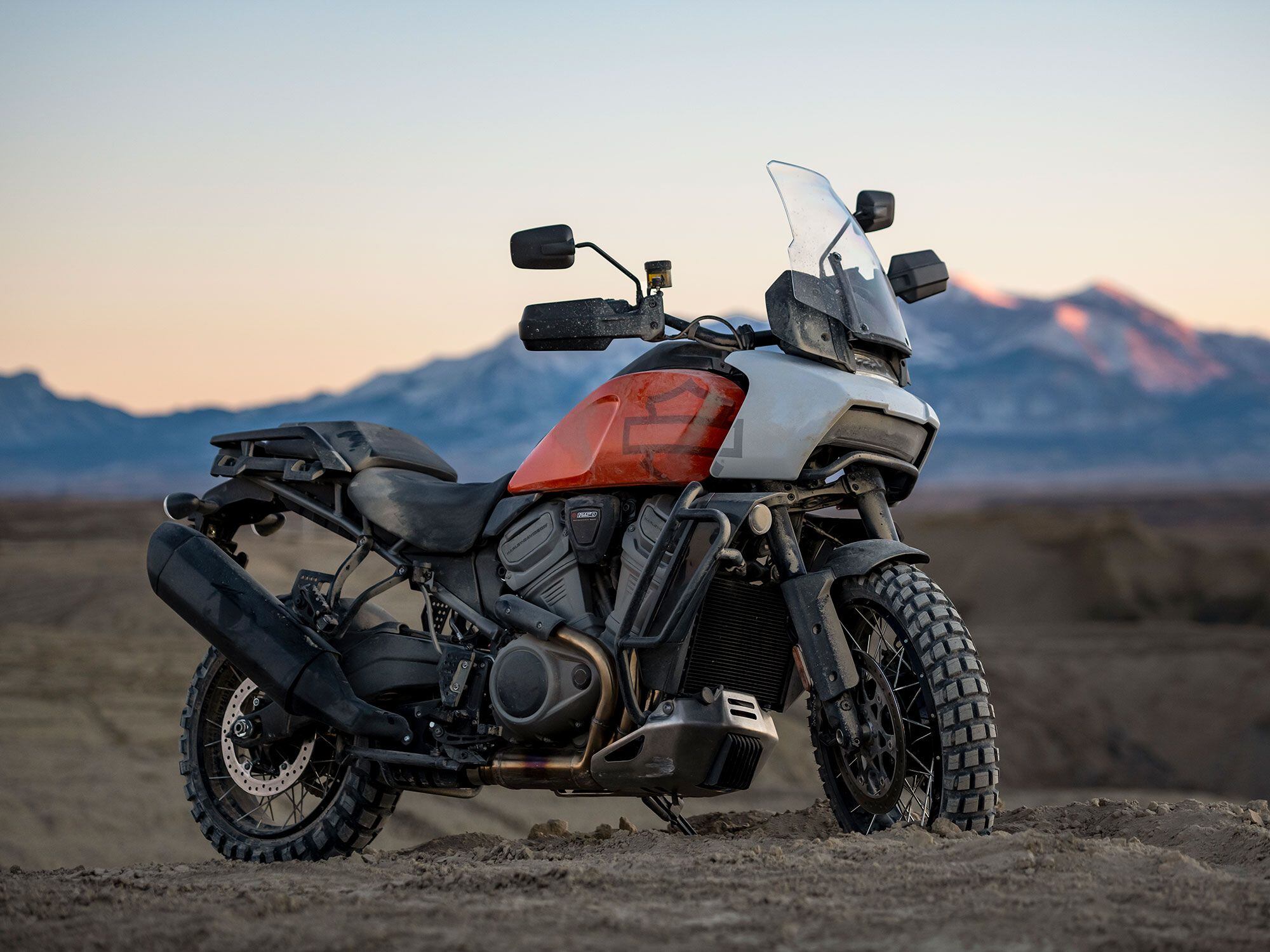

Weight control is essential to a big-engined bike like this, dictating the magnesium engine covers, aluminum fuel tank, and aluminum swingarm and mid-frame. Shipping weight is claimed to be 503 pounds, running weight 534.
An aluminum tank, swingarm, and frame sections along with magnesium engine covers are among weight saving measures in the Pan America.
An aluminum tank, swingarm, and frame sections along with magnesium engine covers are among weight saving measures in the Pan America. (Harley-Davidson/)
Because this is a Harley-Davidson, it cannot have valve noise or require valve adjustments (service interval is 5,000 miles). Therefore its roller finger cam followers have hydraulic clearance adjusters. Cams are chain-driven.
To accurately set compression ratio at 13.0:1, the crowns of the pistons are fully machined. Compression is the path to high torque! Recommended fuel is 91 (R+M)/2, but thanks to its knock detection/ignition retard system, the engine can run safely on lower octane fuel at some sacrifice of power. There are piston cooling oil jets in the crankcase, aimed up at the undersides of the piston crowns.
Thanks to its vertically stacked gearbox, tucked under the rear cylinder, this engine is extremely short. The high location of the output sprocket testifies to lowest-possible positioning of the engine (“Moving weight south,” Bozmoski calls it) to ease low-speed maneuvering.
H-D’s engineers achieved a short engine front to back by vertically stacking the transmission shafts.
H-D’s engineers achieved a short engine front to back by vertically stacking the transmission shafts. (Harley-Davidson/)
The crankshaft drives the six-speed gearbox through a noise-reducing scissors primary gear. Remember Harley’s 1980s message: “We’re killing the noise so we can keep the music.” A slipper/assist clutch with eight friction discs cuts lever effort while preventing engine-braking from hopping or sliding the rear tire on closed throttle. A spring drive in the clutch outer smooths torque delivery.
