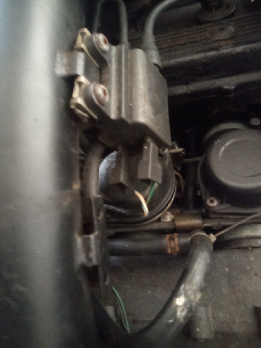

@linuxrob  2 coil packs 4 cylinders...
Photo shows back of 1 coil pack.
Well in that case then swap the plug caps and see if it moves
the coils will fire in pairs and always have a wasted spark on a plug so swapping them should make no difference
Although once you have the bike apart you could get it running without the airbox on and squirt some carb cleaner in :?

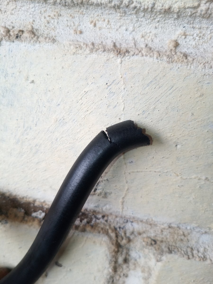

Tried her today, found what I think is the cause, split vacuum hose.
She started running on all 4 cylinders, I switched 3&4 no change.
the vacuum hose has long been gremlin on trophies will start a new thread for suggestions on my solution...
