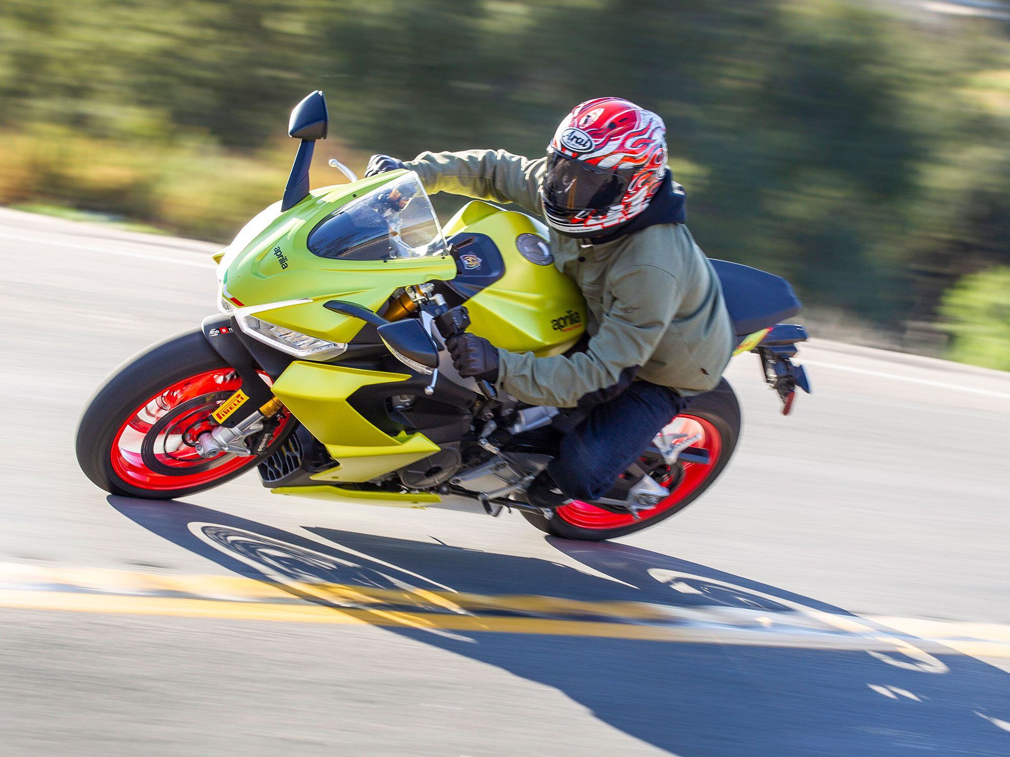

The RS 660 is the child of Aprilia’s open-class superbike technical expertise combined with everyday functionality and comfort, making it an enticing option to the supersport-curious. Yet it’s wickedly entertaining and capable of educating even the most experienced riders. Think scaled-down RSV4 1100 Factory performance in an approachable package. It’s a fresh and unique take on the middleweight supersport segment. And it’s freakin’ awesome.
The 2021 Aprilia RS 660 is a new take at the middleweight supersport segment, combining an all-new parallel-twin engine with practical ergonomics and performance.
The 2021 Aprilia RS 660 is a new take at the middleweight supersport segment, combining an all-new parallel-twin engine with practical ergonomics and performance. (Jeff Allen/)

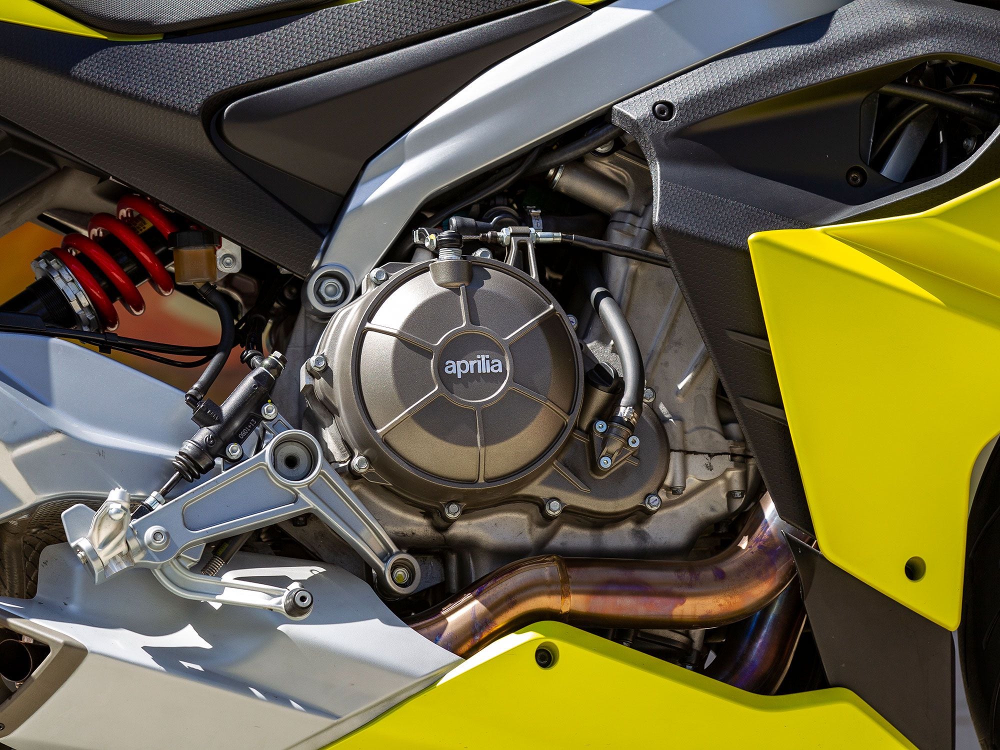

Powering the solution is a 659cc DOHC parallel-twin engine which recorded an impressive 88.81 peak horsepower at 10,450 rpm and 45.34 pound-feet of torque at 8,530 rpm on our in-house Dynojet 250i. Equally impressive is the 660′s broad, flat torque curve, which really graphs out more like a tabletop; its linear power delivery makes for a very tractable, friendly ride. That said, the usual mass of superbike horsepower isn’t there to fall back on if you aren’t on the ball. Extracting the potential of the RS 660 means carrying momentum and linking curves together, which is the most fun and instructive aspect of riding it. Still, when wicked up the Aprilia is a middleweight missile.
The heart of the RS 660 is an all-new 659cc parallel-twin engine that has been derived from the forward-facing cylinders of Aprilia’s 1,100cc V-4 powerplant. It produced a mighty 88.81 hp at 10,450 rpm and 45.34 pound-feet of torque at 8,530 rpm.
The heart of the RS 660 is an all-new 659cc parallel-twin engine that has been derived from the forward-facing cylinders of Aprilia’s 1,100cc V-4 powerplant. It produced a mighty 88.81 hp at 10,450 rpm and 45.34 pound-feet of torque at 8,530 rpm. (Jeff Allen/)
It’s a hoot on the backroads. Roll on the throttle and the 660 produces immediate, usable power from 6,000 rpm, letting you pull strongly from the corner exit and gaining real life at the 8,000 rpm mark. There the 660 lets loose with an evocative exhaust howl and accelerates vigorously to its 11,500 rpm redline. Keep it spinning and you’re rewarded with a seriously good time.
As much of a ripper as the RS 660′s powerplant is, it has balance that any rider, new or seasoned, can appreciate. Extra low-end grunt separates it from the inline-four screamers and adds around-town everyday flexibility to the machine. Throttle response from the ride-by-wire system is crisp, and the excellent connection to the rear wheel boosts rider confidence even in the most aggressive of three selectable ride modes. It’s delightfully smooth at highway speeds, settling in around 6,000 rpm in top gear and letting the rider enjoy the cruise control function, interrupted only by the somewhat annoying buzzy mirrors. A combined 42.4 mpg aids peace of mind. And when it comes to the canyons, the factory-equipped up/down quickshifter promotes smooth, almost seamless progress through the six-speed gearbox, helping with tightly spaced gear ratios that demand numerous changes on a spirited run.

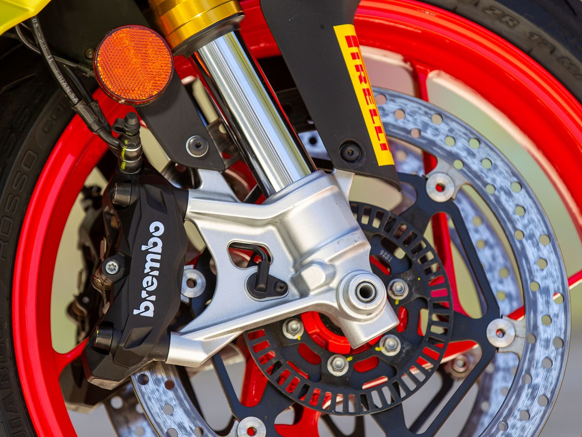

A pair of radial-mounted Brembo four-piston calipers bring the RS 660 to a quick halt with impressive stopping power. The initial brake bite, however, is overly aggressive and sensitive. Thankfully, superb ABS intervention aids deceleration.
A pair of radial-mounted Brembo four-piston calipers bring the RS 660 to a quick halt with impressive stopping power. The initial brake bite, however, is overly aggressive and sensitive. Thankfully, superb ABS intervention aids deceleration. (Jeff Allen/)

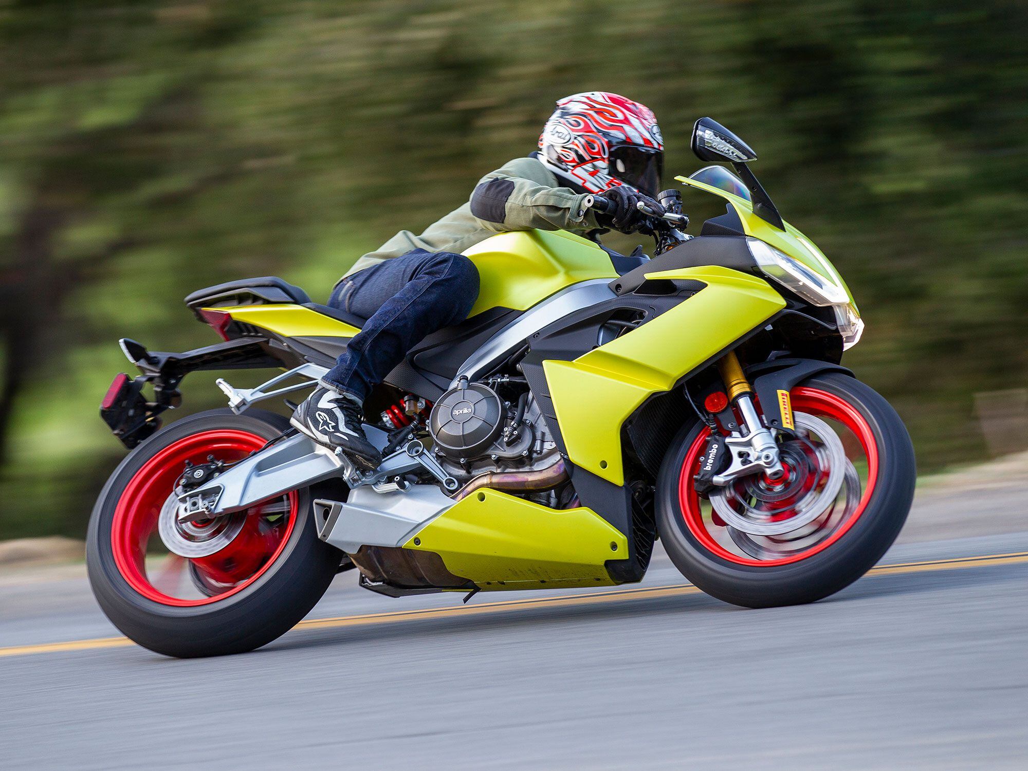

Solid chassis composure combined with nimble flickability make for a wicked time. The OE-fitted Pirelli Diablo Rosso Corsa II tires offer gobs of a grip too.
Solid chassis composure combined with nimble flickability make for a wicked time. The OE-fitted Pirelli Diablo Rosso Corsa II tires offer gobs of a grip too. (Jeff Allen/)
And the RS 660 enjoys ripping a technical sequence of corners. Handling is sharp and agile, providing quick cornering at maximum lean. It quickly snaps through side-to-side transitions with little effort, yet remains composed and stable at speed. It’s an any-apex-anytime attitude on this Aprilia. If there’s any gripe in the RS 660′s handling, it comes in the form of its rebound damping and spring preload adjustable-only KYB suspension. The initial stroke of the fork is harsh and lacks small-bump compliance, ultimately robbing confidence and feel on imperfect tarmac. Compression damping adjustability would be welcomed. Certainly the suspension isn’t overburdened. At a measured 401 pounds with its 4.0-gallon fuel tank topped off, the Aprilia is relatively lightweight for the middleweight class; for reference, the last Kawasaki ZX-6R we tested weighed 432 pounds.

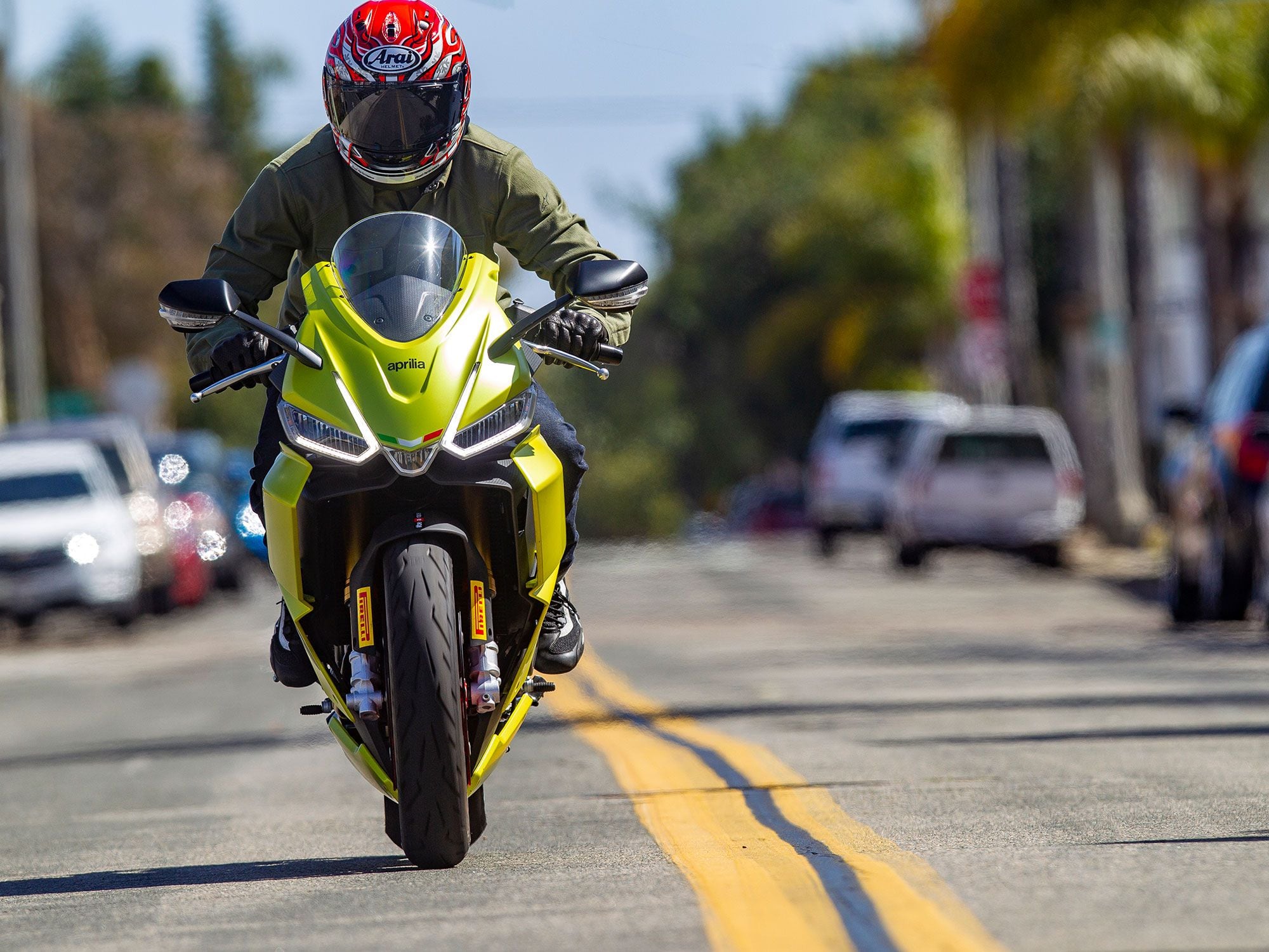

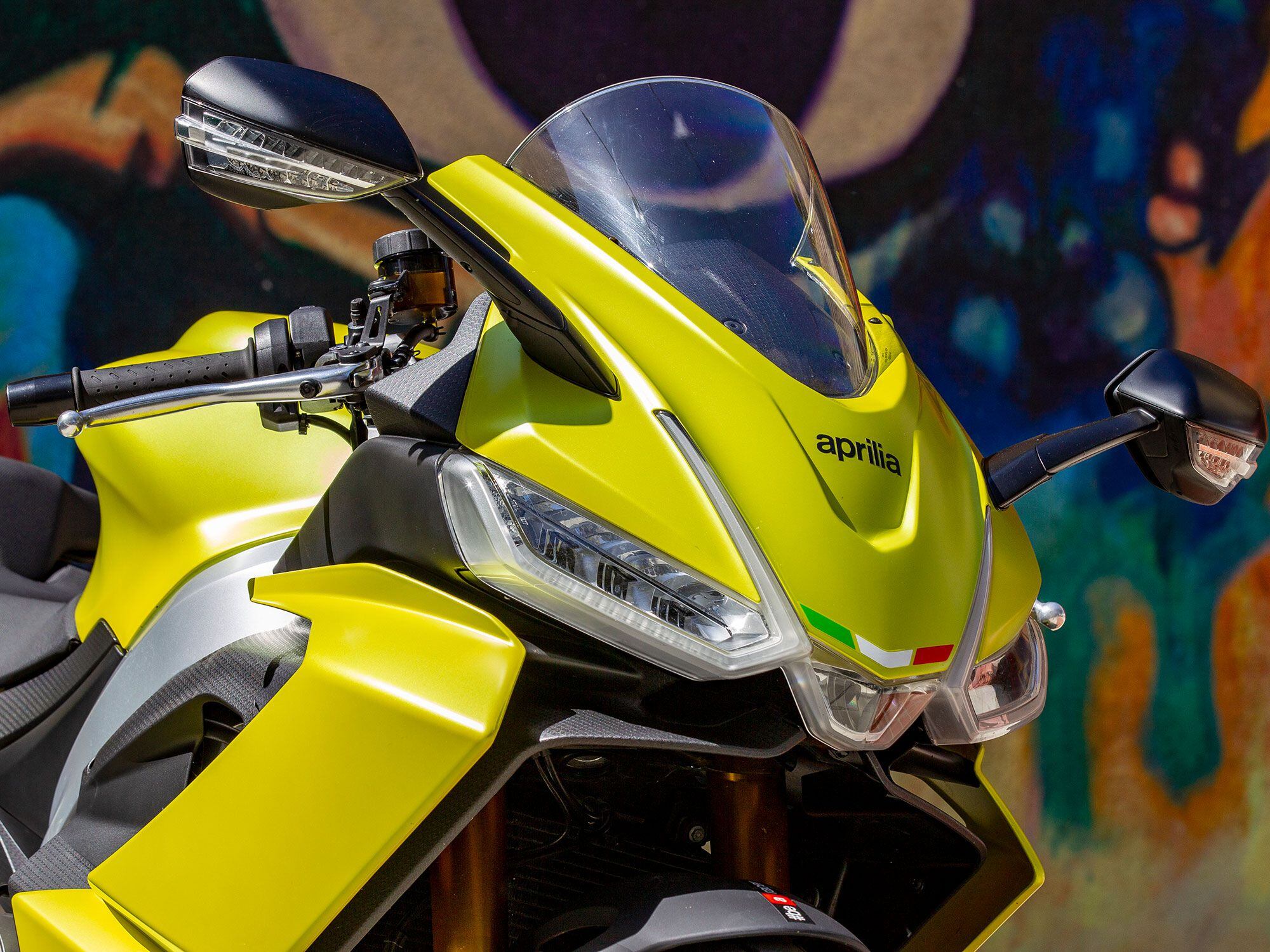

The RS 660 gets the premium fit and finish you would expect from Aprilia. Take the LED headlights and integrated aerodynamic winglets, for example.
The RS 660 gets the premium fit and finish you would expect from Aprilia. Take the LED headlights and integrated aerodynamic winglets, for example. (Jeff Allen/)
The Aprilia is impressive at corner entry, though an overaggressive initial brake bite tends to hinder its potential. Squeeze the lever tightly while in a rush to slow the 660′s speed, and you may find the power of the Brembo Monoblock calipers difficult to modulate. It’s a problem that hurts the overall feel when traveling at a spirited pace and is especially noticeable in the tight confines of urban riding. Aprilia’s three-level engine-brake control helps out here though, adding adjustability of deceleration and ensuring confidence at the tire’s contact patch in braking zones.

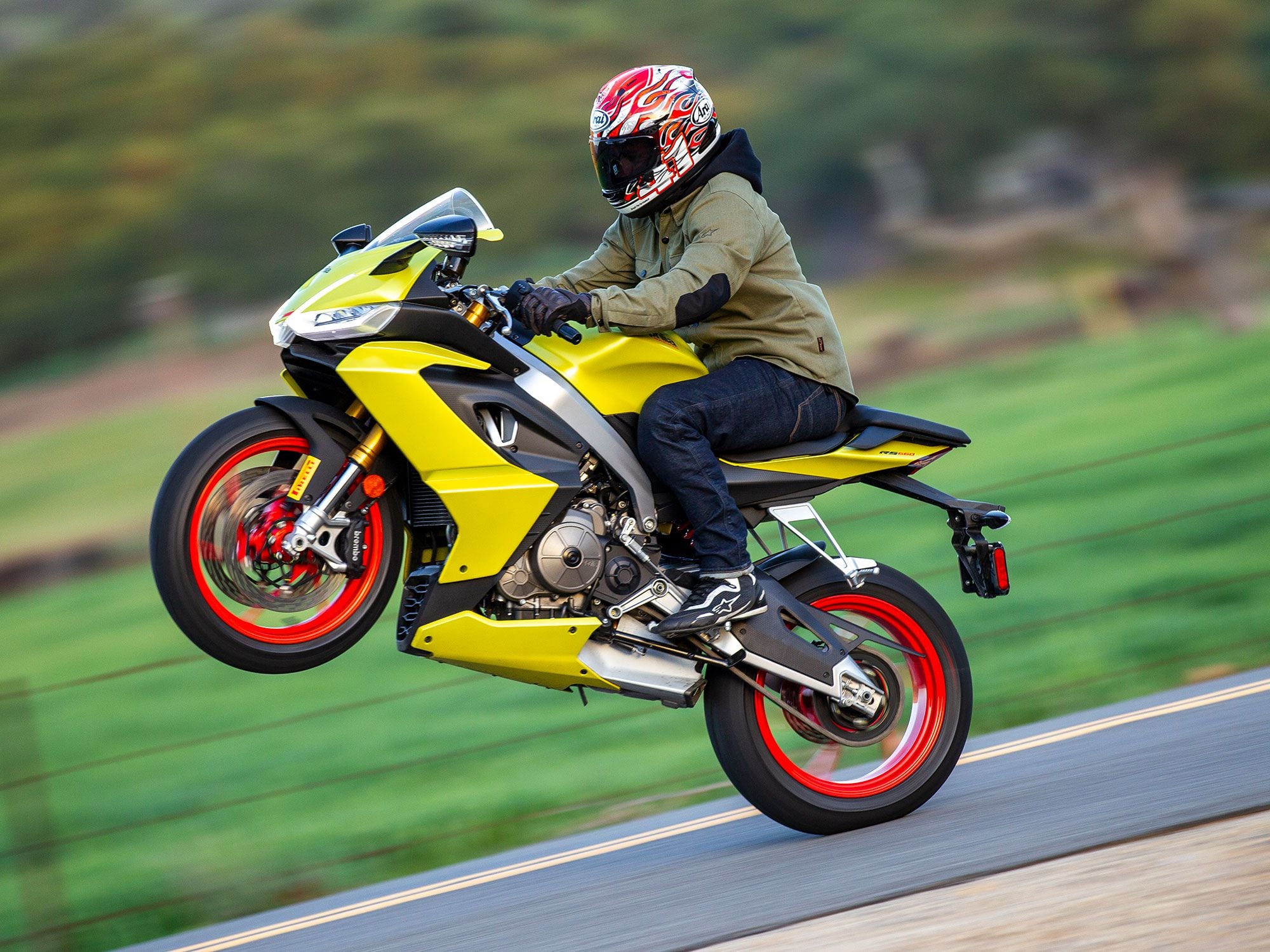

Aprilia enough for you? Disabling all the rider-aid functions allows the RS 660 to take life!
Aprilia enough for you? Disabling all the rider-aid functions allows the RS 660 to take life! (Jeff Allen/)
