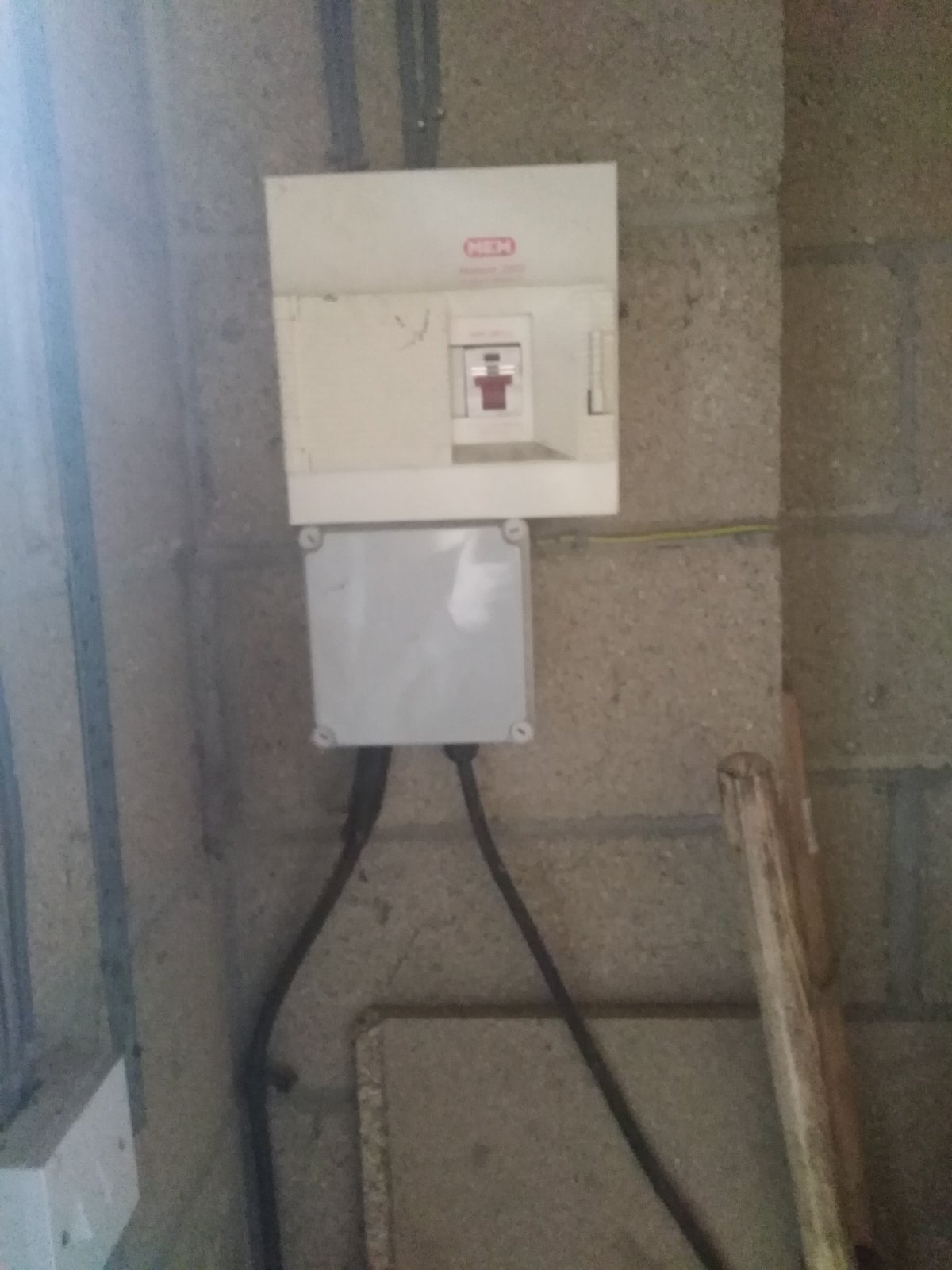

There's power running from the house across the garden to the garage (garage is completely separate) via a grey box underneath a consumer unit. From the right hand side of the grey box is a cable which is not connected to anything at the other end. It was running from the box through a hole in the wall under a concrete path in the garden into a plastic tube. I've pulled it through into the garage for the time being, but could anyone tell me if it is meant to be there or what it might be for?
4 minutes ago, Stu said:
Someone had a pond in the garden before?
Could be. There is a well but it has been filled in. Maybe it ran to a pump in the well at some point but would that not come off the consumer unit rather than what I assume is a fused junction box? If not then is the cable live?
Probably more than likely for a pump or some lights maybe!
I can't answer if it's live or not but I would isolate the electrics and remove that wire if it's not in use.
As above, if it's not in use isolate and disconnect, if in doubt or you don't like electricity get someone else to do it.

If you can isolate the incoming supply at the house then do that and away you go
I suspect it may already be dead though otherwise you will have had some issues already if its just cut?
Yeah that's my thoughts. The cut end has just been outside in a tube where it would get wet etc. I'll isolate and open the box up and take a gander.

Especially in this house. Any assumption something has been done properly is misguided. I'll be very cautious. If it comes to it, I'm more than happy to get someone in to check through it all and I'll crack on with one of the other jobs that need doing.
Our last house had something similar. At the back it fed a fountain pump and at the front it went nowhere but had obviously been put in for lighting around the drive. They were both live even though the front one went nowhere.
