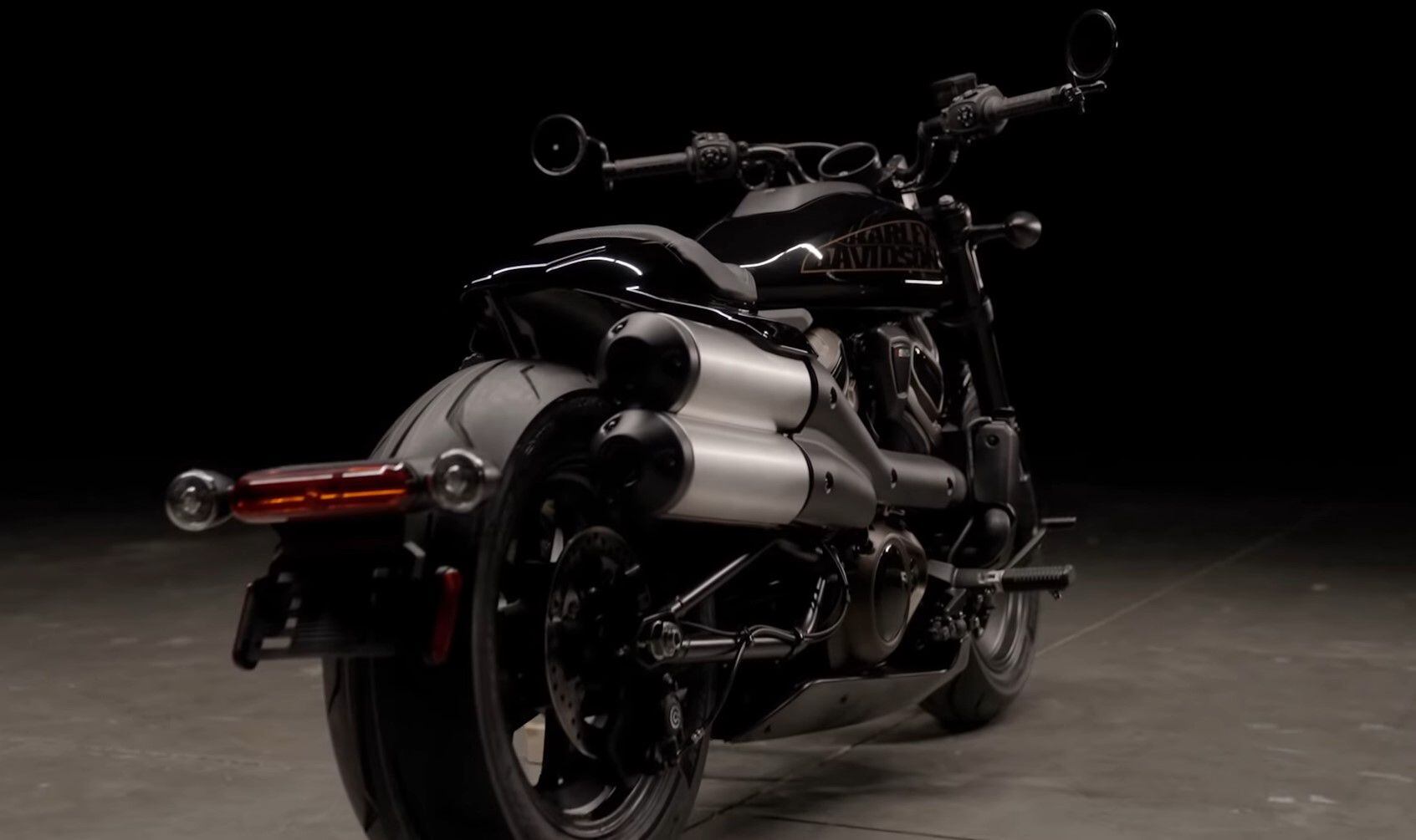

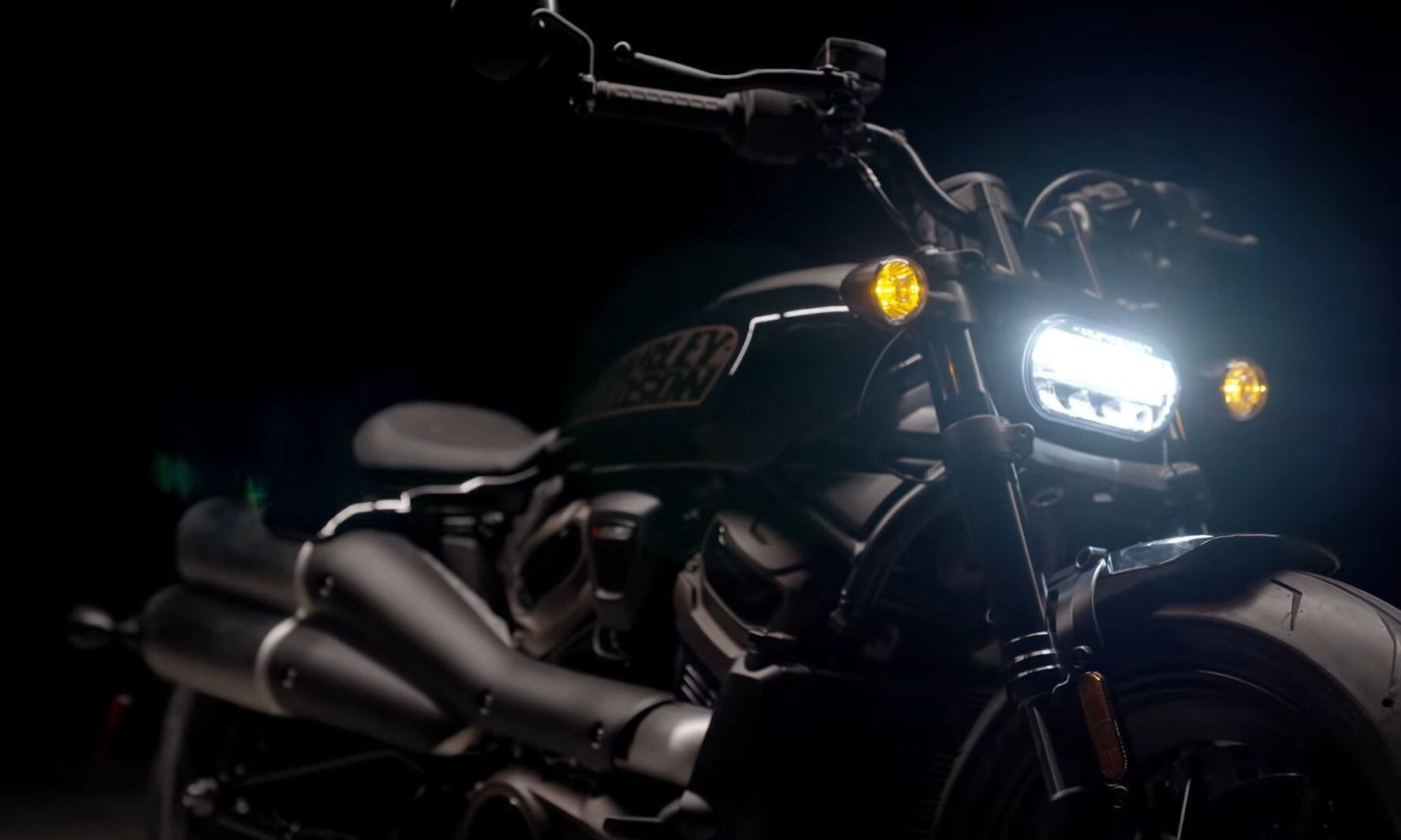

A screengrab from Harley’s July 13 teaser shows the DOHC 1,252cc engine. Documents reveal it will make less power than the unit powering the Pan America 1250 adventure motorcycle.
A screengrab from Harley’s July 13 teaser shows the DOHC 1,252cc engine. Documents reveal it will make less power than the unit powering the Pan America 1250 adventure motorcycle. (Harley-Davidson/)

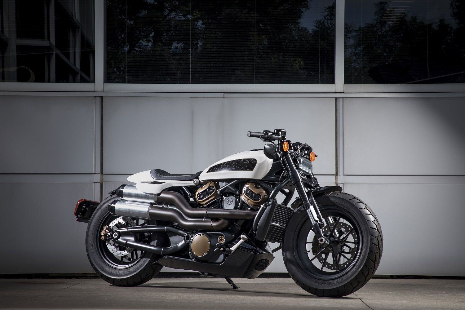

The 2018 concept for the Sportster S is very similar to the finished product seen in the H-D teaser video.
The 2018 concept for the Sportster S is very similar to the finished product seen in the H-D teaser video. (Harley-Davidson/)
