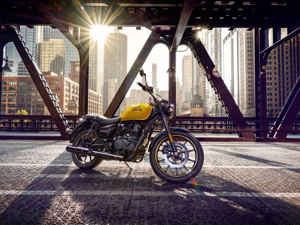

The Meteor 350 is a charming small-displacement cruiser from the India-based brand.
The Meteor 350 is a charming small-displacement cruiser from the India-based brand. (Royal Enfield/)

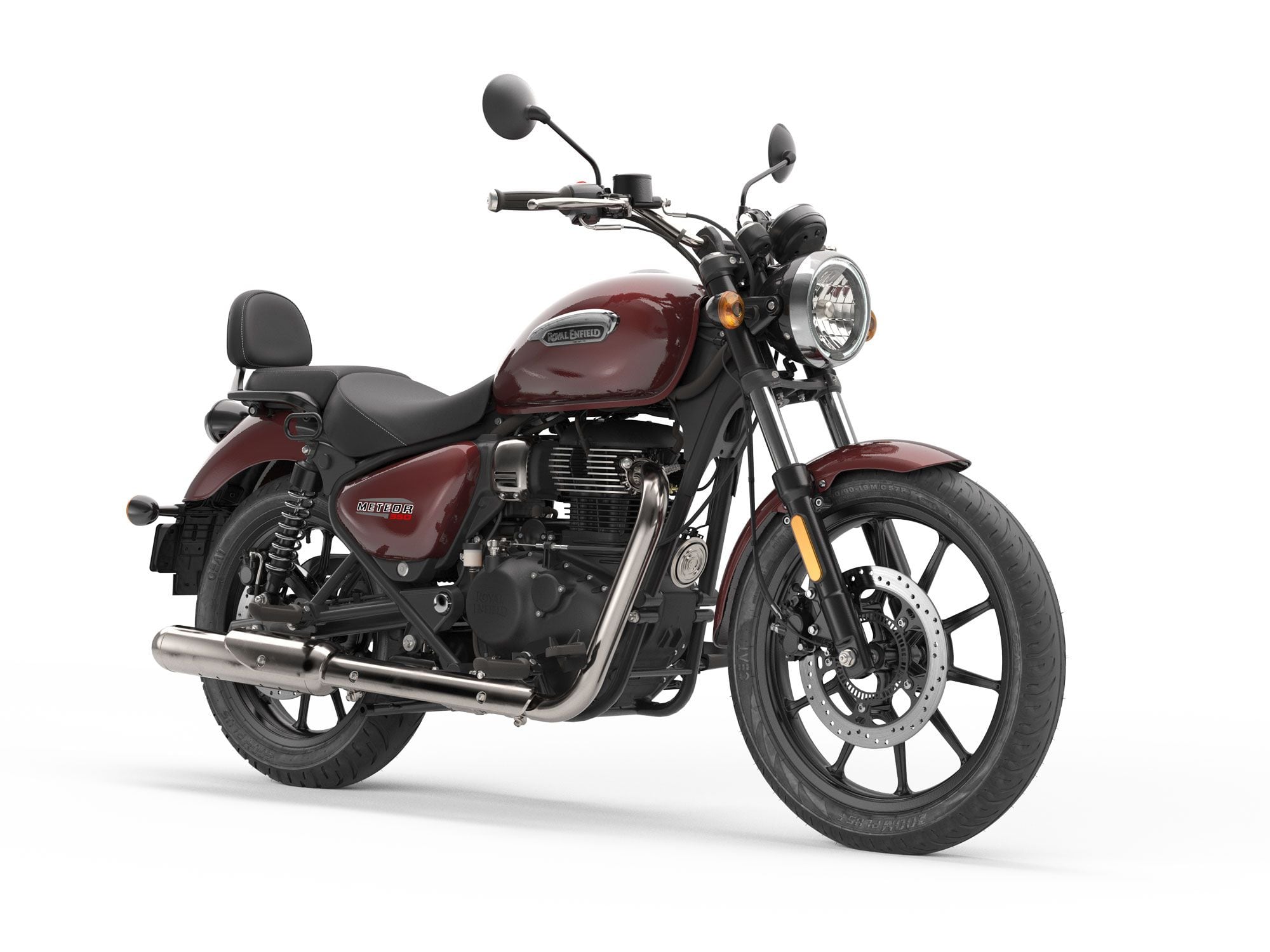

Comfort is king. Relaxed ergonomics and a flat seat make the Meteor 350 a great choice for all-day cruising.
Comfort is king. Relaxed ergonomics and a flat seat make the Meteor 350 a great choice for all-day cruising. (Royal Enfield/)

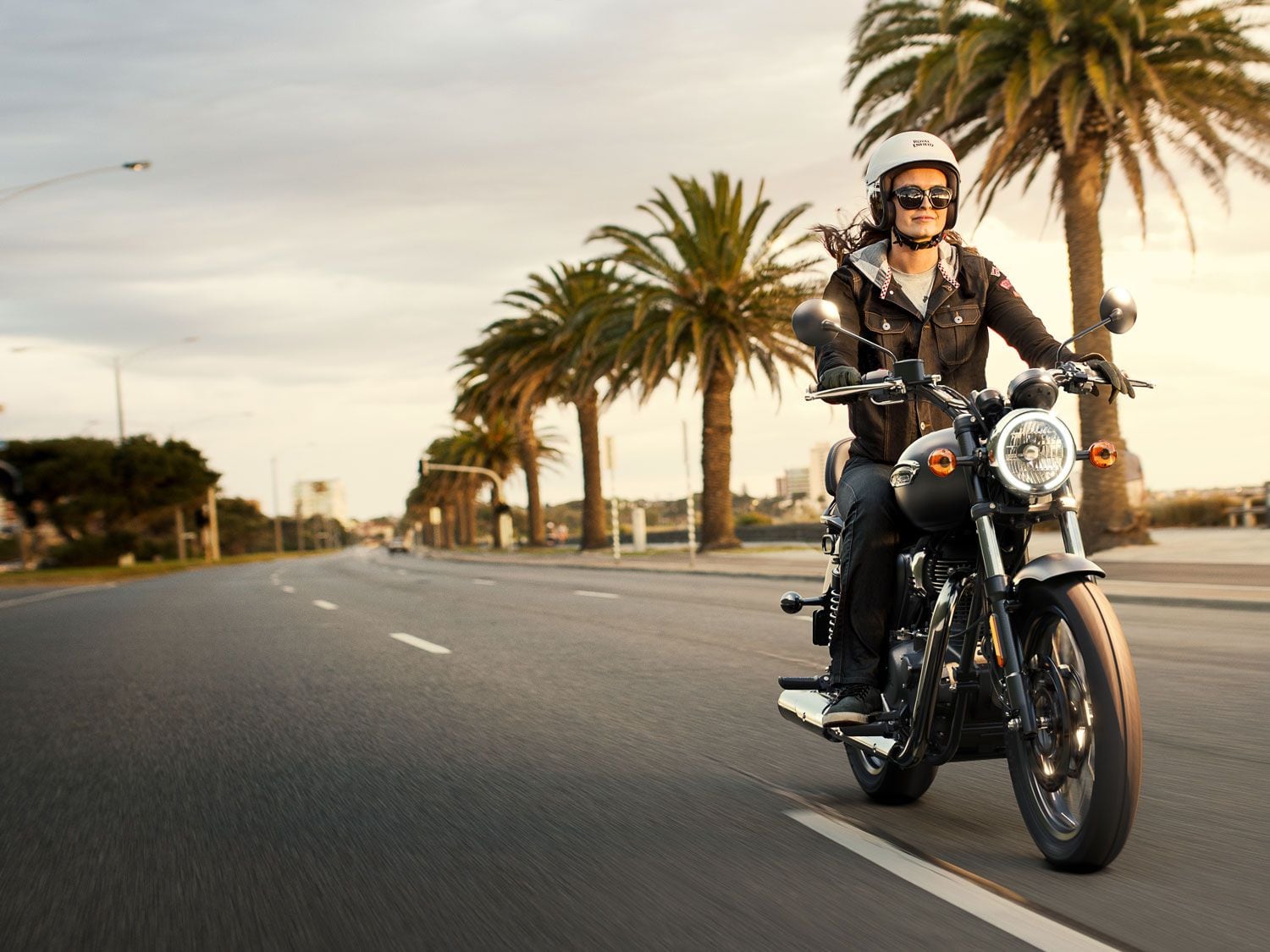

Outright horsepower may be lacking, but a flat torque curve and quick run to peak torque make up for it.
Outright horsepower may be lacking, but a flat torque curve and quick run to peak torque make up for it. (Royal Enfield/)
The mellow air-/oil-cooled single in the Meteor is exceptionally easy to come to grips with. Its 17.9 peak power and 18.2 lb.-ft. of torque are not staggering by any means, but peak torque is delivered at 2,800 rpm, and 90 percent of the engine’s torque is delivered at just 1,800 rpm. That immediate torque and flat torque curve make the Meteor 350 an easy bike to ride from stoplight to stoplight, with plenty of grunt to get off the line and have a little fun.
During freeway rides we noted a max speed of 70 to 75 mph, so the bike may struggle to keep up with faster traffic. Although it has a modest top speed, at least it doesn’t feel like it’s struggling; the balance shaft does a fantastic job eliminating most engine vibrations.

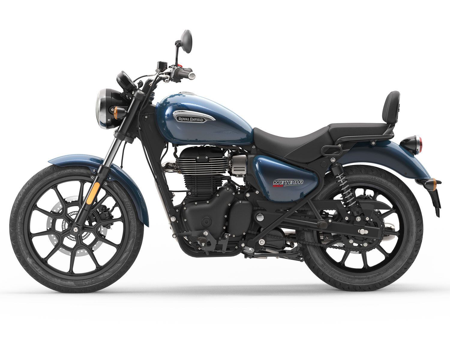

The Meteor is available in seven different colors including Stellar Blue, shown here.
The Meteor is available in seven different colors including Stellar Blue, shown here. (Royal Enfield/)

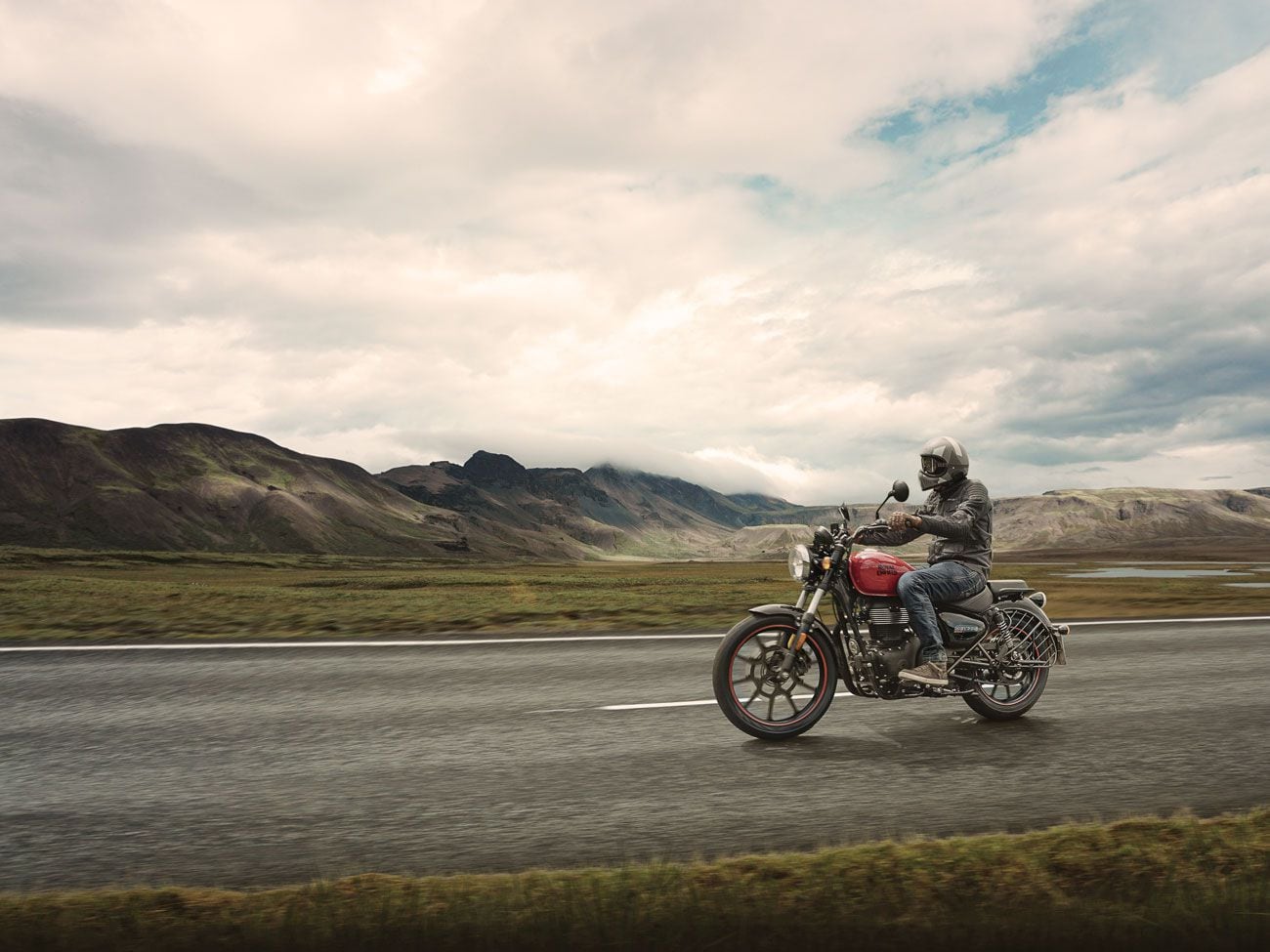

The bulbous tank is big, but does not intrude on the rider’s personal space.
The bulbous tank is big, but does not intrude on the rider’s personal space. (Royal Enfield/)
One area where the Meteor 350 stands out is comfort; the Royal Enfield feels more plush than Honda’s Rebel 300. The seat is wide and cushy and the riding triangle is more neutral. Reach to the bars is relaxed and the foot-forward peg position is casual. Seat height is also short-rider-friendly at 29.7 inches.
