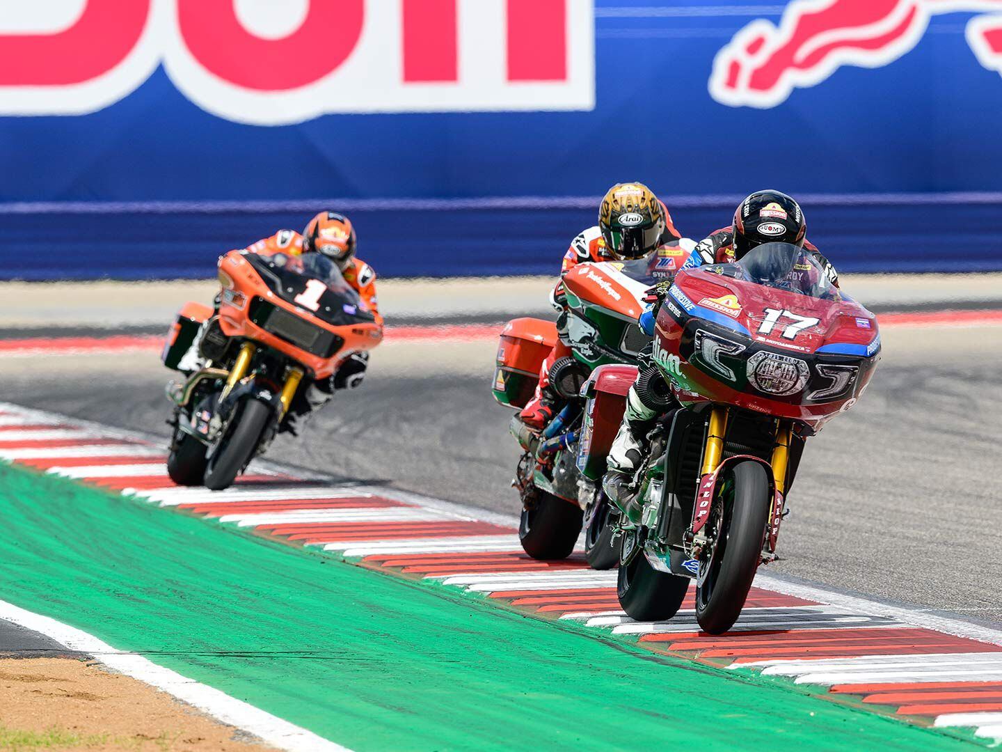

Troy Herfoss took the Race 1 win at COTA. King of the Baggers thrilled the MotoGP crowd—not an easy task with the machinery on hand.
Troy Herfoss took the Race 1 win at COTA. King of the Baggers thrilled the MotoGP crowd—not an easy task with the machinery on hand. (Indian Motorcycle/)

Never mind; that’s not a problem yet. We can see that Indian has a new swingarm, and has narrowed the forward engine hangers to prevent crashes caused by digging their previously wider edges into the pavement. That means the ability to corner at higher lean angles without either: a) disaster, or b) having to jack the bike up so high to reach those angles that the riders need 4-inch lifts in their boots to keep from falling over on the start grid.
CW Editor-in-Chief Mark Hoyer and I recently had a Zoom meeting with Dunlop engineer John Robinson, who revealed that the tires being used in the Baggers class are normal Superbike slicks—not something unique to the application.
There is some cost in making such tires carry bikes whose minimum weight is 620 pounds: Even though the Baggers races are very short (as early AMA Superbike races were) you can see riders tending to run wide in the second halves of these races.
That made it fascinating to watch Troy Herfoss in Race 1 at COTA, getting away from the start in lowly sixth, then moving up as the leaders’ tires began to look weak on their edges, leading to running wide. When Herfoss won, I thought of the tire strategy of Marco Lucchinelli in winning the 500 championship in 1981. He rode moderately, well behind the action at the front. When the leaders’ tires looked nicely toasted, he eased past them all, having conserved his own rubber.

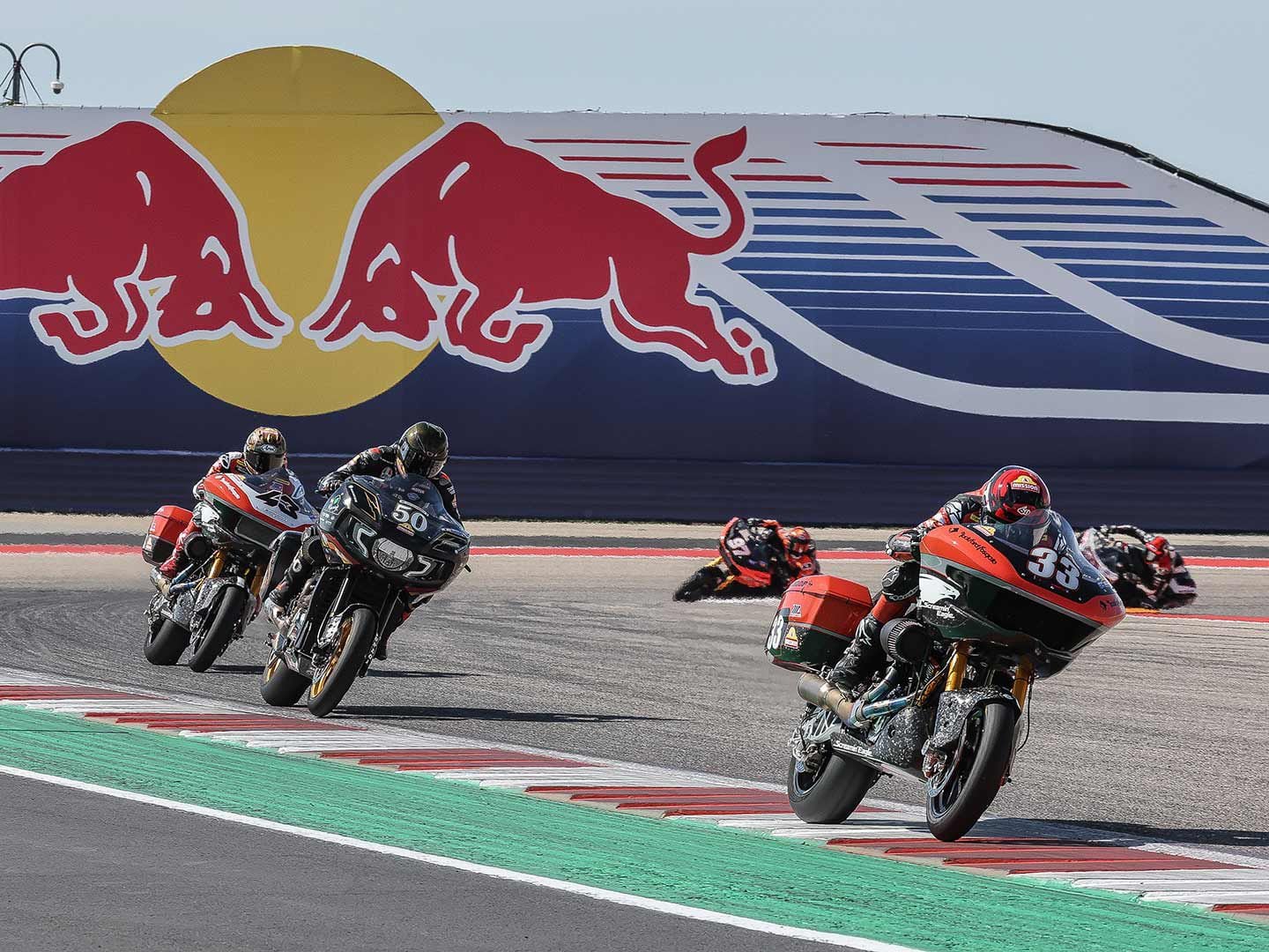

But then in Race 2 Herfoss’s combination just wasn’t fast enough. Kyle Wyman led him at the finish by 0.6 second on Harley-Davidson, laying down a 2:14.890 lap in the process.
Kyle Wyman took the second race at COTA, finishing 0.6 second ahead of the field.
Kyle Wyman took the second race at COTA, finishing 0.6 second ahead of the field. (Harley-Davidson/)
