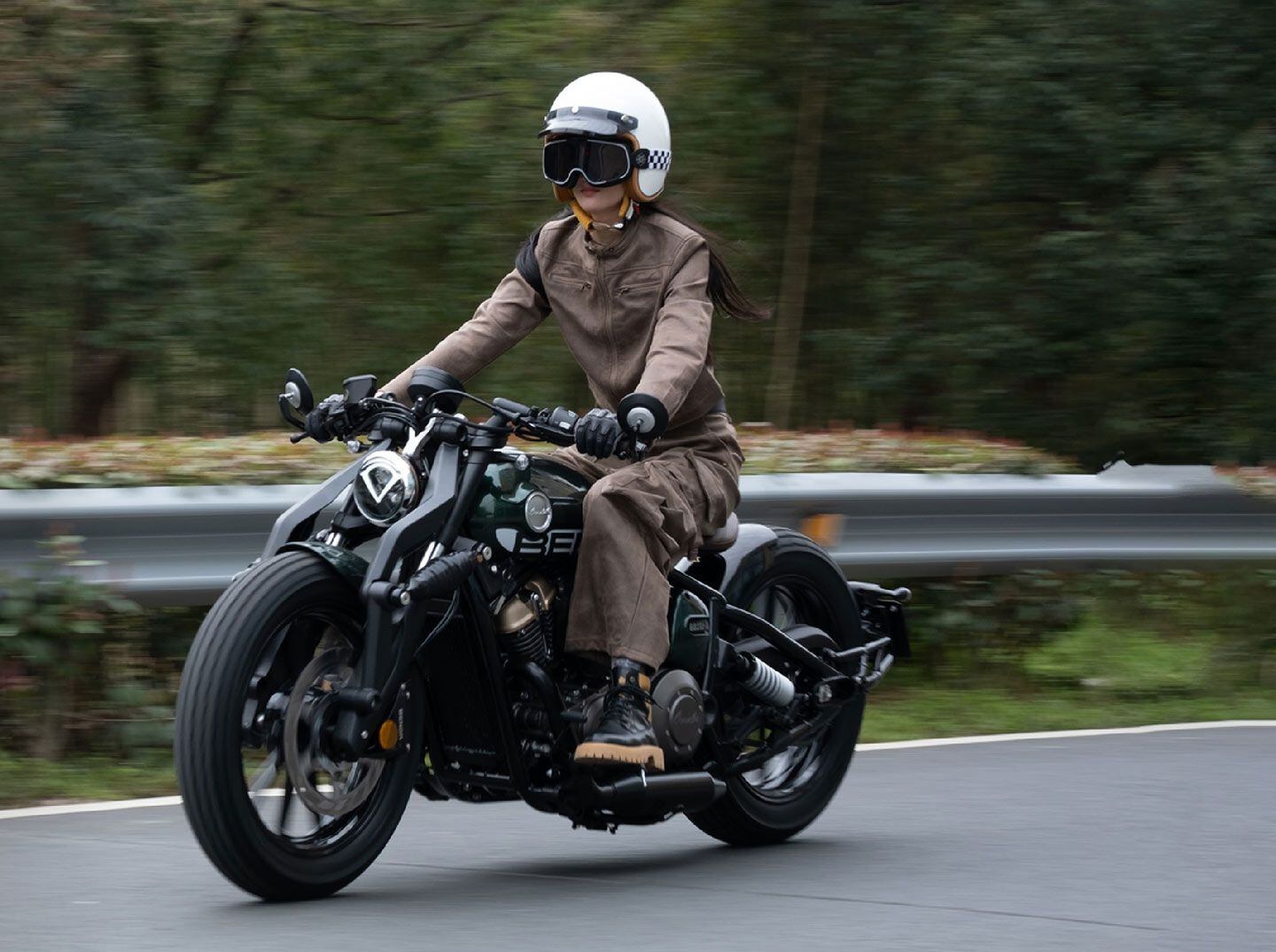

The front end is particularly unusual. At first glance it looks like a girder fork design with unusual, side-mounted springs hidden inside rubber gaiters, but the reality is even stranger than that. As we pointed out in our original story, there is a conventional-looking fork hiding behind those girders, which hinted that they could be dummy units. That’s not as outlandish an idea as it seems, because Benda’s larger Napoleon 500 cruiser already uses fork covers to give the appearance of a girder front end.

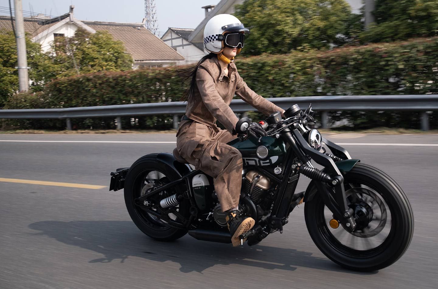

But the Napoleon 250′s solution is even stranger. Yes, there is a conventional fork in there, but those additional cast aluminum components in front of them also appear to serve a purpose. Far from being solid girders, they’re really hinged linkages with pivots at the top and bottom ends and a knee-style joint in the middle where the ends of that gaiter-clad shock units bolt to them. That means as the forks compress, the “knees” in those front links bend, stretching rather than compressing those shocks.
A side view of the front end.
A side view of the front end. (Benda/)
Benda hasn’t gone into detail about their operation, but it looks like the main springing and damping is done by the conventional fork, and those extra units on each side are supplementary dampers. Benda says they’re adjustable too, via the gold-colored screws on their upper ends. Will the result be better than conventional adjustable forks? It’s unlikely, but the system adds an element of interest that would otherwise be missing, and at least it’s a real, mechanical component rather than simply a cosmetic affectation.
