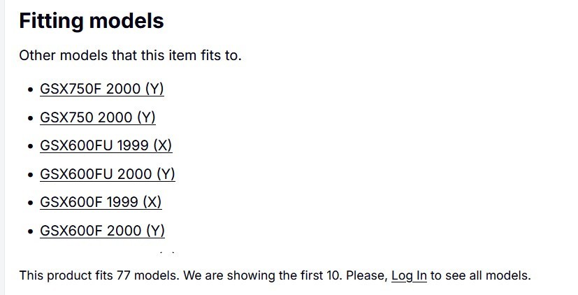

V650 Posted Thursday at 09:08 Posted Thursday at 09:08 (edited) Part number Part number:3772020C00 If the worst comes to worst and you have to buy new https://www.kfm-motorraeder.de/en/item/suzuki-3772020C00000 but €77  With part no you might have some luck searching https://www.cmsnl.com/suzuki-gsx750-1998-w-e02-e04-e17-e18-e22-e25-e34_model13723/base-assy-gear-shift-terminal_3772020c00/ According to CSMNL also fits   Edited Thursday at 09:12 by V650 1 Quote
