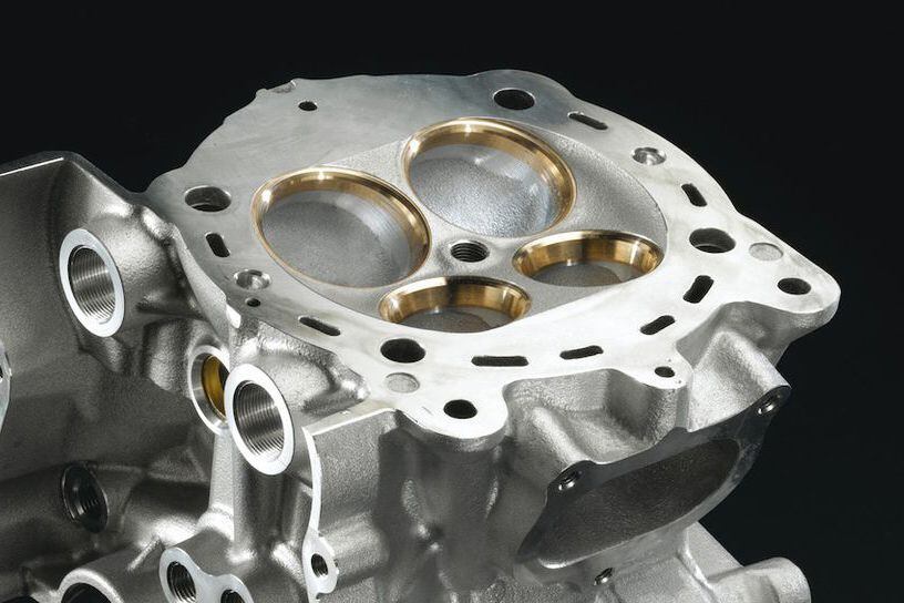

As processes for extracting and alloying aluminum improved, the light metal was the obvious next choice. But being soft, it was pounded out of dimension by valves seating against it. It would be necessary to somehow fix hard metal rings into the soft aluminum, against which the valves could seat.
Aluminum cylinder heads need a hard material for the valves to seat against—here gold-colored oversize beryllium copper valve-seat rings are employed for use with titanium valves.
Aluminum cylinder heads need a hard material for the valves to seat against—here gold-colored oversize beryllium copper valve-seat rings are employed for use with titanium valves. (Ducati/)
Inserted valve-seat rings worked acceptably in water-cooled auto and aircraft engines with aluminum heads, but early aluminum alloys lost strength rapidly when heated above 350 degrees Fahrenheit in air-cooled applications. Seat rings loosened, and valve motion only made that worse. People tried casting the seats in the aluminum, screwing them in, placing the seats into a close-fitting counterbore, and then staking them in place by swaging the aluminum over them. They heated the heads, froze the seats, and brought the two together to result in a satisfyingly tight fit. Sorry—even such well-executed shrink fits lost their grip once the aluminum head became hot and grew weak.
