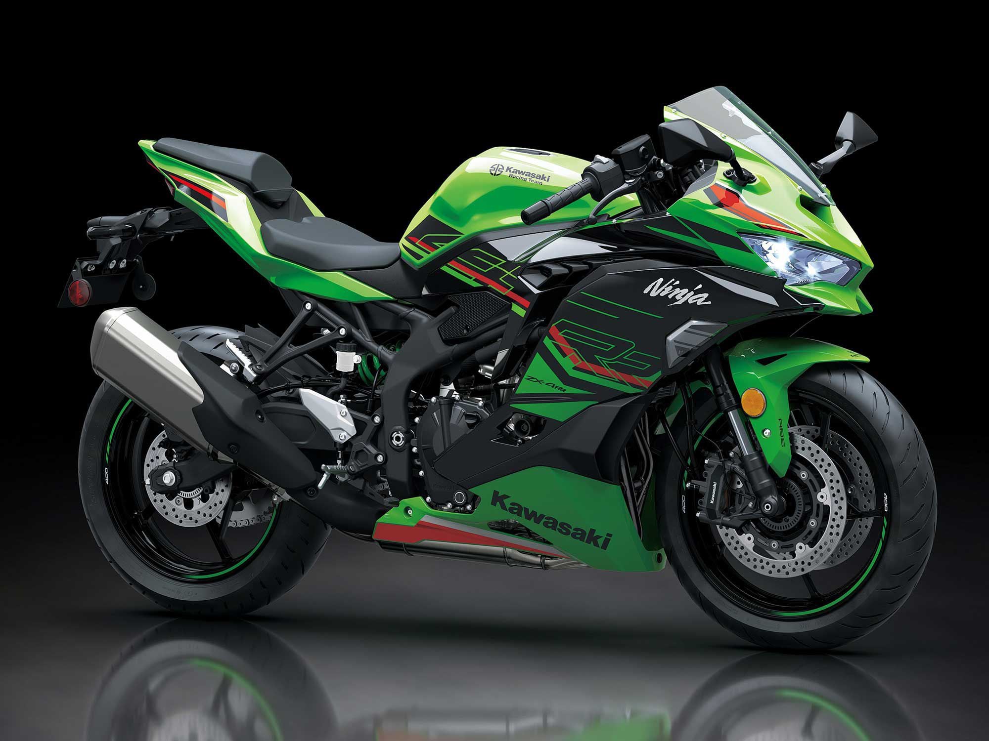

Kawasaki brings the 400cc supersport back to the US with the introduction of the ZX-4RR KRT Edition.
Kawasaki brings the 400cc supersport back to the US with the introduction of the ZX-4RR KRT Edition. (Kawasaki/)

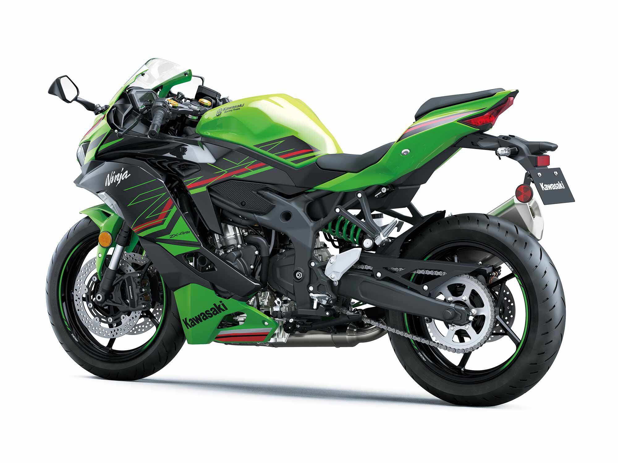

Pipeside studio view.
Pipeside studio view. (Kawasaki/)

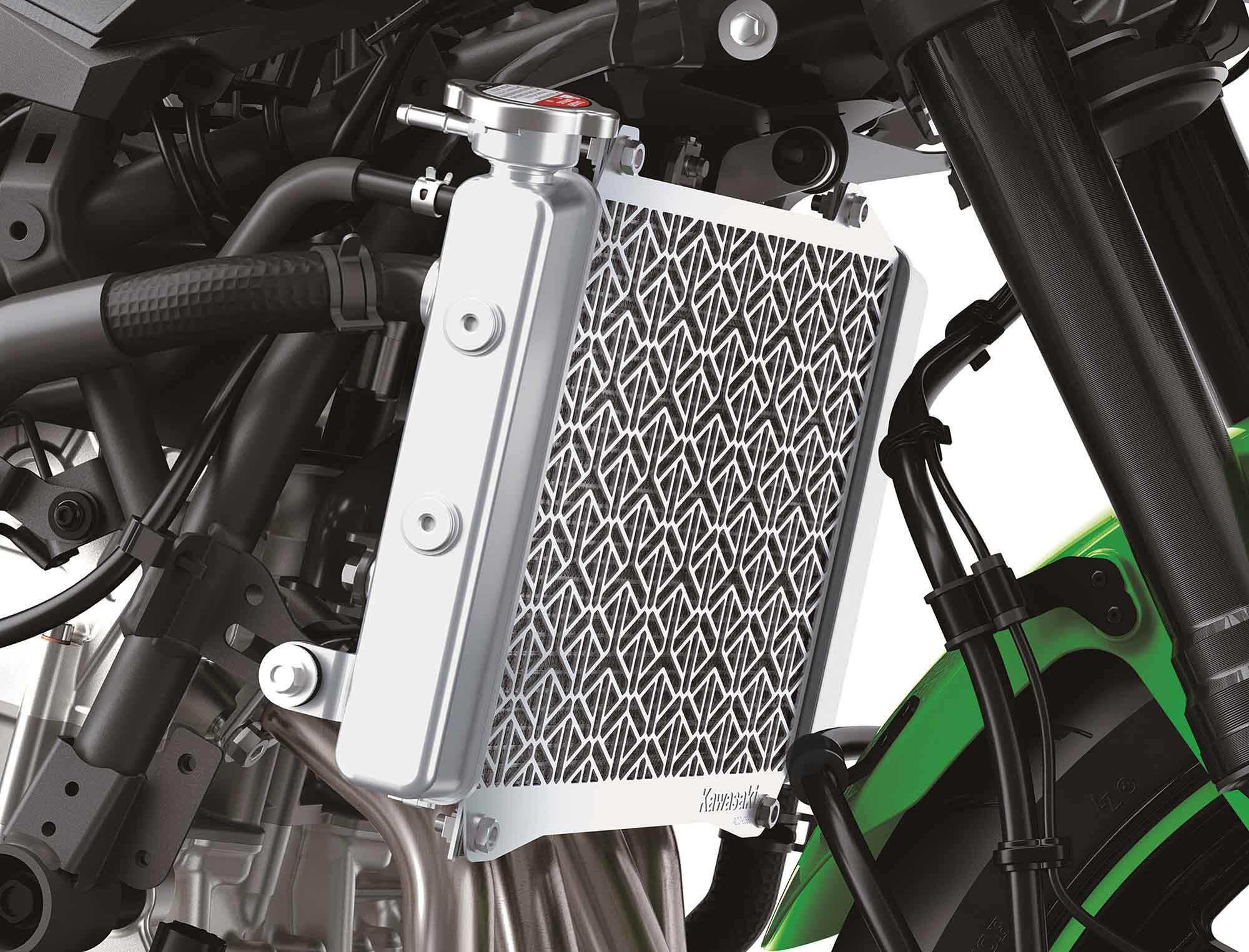

A 30-row radiator keeps the engine cool.
A 30-row radiator keeps the engine cool. (Kawasaki/)
Ultra-lightweight cast-aluminum pistons have a molybdenum coating on the skirts for durability, while a reasonable 12.6:1 compression ratio ensures regular gasoline can be used (for reference, the 1990 model’s compression ratio was 12.1:1). Pistons slide in die-cast aluminum cylinders with an open deck design. The connecting rods have a carburizing treatment to help improve durability, while the crankshaft’s light flywheel mass contributes to the engine’s quick-revving nature.

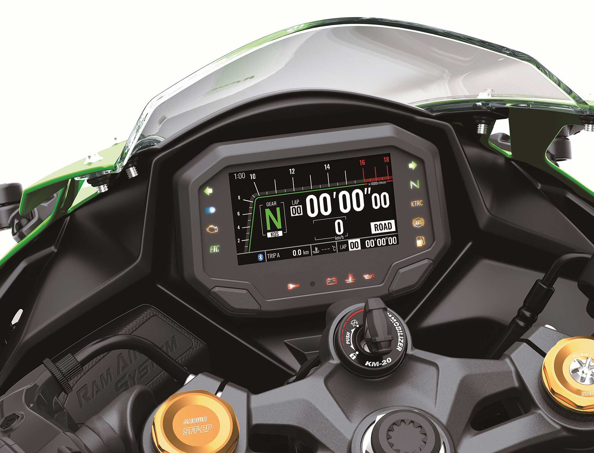

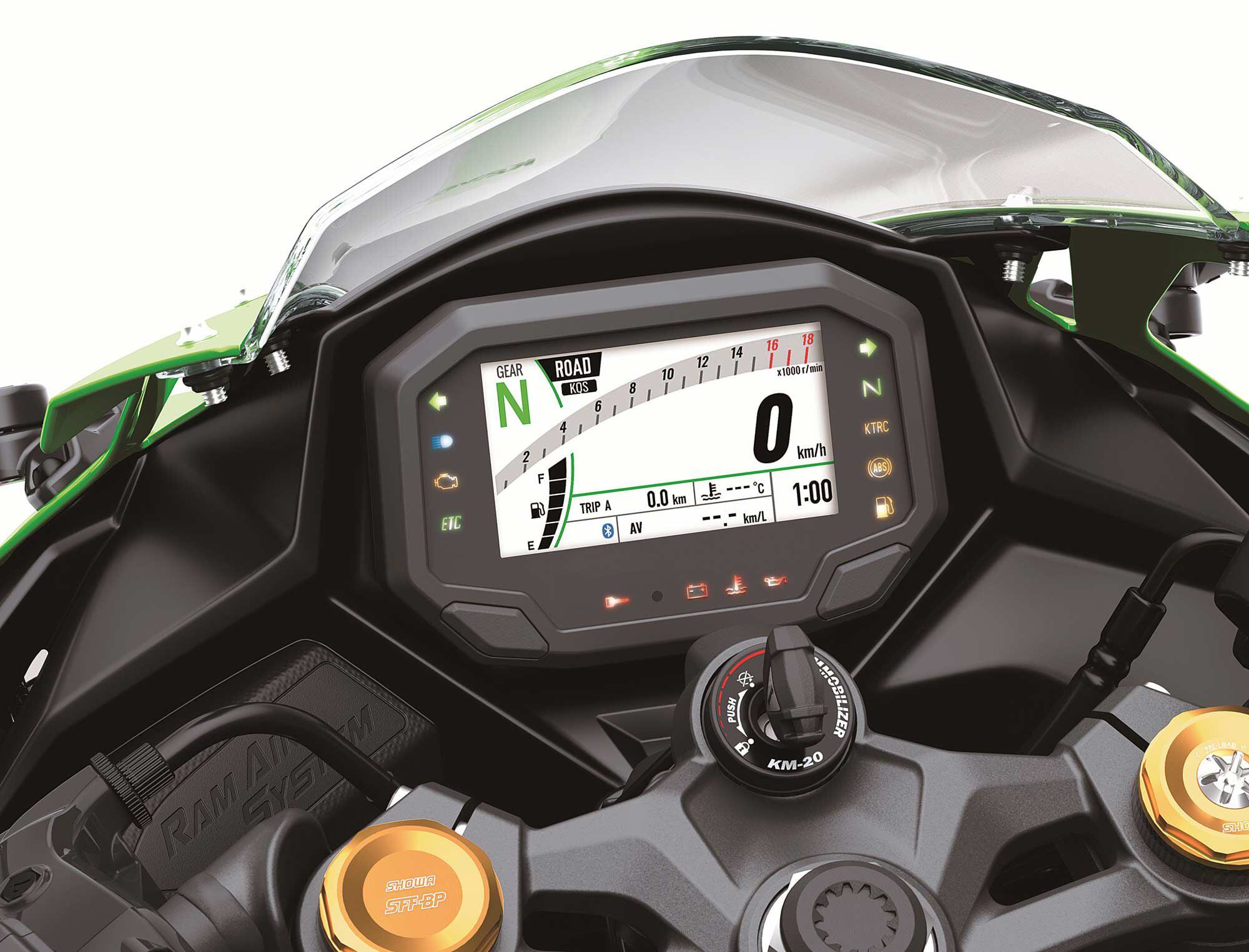

The 4.3 inch TFT display in standard street mode.
The 4.3 inch TFT display in standard street mode. (Kawasaki/)
At the center of the system are the Integrated Riding Modes with four options including Sport, Road, Rain, and Rider (the latter of which allows manual selection of the parameters). The first three options have optimized settings for different types of riding, while the Rider mode allows the user to choose between three levels of intervention on the Kawasaki Traction Control (KTRC), and between two power modes: Full or Low with milder response. The TC can also be turned off completely. As mentioned above, the ZX-4RR comes with an up and down quickshifter as standard.
Circuit mode provides only the info needed for track riding.
Circuit mode provides only the info needed for track riding. (Kawasaki/)
The rider interface to access all of these settings is anchored by a 4.3-inch full-color TFT display. Multiple screen modes can be selected, including a circuit mode that prominently displays track-related information such as the lap timer, tach, and gear-position indicator. The display can also be customized with dark or light themes and the brightness level is automatically adjusted based on ambient lighting conditions. Using Rideology The App, the rider can link their smartphone to the bike and access various vehicle info, a riding log, mobile phone notices and customize settings to preference.

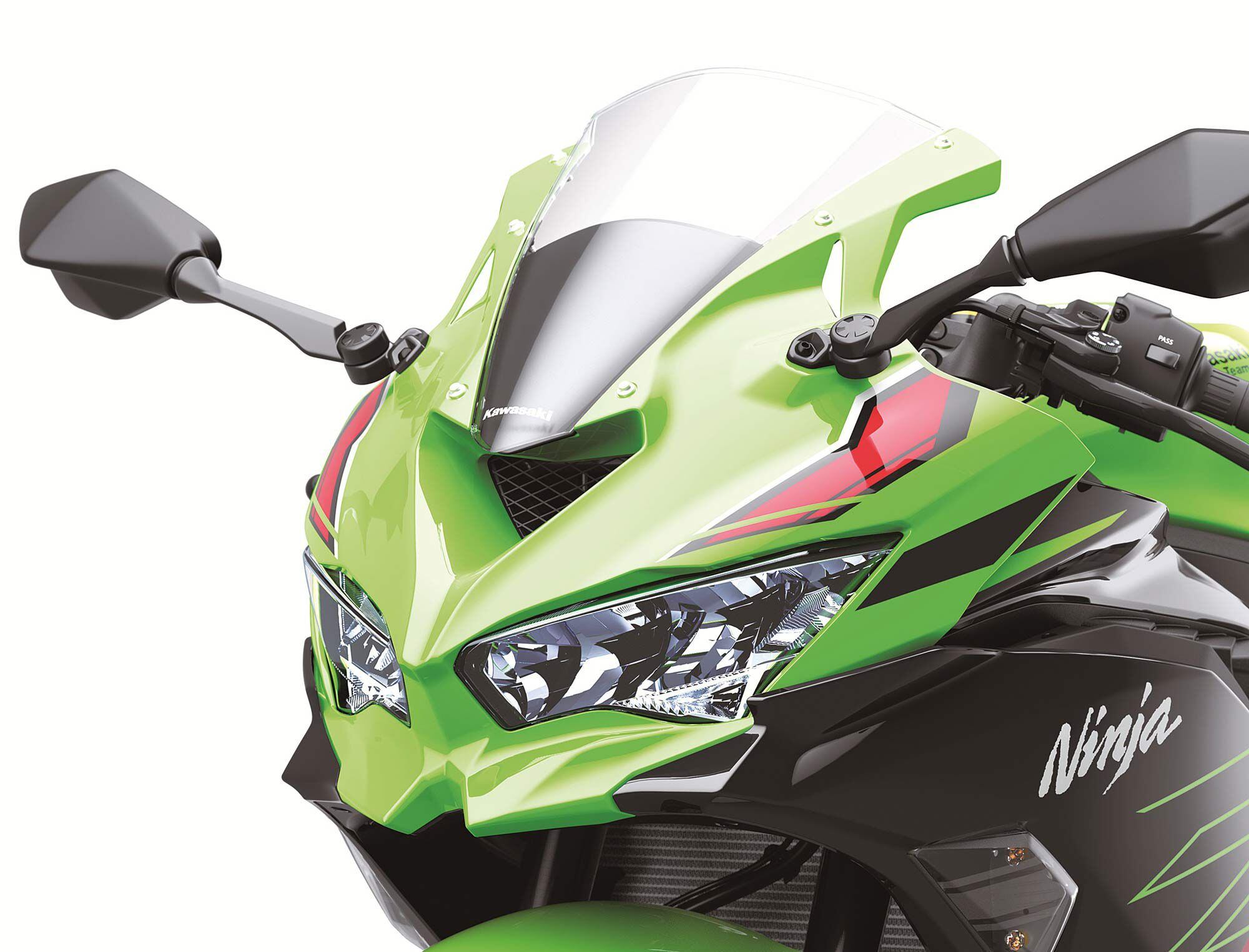

LED headlights are used up front.
LED headlights are used up front. (Kawasaki/)

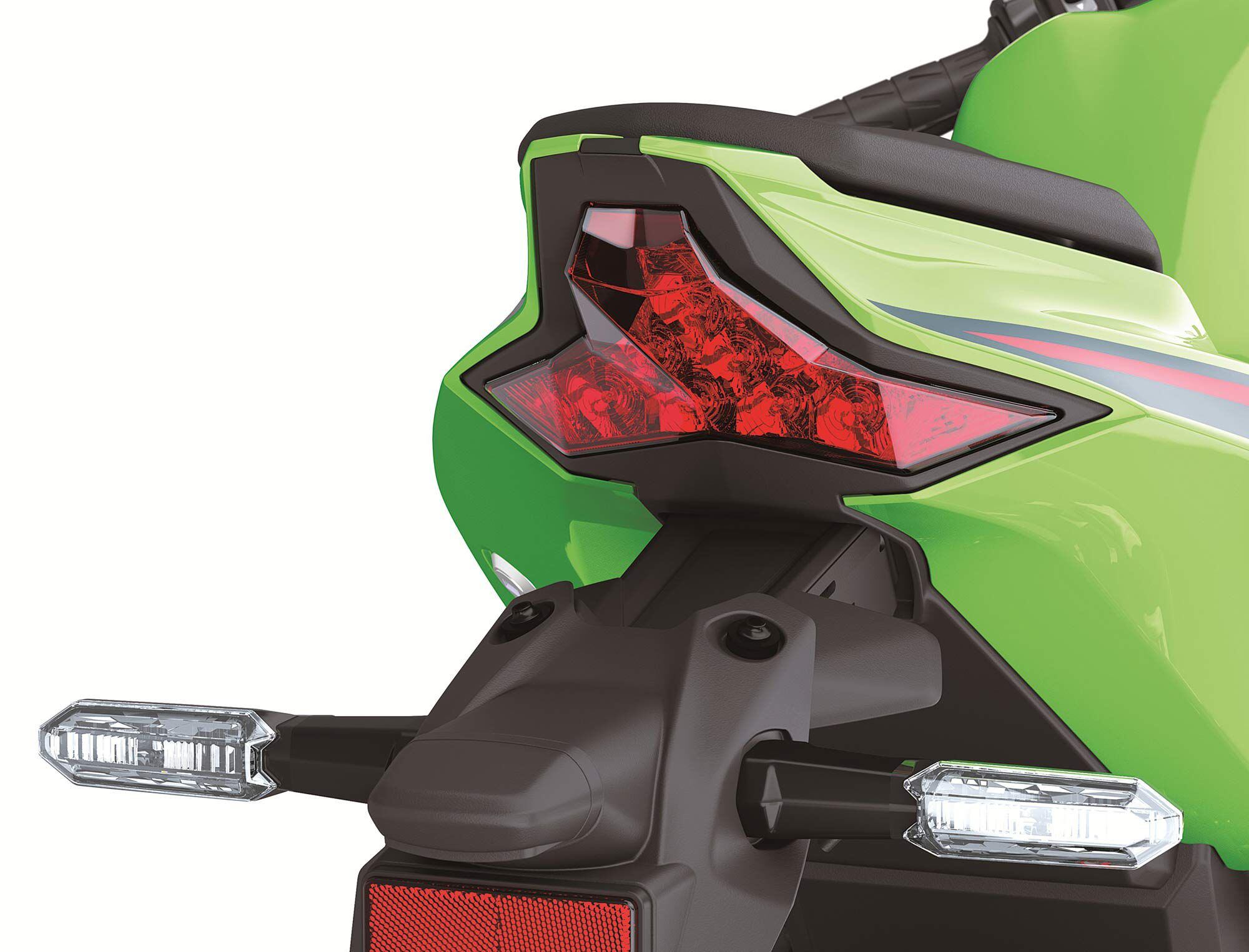

The ZX-4RR features twin LED headlights and taillight, while the front LED turn indicators are integrated into the front lower fairings’ leading edge. Slim LED turn signals are mounted to the license-plate bracket at the rear.
An LED taillight and LED turn signals are used at the rear.
An LED taillight and LED turn signals are used at the rear. (Kawasaki/)

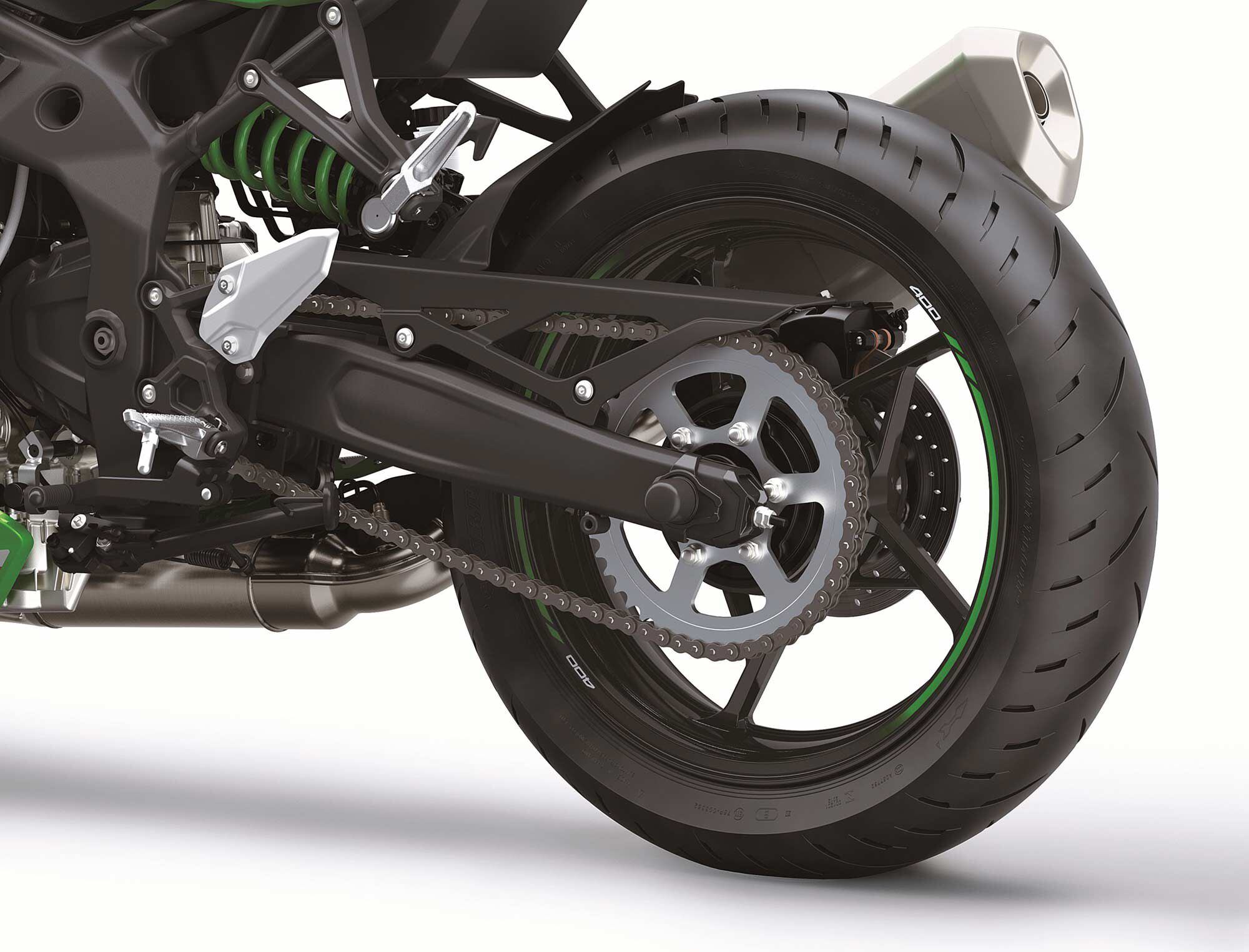

While those trick 400s of old brought stout aluminum perimeter frames to the public (they’d previously only been used in Grand Prix racing), the new ZX-4RR uses a cost-effective steel-trellis frame and a steel banana-style swingarm. Looking at the spec chart, we see that the wheelbase measures 54.3 inches, which happens to be identical to the Asian-market Kawasaki ZX-25R, that this 4RR is largely based on. Front-end geometry has 23.5-degrees of rake and 3.8 inches of trail, which are actually a bit more aggressive than the 250′s and in fact quite similar to the quick-steering 400s of old. Claimed wet weight is 415 pounds, so expect about 391 when weight of the 4.0 gallons of fuel is subtracted. As always, we’ll get you the real number on the CW scale when we get a testbike.
Stripped of its bodywork, you can see the steel-trellis frame and steel banana-style swingarm.
Stripped of its bodywork, you can see the steel-trellis frame and steel banana-style swingarm. (Kawasaki/)

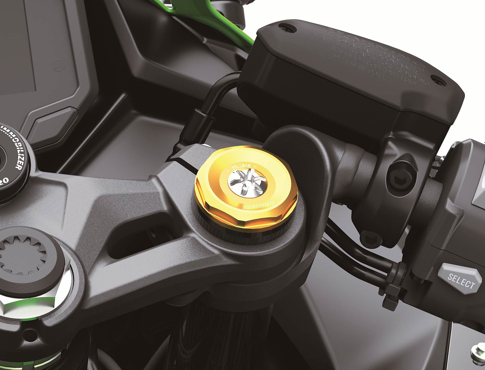

Like the ZX-25R, the ZX-4RR utilizes a 37mm inverted Showa SFF-BP (Separate Function Fork-Big Piston) fork with provision for spring preload adjustment. The advantages of this fork are that a larger-diameter damping piston is used compared to a cartridge-style fork. This reduces damping pressure which allows the stanchions to move more freely. The rear suspension features a horizontal back-link mounted Showa BFRC (Balance Free Rear Cushion) Lite shock. The position of the shock and link is above the swingarm which also gets it out of the way of engine and exhaust heat. The shock has provisions for preload, compression and rebound damping adjustment.

Five-spoke aluminum-alloy wheels are mounted with Dunlop Sportmax GPR-300 tires in 120/70-17 front and 160/60-17 rear sizes.

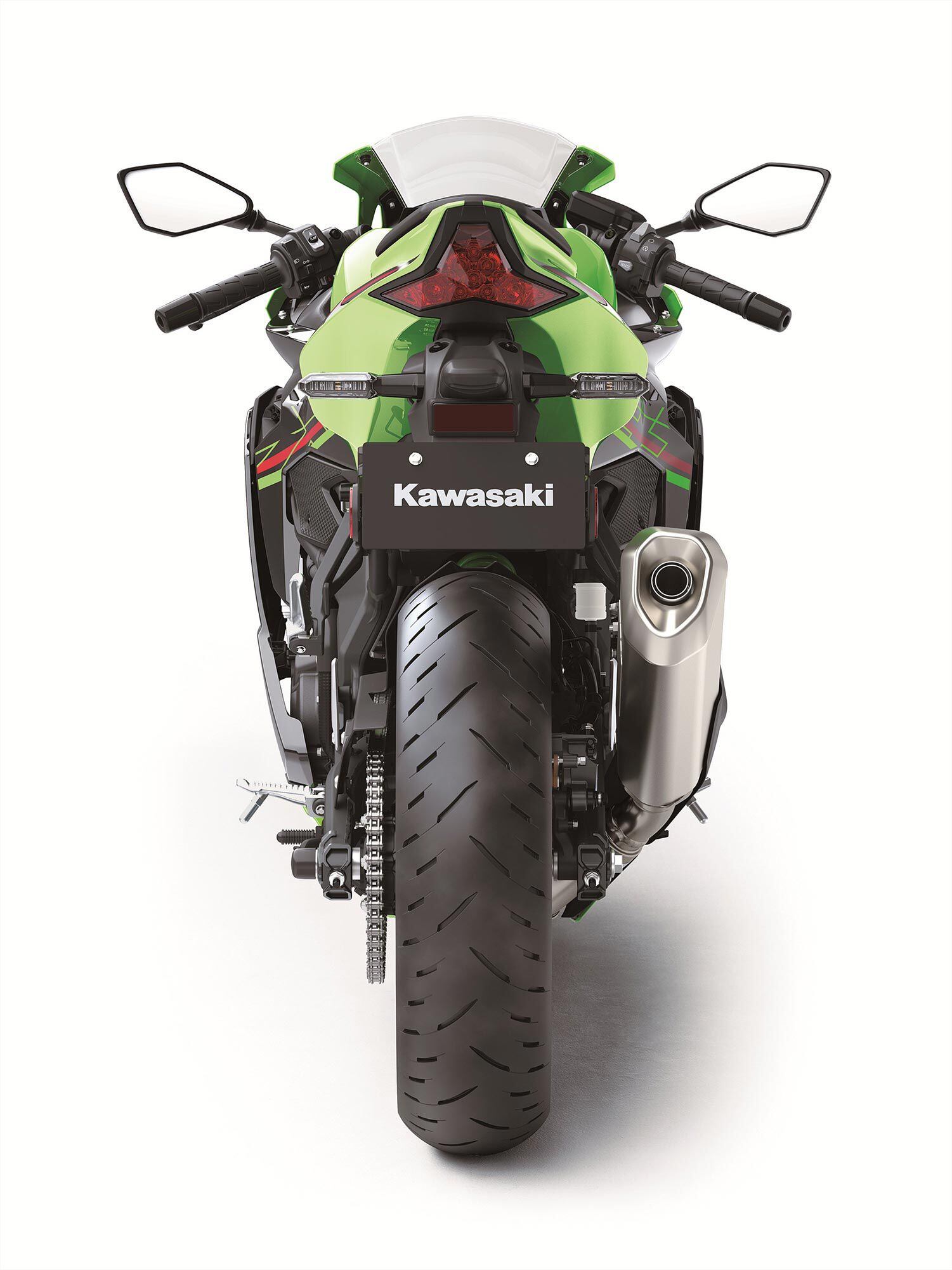

2023 Kawasaki ZX-4RR KRT Edition rear view.

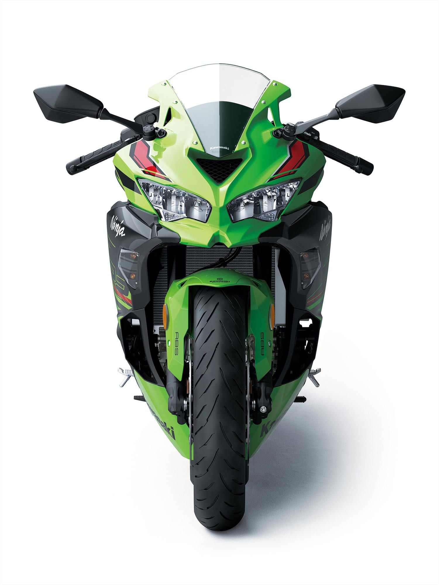

2023 Kawasaki ZX-4RR KRT Edition rear view. (Kawasaki/)2023 Kawasaki ZX-4RR KRT Edition front view.
2023 Kawasaki ZX-4RR KRT Edition front view. (Kawasaki/)2023 Kawasaki ZX-4RR KRT Edition left side.

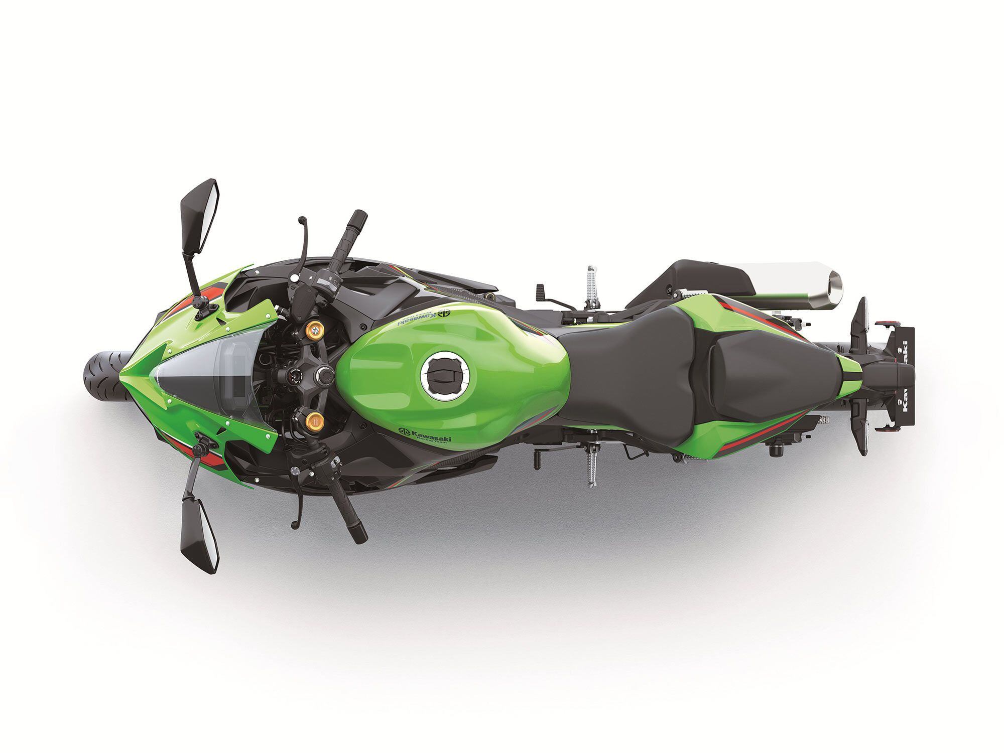

2023 Kawasaki ZX-4RR KRT Edition left side. (Kawasaki/)2023 Kawasaki ZX-4RR KRT Edition top view.
2023 Kawasaki ZX-4RR KRT Edition top view. (Kawasaki/)2023 Kawasaki ZX-4RR KRT Edition, Showa SFF-BP fork.

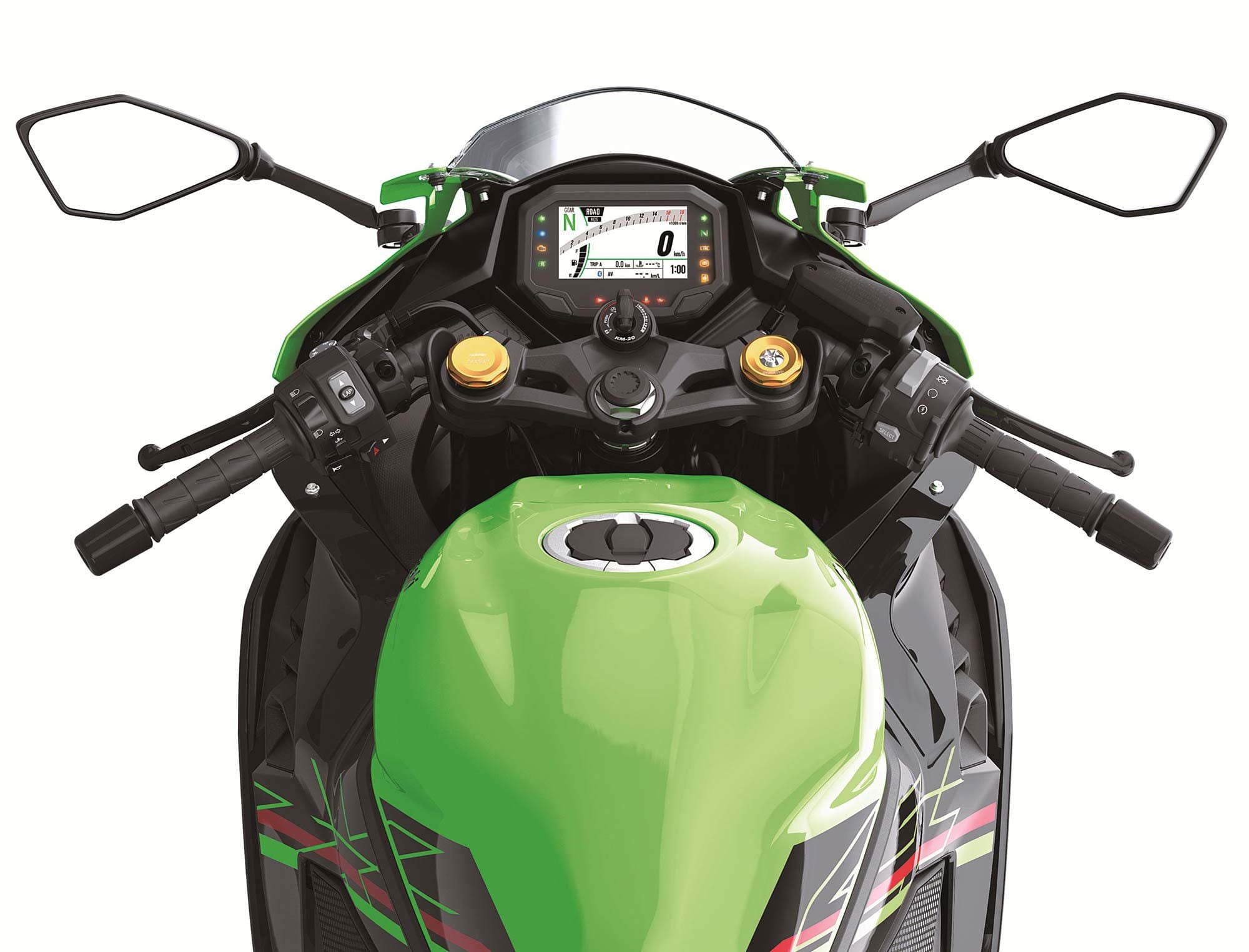

2023 Kawasaki ZX-4RR KRT Edition, Showa SFF-BP fork. (Kawasaki/)2023 Kawasaki ZX-4RR KRT Edition cockpit view.
2023 Kawasaki ZX-4RR KRT Edition cockpit view. (Kawasaki/)
