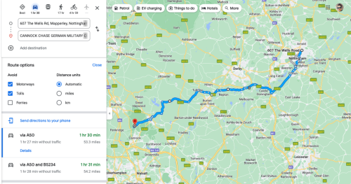

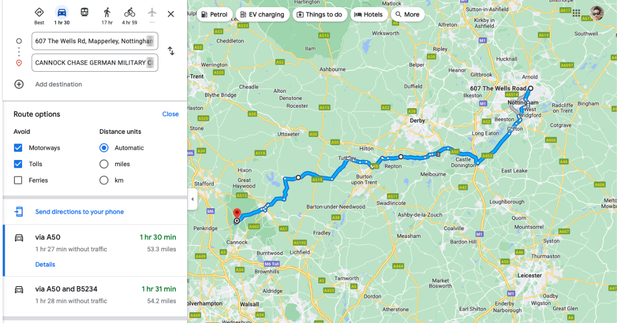

Ive never used my maps. as far as I can tell its an unnecessary complication.
create a route on normal google maps. then once you are happy with it.

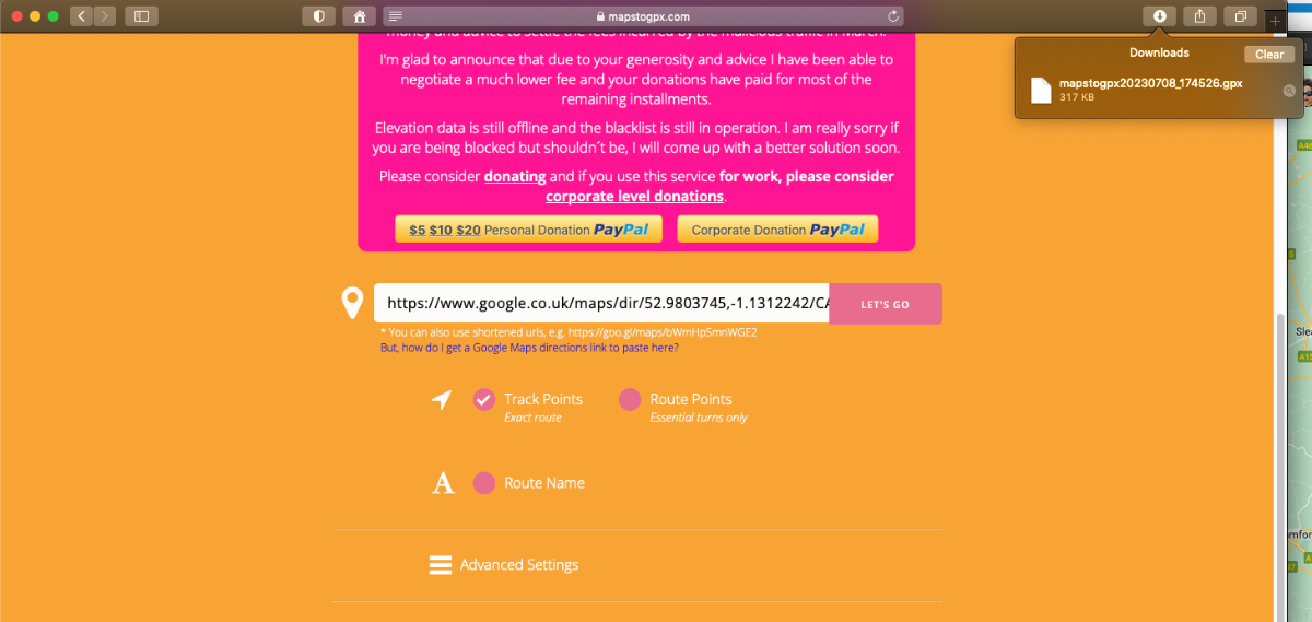

go to this page.   https://mapstogpx.com
paste the link from the created route which might look like this: https://www.google.co.uk/maps/dir/52.9803745,-1.1312242/CANNOCK+CHASE+GERMAN+MILITARY…/@52.7860783,-2.1590124,9.11z/data=!4m26!4m25!1m15!3m4!1m2!1d-1.5268618!2d52.8560031!3s0x4879f9e7a46872bd:0x5186e4c318e74680!3m4!1m2!1d-1.6786866!2d52.8527749!3s0x487a03382639acd3:0xbc6b9ed6ab0322a9!3m4!1m2!1d-1.8369623!2d52.8182575!3s0x487a0fa121402bdd:0x62d710b469ec62e!1m5!1m1!1s0x487a74c32ea11957:0x552b6e589a5ba230!2m2!1d-2.0219759!2d52.7394494!2m1!1b1!3e0?entry=ttu
press "Lets go" and it will create a GPX and send it to downloads.
like this:
you can then either open this using basecamp and convert it to a route. or perhaps use the unit itself. most can do this, my 660 could and so can my current XT.

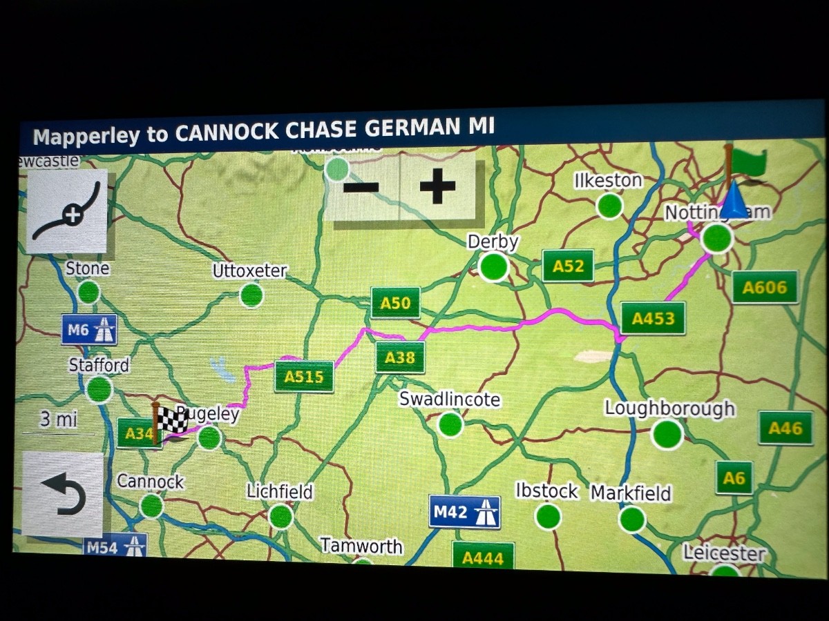

Google maps.
and a route created by converting the GPX by the unit itself. ready to go.

I find normal google maps much easier to use. you can set up the avoidances. then create a simple A to B route.. and then move it. so, for my example I use the main roads to begin with, then pushed it off the A50 and went through smaller villages towards cannock chase. I could easily have zoomed in further and refined the route much more. so simple to do with normal google maps. I tried 'my maps' once and didn't click with it. I don't ever save routes, once Ive used them I delete and next time create something a bit different. or even take a look using street view. do I really want to use that road? yes/no.
