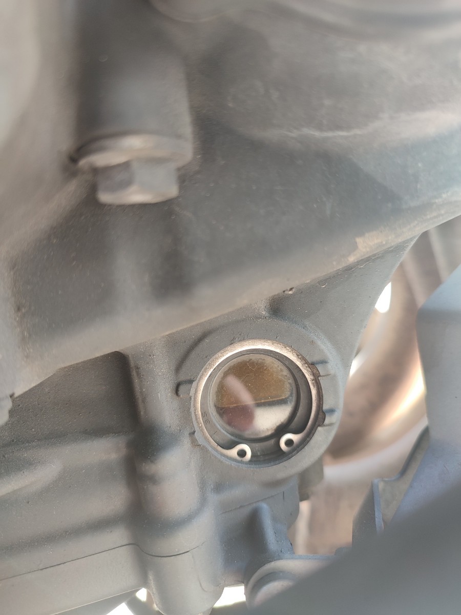

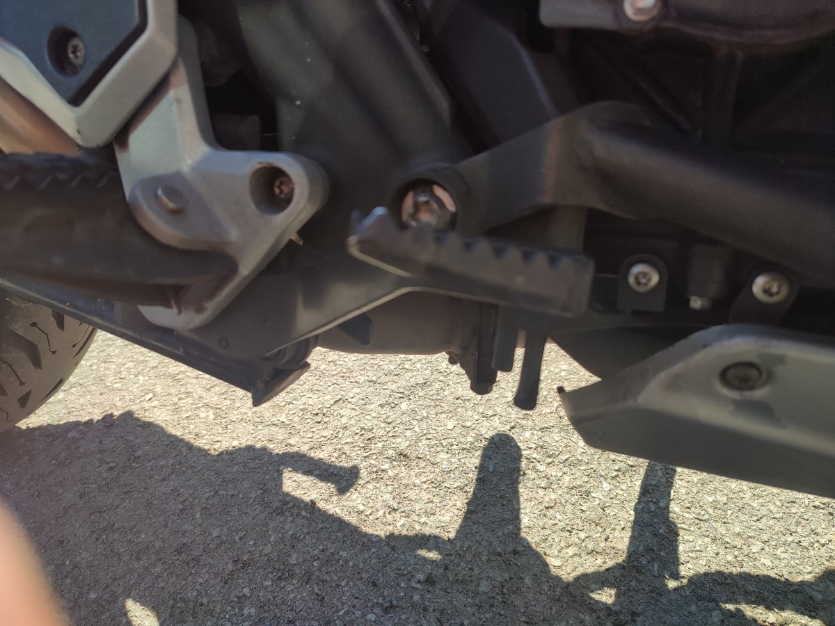

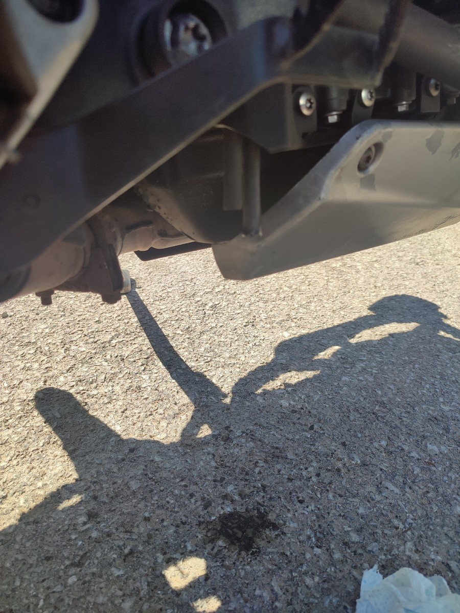

Parked up at 08:30. Went out at 13:00 to check on the bike to find drips of oil or oily water from the breather hose.
Is this anything to be concerned about? Is it to do with the hot weather?
The oil level is at the top of the two lines.

Come to think of it, the oil is not that high.. Maybe something to keep an eye on. Haven't noticed it losing power and can't see any smoke.
It's more than likely coming from the air box
The crank case breather goes into the air box then will drain out to that pipe
Pretty normal and with higher mileage you will get more pressure in the crank case which will push a bit more oil out
Might be worth stripping and cleaning the air box

Yes a little bit is ok, especially when it seems to do it after a stop for a while. If there is lots and all the time then that’s not good.
check the inside of the air box and filter, if there is very slight misting/fine coat then ok but keep an eye on it. Also now keep an eye on the engine oil level and its condition, that can give clues too.

It's usually oily water from the airbox so my guess is that the hot weather has simply allowed some accumulated crap to be vented. If you're worried leave a small container under the hose when you park the bike. The mark shown would be caused by a very small amount of liquid.

if you notice more than a few drops (if your a old British bike or ktm owner it needs to more than a weep) half or more than espresso cup worth often after a stop needs investigation.
