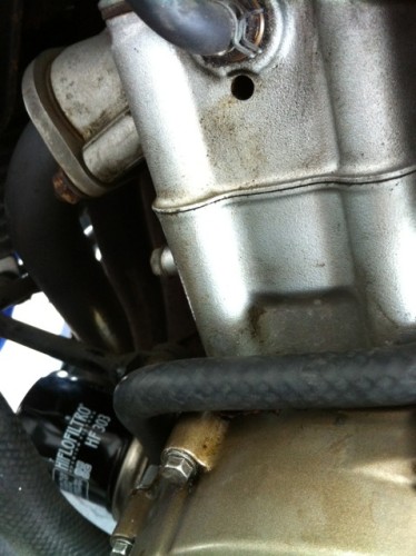

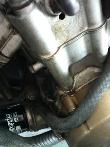

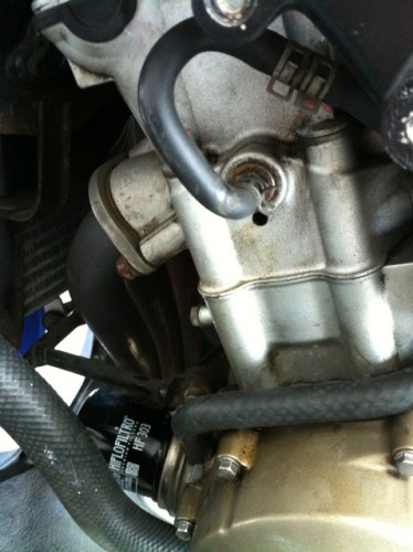

  1. Ok so now been back the track and appear to have found where my oil is coming from... And it was one of the places i thought; that small hole anybody i ask has no clue what it is therefor. However one person said it could be a Tell-tale hole - meaning it lets u know u have a broken seal inside, and its there as a breather hole and a warning. Here are some pics: As you can see it is weeping out of this random hole...but this weeping can become a dribble quickly and land on my back tyre. needs sorting! would anyone have anymore info or ideas on this? Thanks

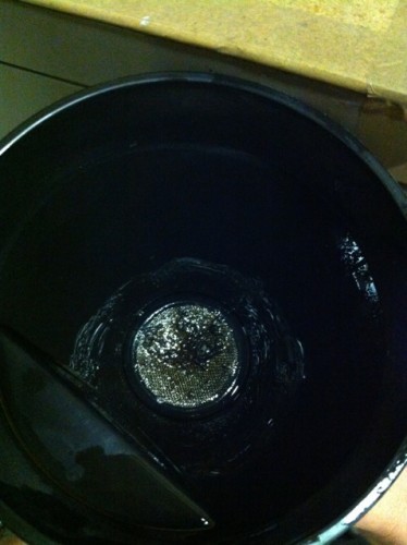

    This sounds daft i know but its going to have to be a gamble I leave to go the track tomorrow and i am in work all day, i have no time. It ran ok last time and has been running and revving fine to a high temp so friday should be ok (famius last words!) and better now it has fresh oil in her! Here is some pics now... This looks worse than it actually is: here she is the bamn b*tch! i love her really!

    Ok home and spending more time looking at the 'metal' material. it looks a bit more like graphite colour dark silver and crumbles if i crush it in my fingers going to try run a current though a piece now as a magnet has no affect. I forgot to mention or only just thought i did replace the rocker gasket myself but again i was very careful clearing the areas of old gasket and glue but perhaps some fell in..? i hope it was just that and nothing serious. Thanks!

    Thank you, the alternator casing is still solid i gave it a good check when replacing the gasket and the new gasket has sealed well (inc gasket glue) as i have ran it to a high temp since. The rotor i am assuming is the coil covered electromagnet that spins inside the casing, as this seemed all fine and the cogs connecting it to spin. I am not sure what a Stator is or where the insulation lacquer would be applied. forgive me if am chatting jibberish I am not a mechanic however i pick it up realy quick and am not scared to do it myself. again sorry but which is the oil sieve? (where the filter screws on?) If i need to do this would it be ok to drain then filter the oil and put it back in as i have only just changed it. thanks!

    My sump plug doesnt have a magnet on the end, and i just got a new plug (bolt) and a new washer when changing the oil. I did try a magnet myself with the shards and they dont attract, so this must be a little bit of good news judging by what you have said? I have recently changed my alternator gasket as at the track i lost a little oil but couldn't see where from and the casing has slight wear/corrosion on the exterior part where it meets the gasket so did it for safe messure. Possibly when scrapping the casing to ensure it was smooth from any old gasket or glue i have created little shards that could have fell in although i know i was careful and tryed to clear out any bits i may have made by flushing it out with a little oil(clean) before applying the new gasket and fitting it. To give you the full story to why i am worrying more so... i posted another topic (http://www.themotorbikeforum.co.uk/viewtopic.php?f=5&t=44299) not long after my track day about losing a bit of oil and the fact the bike lost power (like petrol starvation) but after shutting of throttle and back on it was fine.... it has ran and ticked over fine since then with no unusual noises. thanks for taking the time to read all this. Rob

    Fearing the worst but i will be honest i should have done another change before now I think. got the bike (zx6r '99) in spring 2010 with a recent oil change (i had to drain some out as was over filled) a year later i then did another change with stuff from hein gerick (semi 10w40 i assume). The bike had a busy year last year I think about 5k miles and then i went to a track day at the beginning of this year, i have now changed the oil now to Motul 5100 (better) and a better filter. However upon changing the oil i found small bits of metal (silver) and more importantly little shards of metal (no longer than 5mm, very thin, and no wider than 2mm) so they are small! I read the metal dust can clump and it being silver bits is better than it being gold, and that small shavings are not that uncommon but u can imagine my concern. i will post some pics ASAP and going to cut open my old filter tonight and have a look there, the bike seems to run and tick over fine with no knocking or odd noises etc. worried.com!

  22. nope there is no airbox drains around there, i have seen that happen on my friends R6 and thought it was oil I did run it to above standard temp and gave it a good rev but nothing, to be honest its a bit risky taking it back the track to find a oil leak while razzing around The oil level is fine smack in the middle of the min and max. I think i will change the Alternator cover gasket never the less, its not a big job and i have a load of gasket paper and glue. thanks
