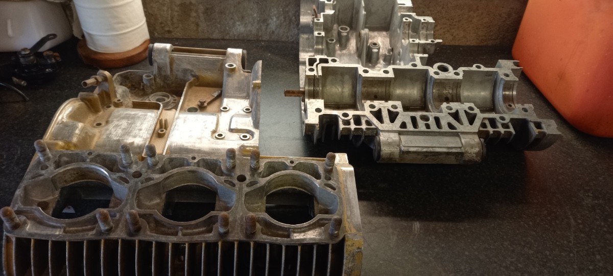

  1. Moving on with the next project now the RGV is back together. Few years ago bought a GT380 engine in bits as a spare for my bike so plan to dry build it to see what’s there. Ive got all the major parts, it will be the small widgets I’m missing. First job on the crankcases is to strip off some gold paint on the upper case.

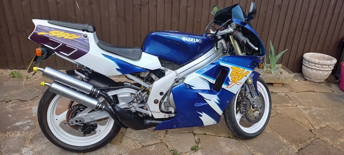

  4. Finished off the RGV, well almost. The rear brake light isnt working properly so need to investigate the switch.

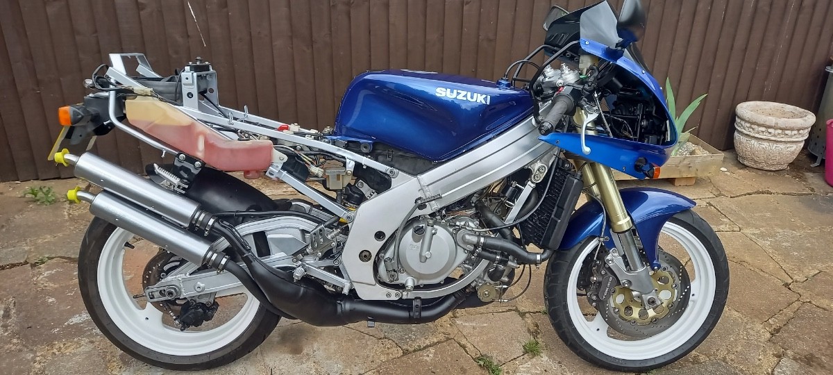

  5. Set up the RGV power valves ,checked carb and oil pump settings and got it fired up. Rode it down the drive, first time it’s moved under power for a year or so. Once I was happy it was ok, I took the Lh engine cover off for a repaint.

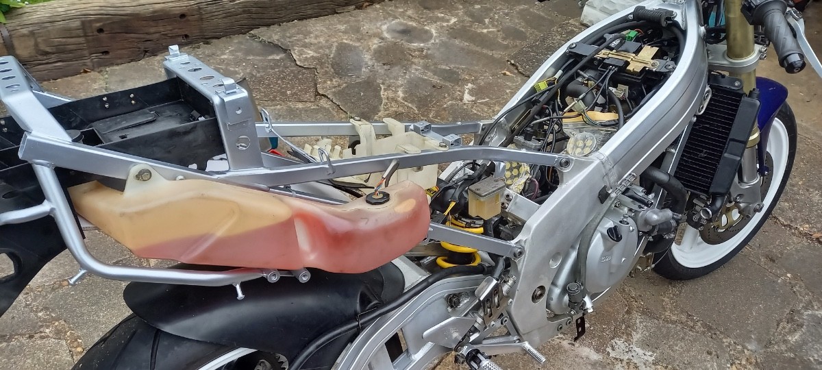

  7. Stripped and repainted the rear subframe on the RGV. Fitted it back to the frame and started reattaching everything; oil tank, coolant reservoir,cdi box, battery box, loom.

  15. The shape of it looks like a two stroke expansion chamber, tapering to a small silencer?
