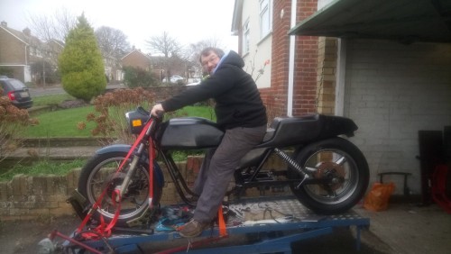

Started stripping my GSX1100 ET chassis yesterday and test fitted the swingarm today. Reliant on help from my mates at moment as my left wrist is still very sore. Rested one piece fibreglass body kit on the frame.

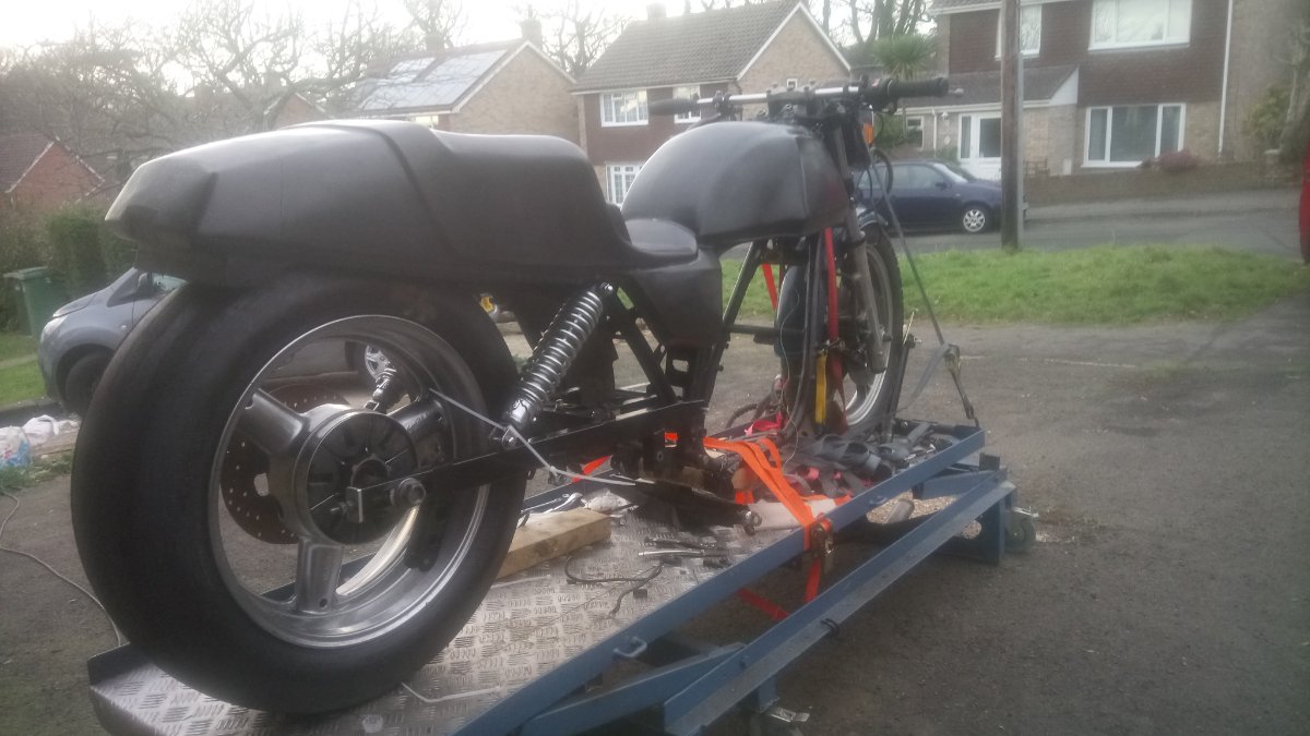

Had my dragslick rear tyre fitted to Hayabusa rear wheel this week. Had a mate here to help so thought we'd do a mock up and fit it to swingarm to get stance right, measure for struts and front fork spacers. Yes I know disc is rusty, wheel is wrong way around and swinger held on with cable ties.
