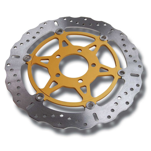

I'll be fitting the SS disks instead the Standard ones to prevent the rusting.
Need to keep in mind the current disks aren't OEM and probably not even EBC.
The main problem is arriving home late and not being bothered to clean the bike before leaving it for days.
Expensive lesson I know.
These
EBC XC- Series Front Disc - MD1154XC
Instead of these
EBC X- Series Front Disc - MD1154X
  • Like 3
