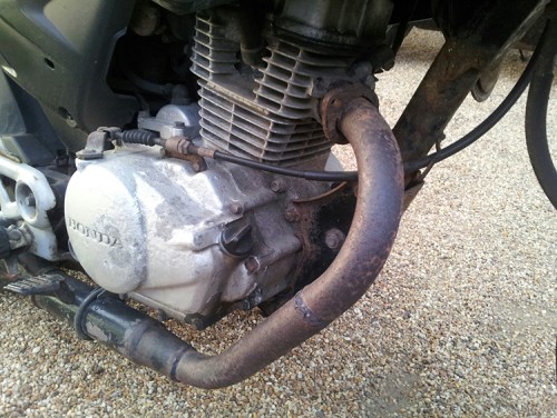

Just a little FYI though, Moo started out on a Kymco Zing (later owned to death by Petrolhead) and saw all the fun of my Lexmoto first hand, so she's speaking from personal experience rather than prejudice. My feelings are known on Chinese/Taiwanese bikes, so will keep quiet apart from that. In the meanwhile, please enjoy this photo of a FIVE YEAR OLD CBF125 taken at the Connington bike meet last night: Note that the exhaust is now held on by willpower alone as the bit it should attach to has snapped off the engine.
