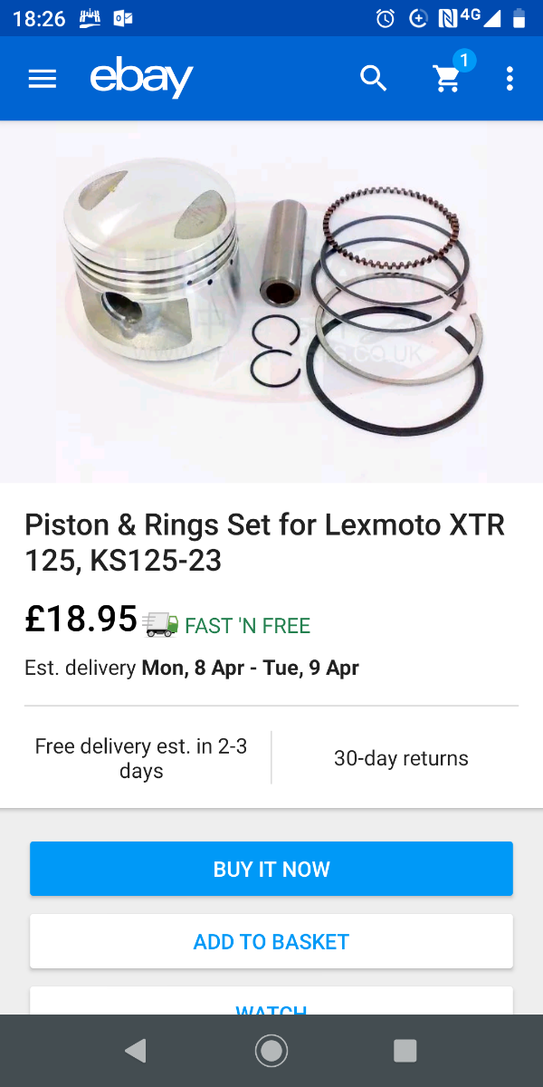

fastbob Posted April 4, 2019 Share Posted April 4, 2019 Anyway, how about this for a neat solution ? Quote Link to comment Share on other sites More sharing options...
fastbob Posted April 4, 2019 Share Posted April 4, 2019 Or just the piston if you prefer . Wonderful thing eBay, you can buy almost anything with a click of a mouse Quote Link to comment Share on other sites More sharing options...
Smithers Posted April 4, 2019 Share Posted April 4, 2019 The big bore set looks great value for money. Try getting that made in this country for that money. Quote Link to comment Share on other sites More sharing options...
