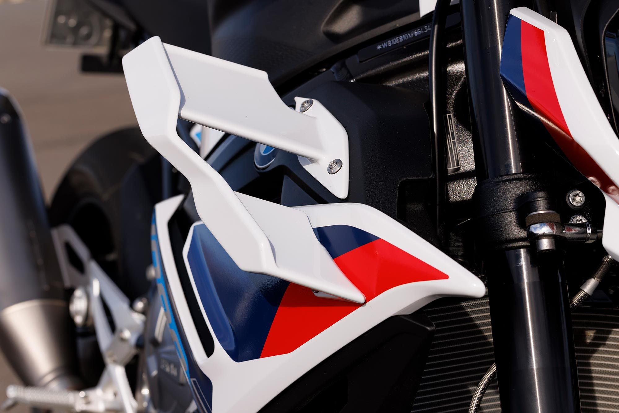

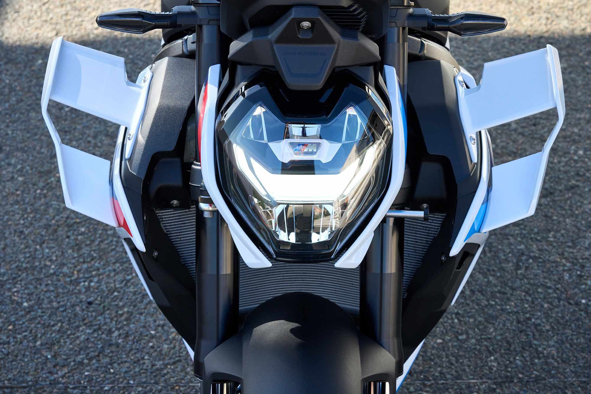

The answer? Winglets. Yes, those MotoGP-looking wings on the front of the new M 1000 R create enough downforce that BMW felt it could uncork the engine and deliver the four’s full neck-wrenching performance on a naked. And holy crap, did they ever. So, essentially, you get an S 1000 R that’s “on the juice.” One that is equipped with trick chassis parts, and a ton of fancy M parts that make the bike worthy of that famous motorsport letter.

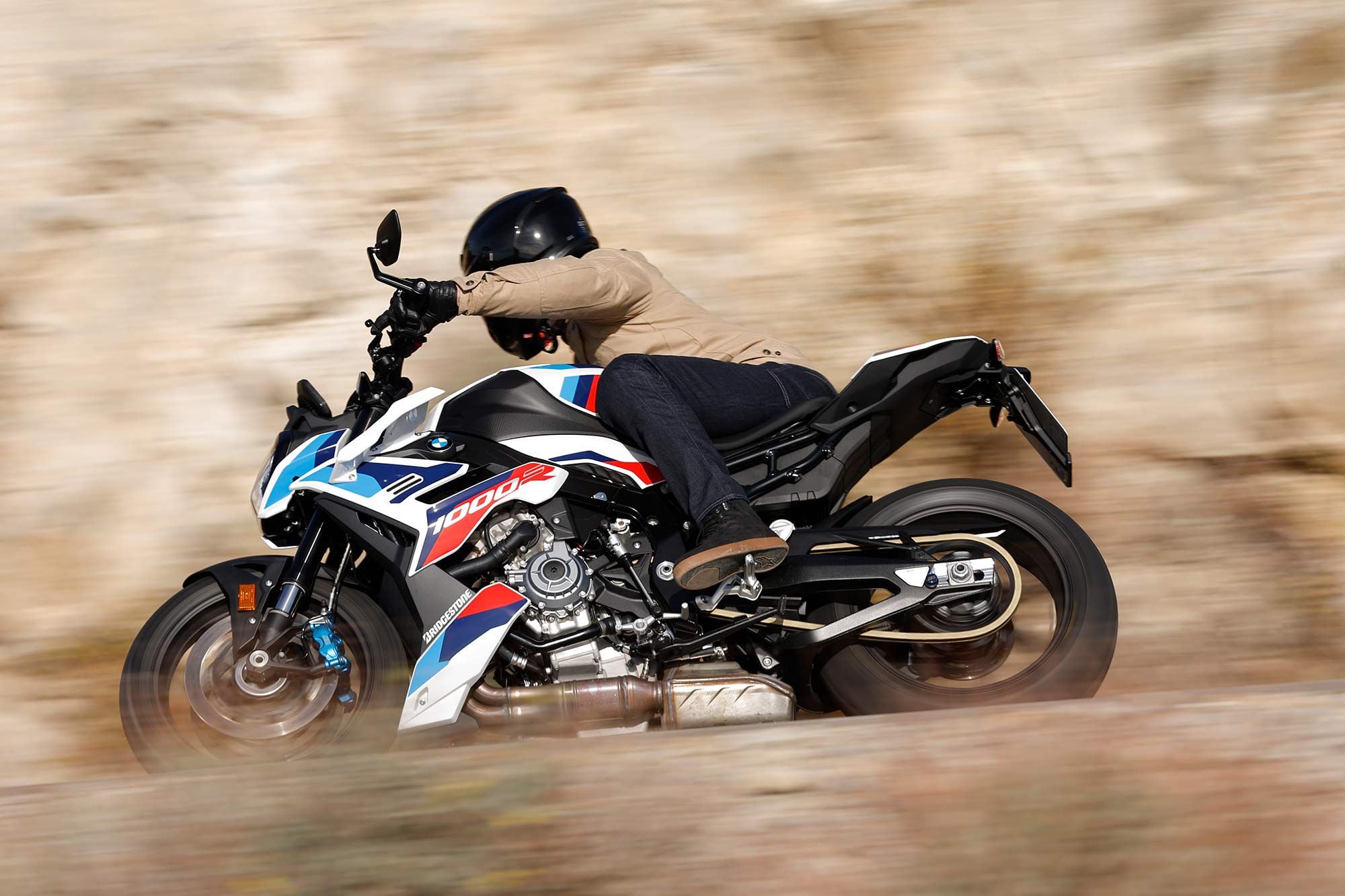

2023 BMW M 1000 R out in the wilds of Almeria, Spain.
2023 BMW M 1000 R out in the wilds of Almeria, Spain. (BMW/)
The M 1000 R is BMW’s second model to carry an “M’' badge following the M 1000 RR that was first unleashed in 2019. BMW doesn’t slap that on any ol’ bike; the new M R is an exclusive and potent interpretation of its naked roadster, meant to provide insane performance with racebike-like components and electronics.

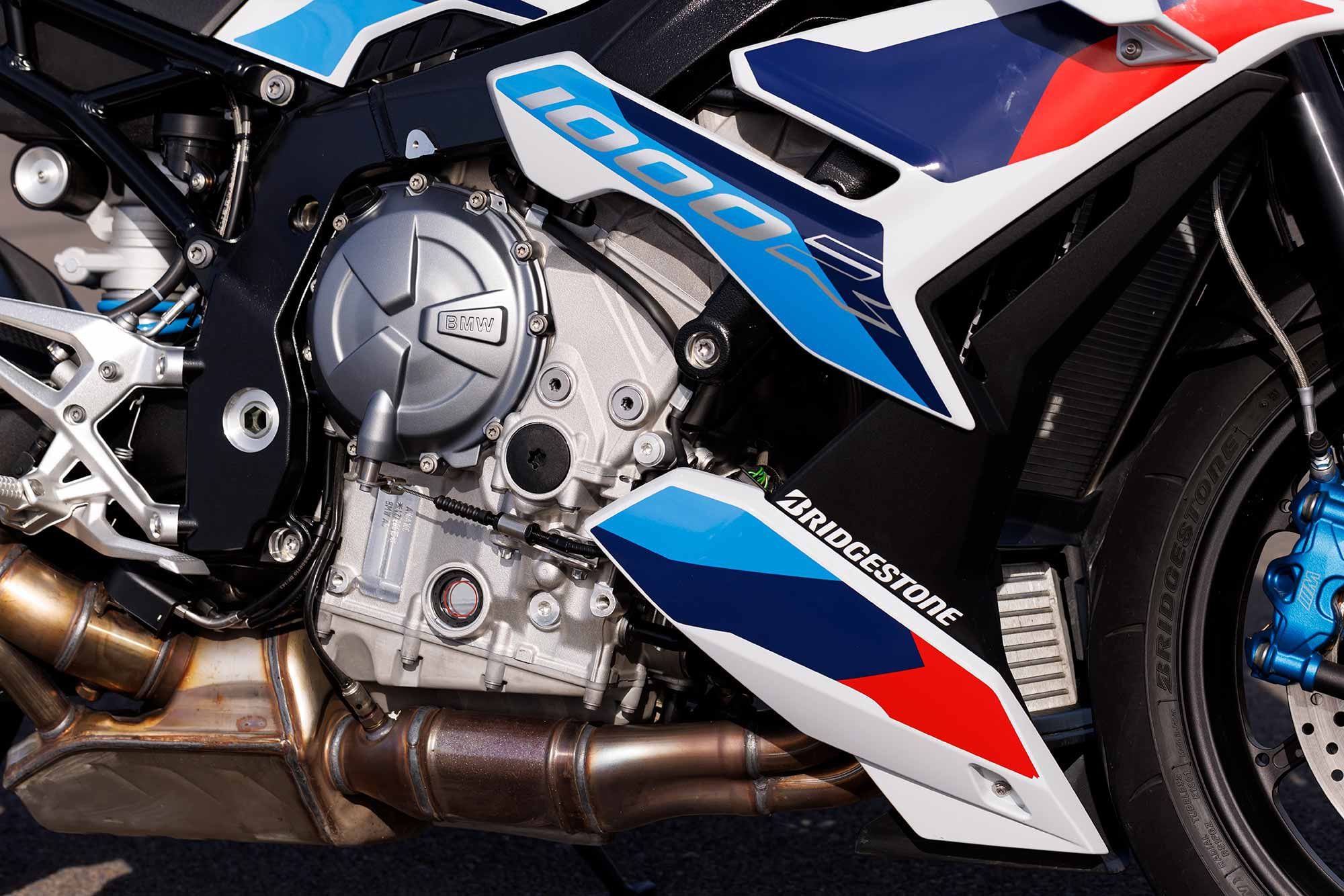

Unlike virtually every Japanese competitor in the naked-bike category, the engine in this M 1000 R is the same generation and an almost identical version of its donor; we’ll get to those few differences in a second. But like the RR, this engine features ShiftCam variable valve timing, titanium valves on both the intake and exhaust sides with ultralightweight cam followers actuating the valves. To keep the width of the engine to a minimum, the camshafts are driven directly from the crankshaft without an intermediate gear. The reduction gear for the camshafts is in the cylinder head. Like the RR, the airbox features new variable intake funnels that shorten up to increase intake velocity in the upper rpm range and optimize power across the rev range. Four 48mm throttle bodies feed mixture to the engine. A titanium Akrapovič silencer is fitted as standard and sounds amazing.

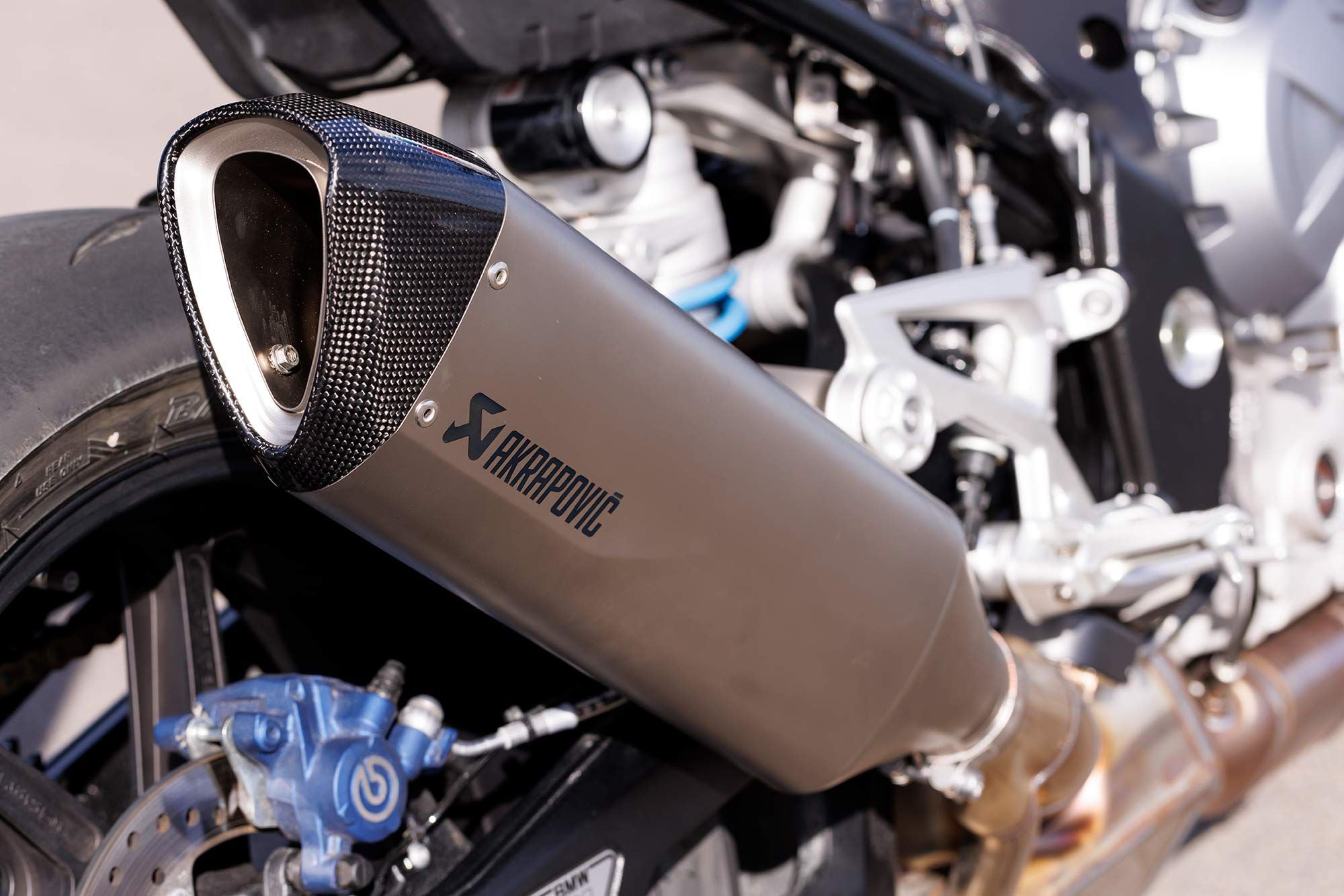

The titanium Akrapovič exhaust silencer not only looks fantastic, it sounds equally so.
The titanium Akrapovič exhaust silencer not only looks fantastic, it sounds equally so. (BMW/)
While the claimed horsepower on the S 1000 R is 165 at 11,000 rpm and 84 lb.-ft. of torque at 9,250 rpm, the M 1000 R cranks out a claimed 205 hp at 13,500 rpm and just a tad less torque at 83 lb.-ft. at 11,000 rpm. For reference, our 2022 S 1000 R made 155.4 hp at 11,250 rpm and 79.9 lb.-ft. of torque at 9,300 rpm at the rear wheel on the Cycle World dyno.

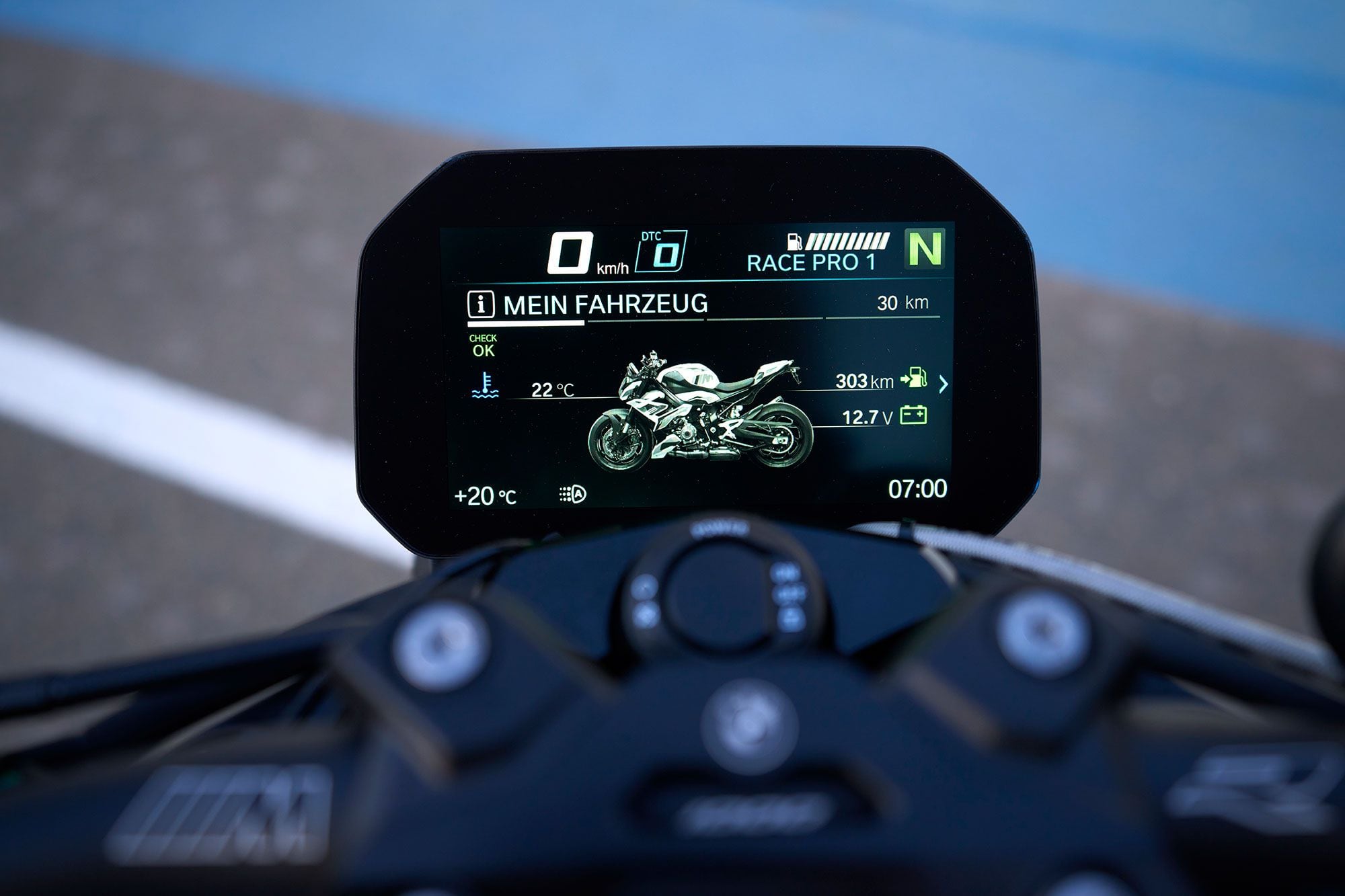

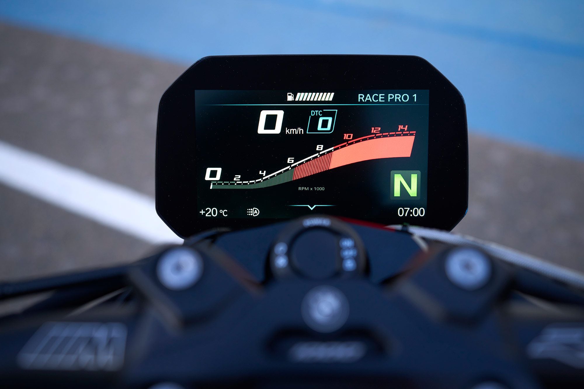

The 6.5-inch TFT display delivers information in a lot of different formats. You should find one you like.
The 6.5-inch TFT display delivers information in a lot of different formats. You should find one you like. (BMW/)
That DTC is the latest six-axis system as found on the RR, which feeds the computer info on lean angle to further refine the intervention for traction control, ABS, wheelie control, and Dynamic Engine Brake Control. Like the new RR, the M R gets the new Brake Slide Control extension of ABS, that allows the rider to hang out the rear end under hard braking and back the bike into the corner. The system uses the six-axis IMU’s info and sensors on the steering head and rear wheel to allow a preset drift angle to be allowed before interrupting the fun. The angle is preset and only works in ABS Pro Setting 2. Other features include Shift Assistant Pro, Launch Control, a Pit Lane Limiter, Hill Start Control Pro, heated grips, and cruise control.
What is missing from the new RR’s electronics is Slide Control, which on the fully faired bike allows the rear end to be drifted “on throttle” to preset angles. Another huge addition is the Dynamic Damping Control (DDC) electronic suspension, but we’ll address that below.
This display option was my preferred option while riding on the street. You can see your speed, DTC setting, mode, gear position, outside temp, a clock, and then some fun stuff like indicators of how much the DTC is being used, brake pressure, and max lean angle achieved.
This display option was my preferred option while riding on the street. You can see your speed, DTC setting, mode, gear position, outside temp, a clock, and then some fun stuff like indicators of how much the DTC is being used, brake pressure, and max lean angle achieved. (BMW/)For track riding, this option keeps it simple.
For track riding, this option keeps it simple. (BMW/)
The 6.5-inch full-color TFT display is borrowed directly from the M 1000 RR and offers four different display themes, allowing the rider to determine which type of info is important to them for the type of riding currently being undertaken. For track sessions, the rider can choose a theme that is weighted more toward the tachometer, lap timer, and info pertinent to lapping. While on the street the rider will likely want more standard info including tripmeters, odo, etc. But there are plenty of options to see only what you really need for the situation.

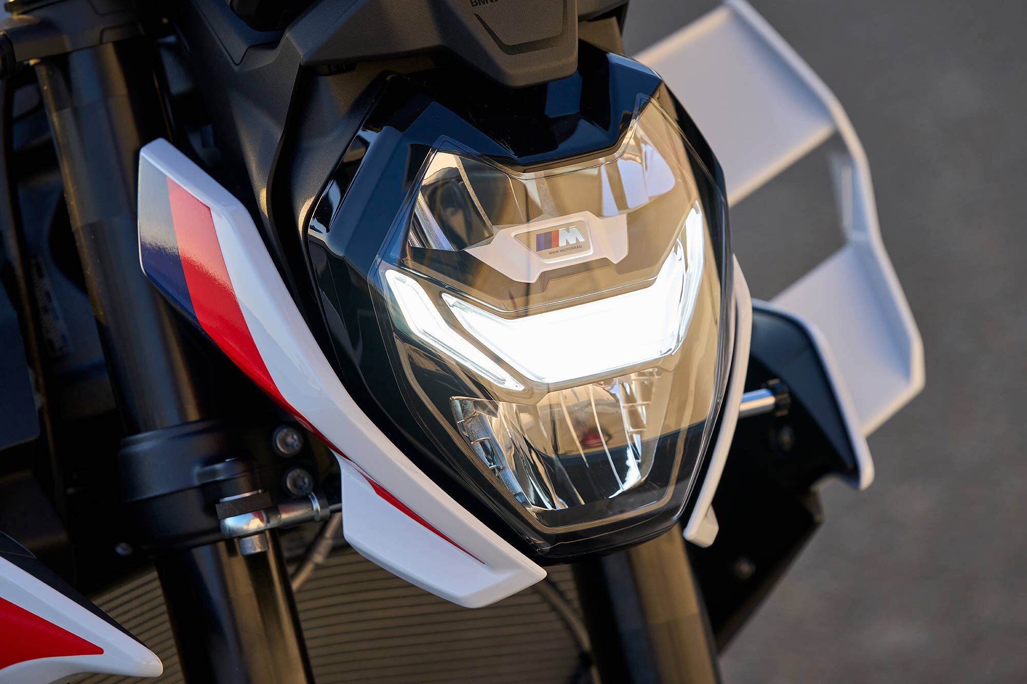

LED lighting is used all around with nice attention to detail like this M logo in the headlight nacelle.
LED lighting is used all around with nice attention to detail like this M logo in the headlight nacelle. (BMW/)

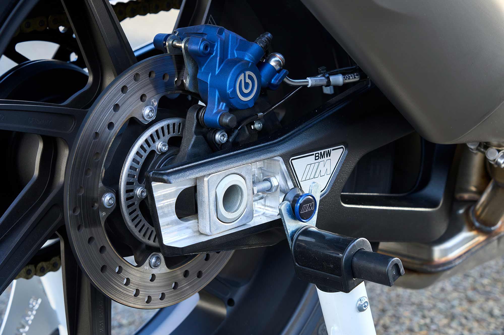

The M’s swingarm is virtually identical to that of its sibling, the S 1000 RR. A single-piston Brembo caliper and 220mm disc sit atop.
The M’s swingarm is virtually identical to that of its sibling, the S 1000 RR. A single-piston Brembo caliper and 220mm disc sit atop. (BMW/)
Where the chassis differs from the double R is that the M R doesn’t adopt the adjustable swingarm pivot point and doesn’t get the adjustable shock height feature for rear ride height. Otherwise the chassis is very similar to RR’s and even features a near-identical gravity-cast aluminum swingarm. Wheelbase measures 57.1 inches compared to the RR’s 57.3, while geometry numbers are also slightly different with the M 1000 R’s rake set at 24 degrees and with 3.8 inches of trail (compared to the RR’s 23.6 degrees, 4.0 inches). Fully fueled curb weight is just a touch more than its faired sibling, tipping the scales with a full tank of fuel at a claimed 439 pounds (opt for the Carbon wheels and the M Competition Package and that drops to 428).

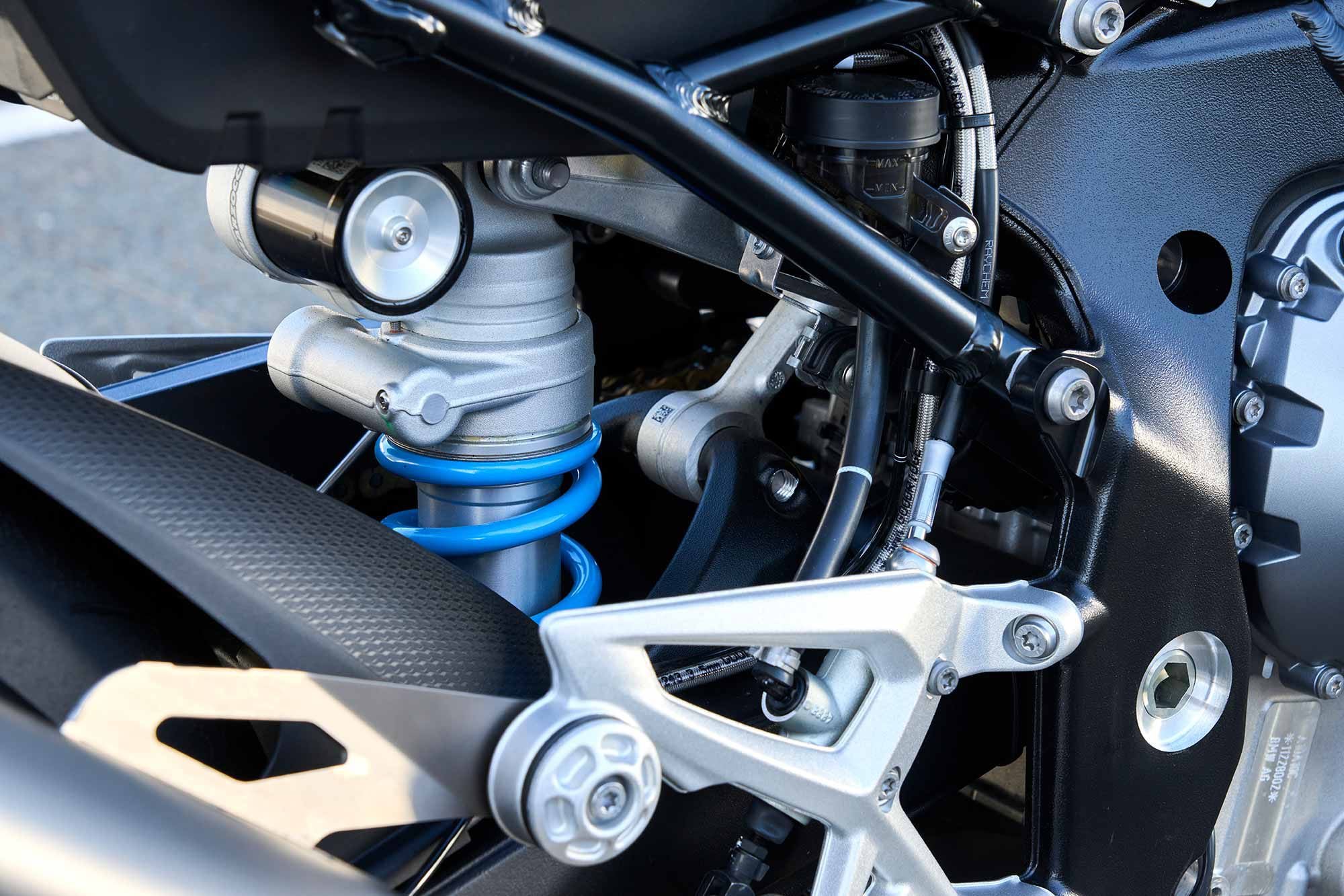

Standard Dynamic Damping Control (DDC) suspension is included on the M R, with a Marzocchi 45mm inverted fork up front and a linked monoshock out back. The fork is clamped by a milled billet-aluminum triple clamp (laser etched with the M 1000 R logo) and topped with a black aluminum tubular moto-style handlebar (with billet aluminum bar-end mirrors) and tamed by an adjustable steering damper. As for the DDC, the suspension damping settings are tied to the four ride modes: Rain, Road, Dynamic, and Race. In those standard modes there are preset damping settings, while the additional (included) Race Pro settings allow the rider to go in and individually tailor the settings to preference.
The DDC Marzocchi shock’s damping is controlled by the computer depending on the mode selected on the dash. Preload is still set manually.
The DDC Marzocchi shock’s damping is controlled by the computer depending on the mode selected on the dash. Preload is still set manually. (BMW/)

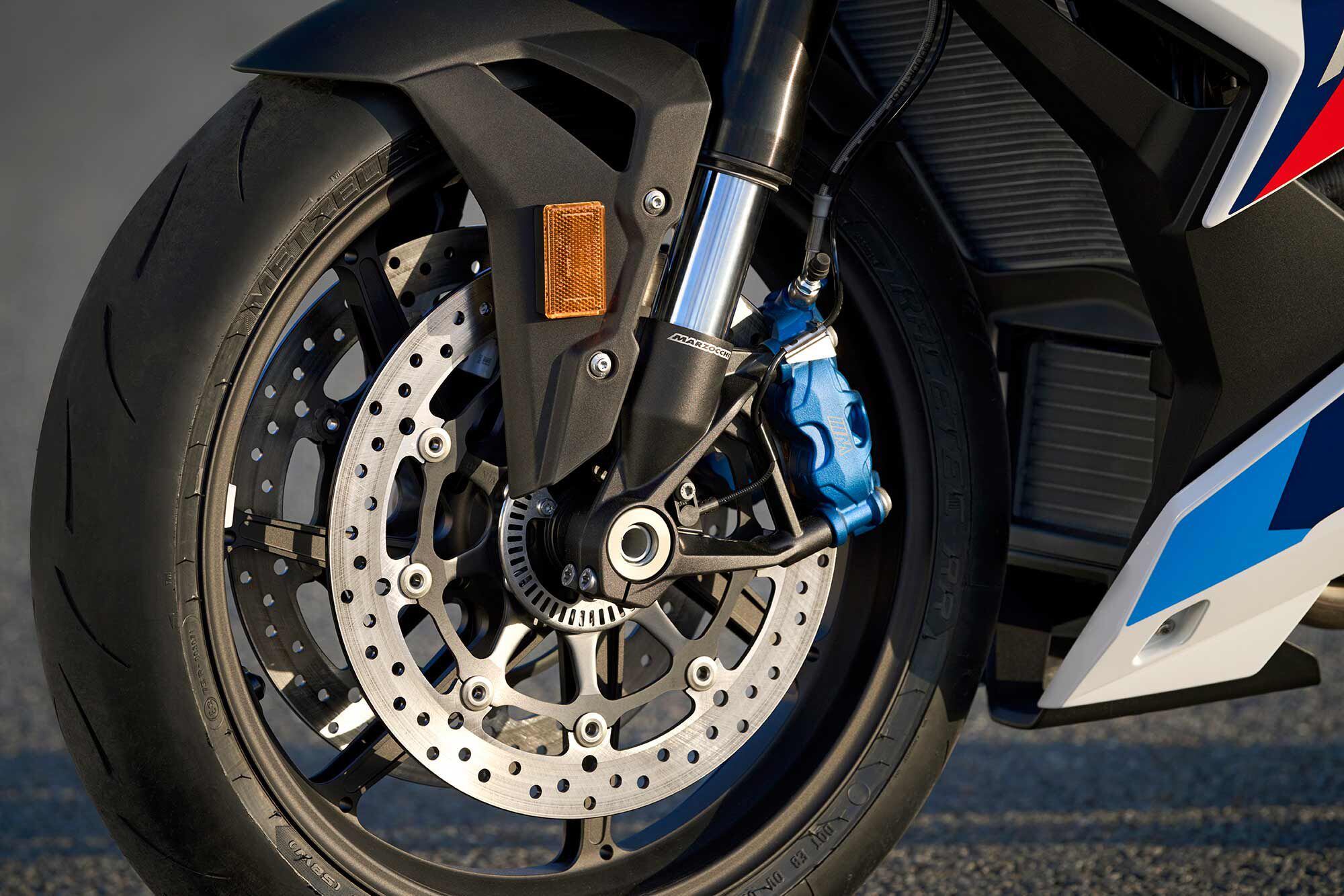

Top-end anodized Nissin radial-mount four-piston calipers and 320mm discs handle braking duty in the front, while a single-piston Brembo caliper and 220mm disc reside in the rear. The M 1000 R comes with really nice forged aluminum wheels, but as mentioned, if you want the carbon fiber wheels, they can be obtained by opting for the M Competition Package ($4,995), which also includes the M Carbon Package (bodywork) and M Billet Package that includes rearsets. Super-nice billet-aluminum levers are already included on the bike as standard.

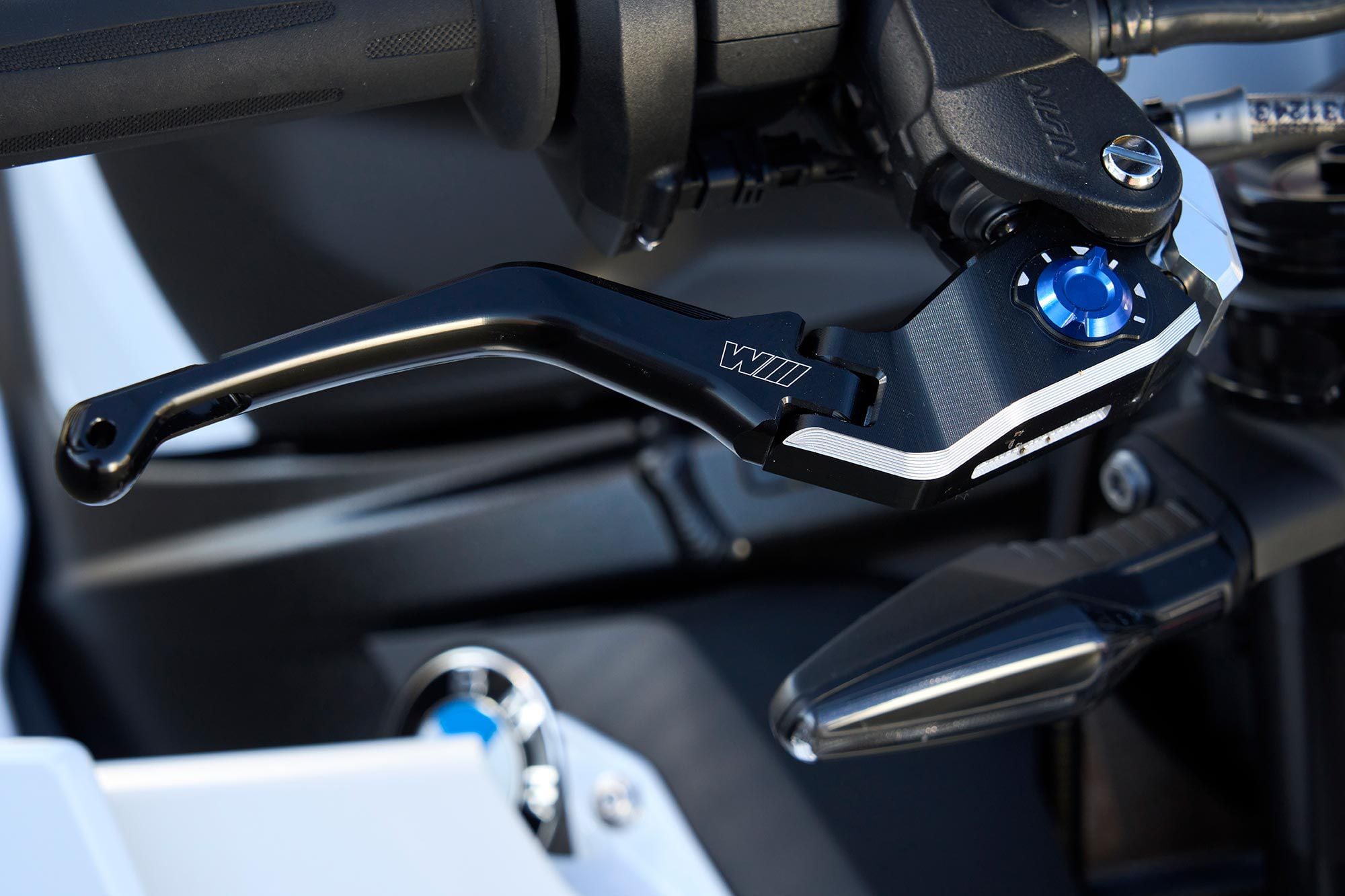

Standard on the M 1000 R are these beautiful billet aluminum pivoting levers.
Standard on the M 1000 R are these beautiful billet aluminum pivoting levers. (BMW/)

As we mentioned above, one of the keys to being able to unleash the full performance of the inline-four engine according to BMW engineers—without having to “tune it for torque” and “real-world riding”—was the addition of the winglets. It might not sound like a lot, but BMW claims that at 136 mph the M’s wings provide 22 pounds of downforce, which they felt was enough to take the handcuffs off the engine. Like the similar wings on the RR, the goal is to reduce wheelies and provide stability, therefore generating acceleration with less electronic intervention. Obviously, the focus here is for trackdays, which with the level of components the M 1000 R has, makes the bike perfectly suited for racetrack duty.
The winglets on the M 1000 R generate 22 pounds of downforce at 136 mph, which gave BMW the confidence to unleash the inline-four’s full 205 hp.
The winglets on the M 1000 R generate 22 pounds of downforce at 136 mph, which gave BMW the confidence to unleash the inline-four’s full 205 hp. (BMW/)
