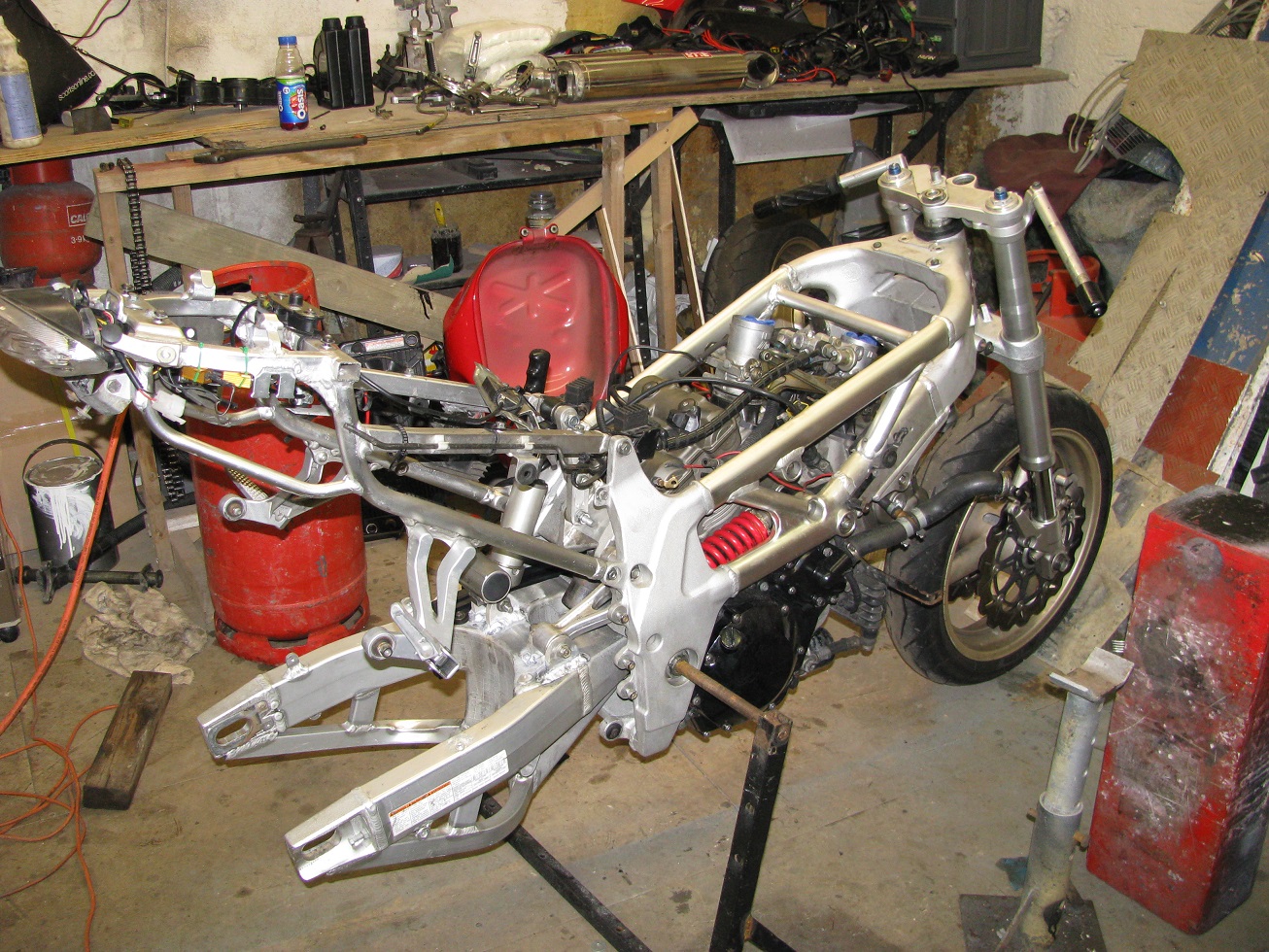

I set about making the mounts for the suspension on the TLR swingarm I have fitted
I started off with a bit of flat alloy bar 10mm thick cut in to 4 pieces and shaped in to mounts
theres not many pics as I just get on with it and forget to take pics plus its time consuming :lol:
pretty straight for a hacksaw :lol:
and before I knew it the where shaped drilled and welded to the swingarm :lol:
I also fitted the top yolks clipons forks and front wheel today too

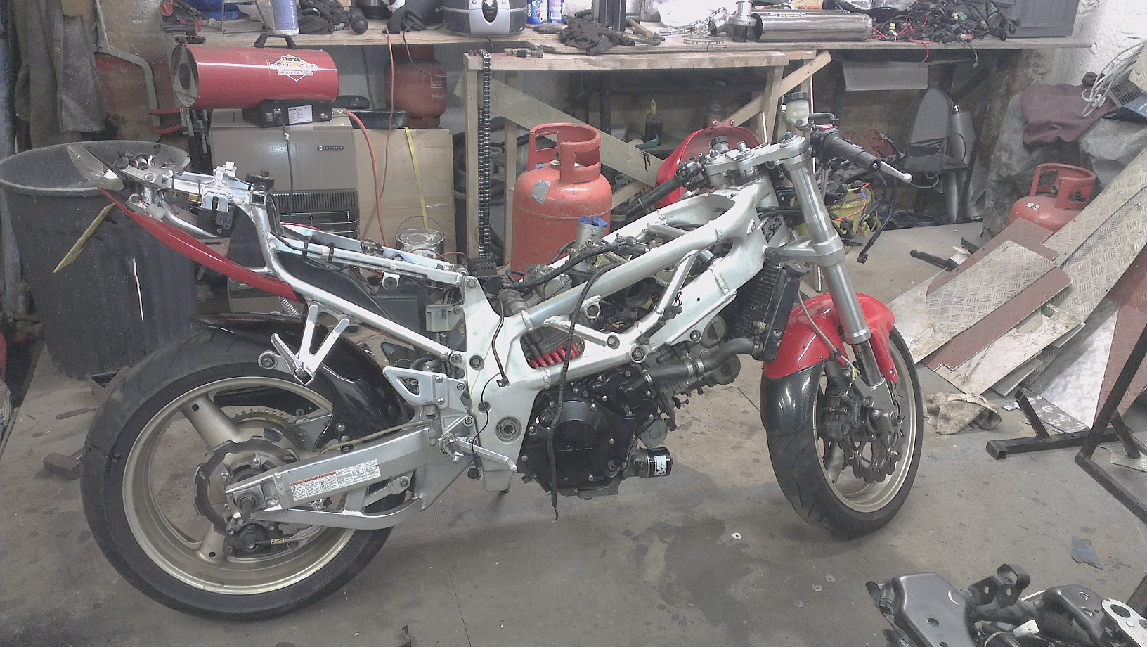

Nice productive day today
all brakes rebuilt and bled up clutch slave cylinder rebuilt and bled all switch gear fitted clock bracket fitted new larger rear sprocket fitted rear sets back on side stand on all wheels on radiator fitted oil cooler removed as I need to either move it or alter my new headers

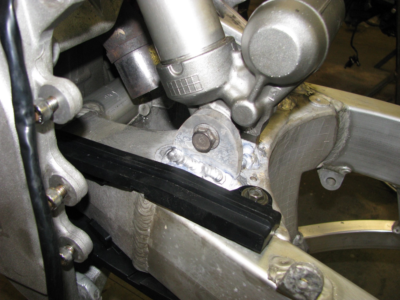

ran into a problem with the side stand it was catching the bracing on the swingarm
easy fix just weld a blob on to the side stand stop (no pics of the welding)
I welded about 5mm on to the stop and now the stand clears about 15mm so jobs a good un
few pics of how it is sat now and of the braced swinger and the rear calipers.......I tend not to take many pics I just get on with it :lol:
