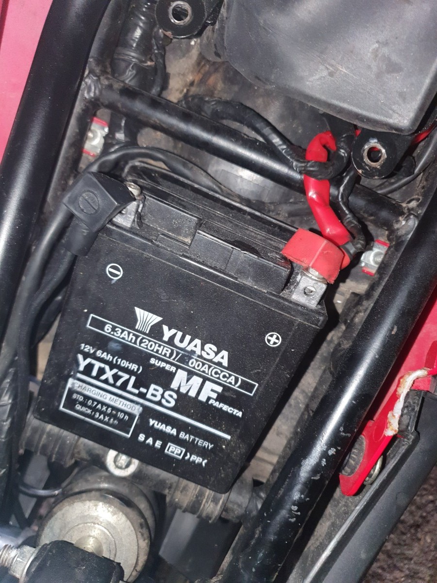

Mississippi Bullfrog Posted March 16, 2023 Posted March 16, 2023 8 hours ago, simon1991 said: It's not that it's do it only when gets warm I'd still check the battery leads as @boniosuggested. It is amazing how many issues are caused by loose connections and bad earths. Quote
simon1991 Posted March 16, 2023 Author Posted March 16, 2023 Checked the battery cables today all looks spot on 1 Quote

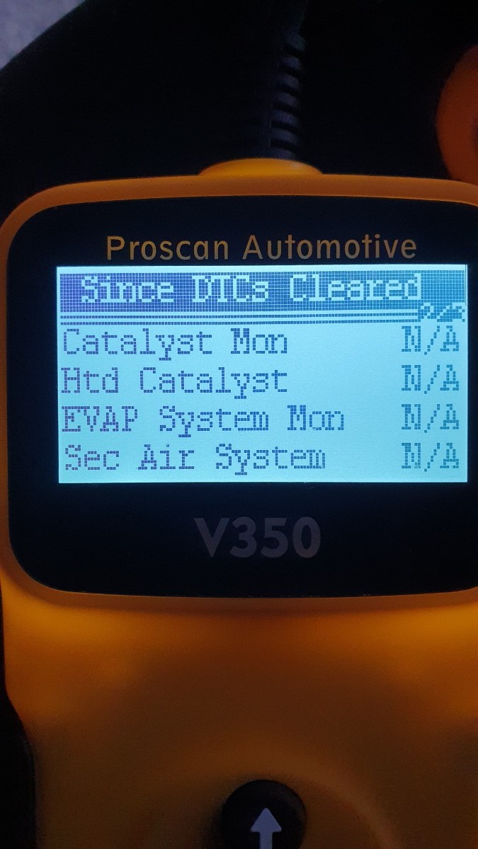

simon1991 Posted March 18, 2023 Author Posted March 18, 2023 I think the diagnostic will be the easiest way will book it on Monday and will let everyone knows what's the problem so you know for future just in case 1 Quote
simon1991 Posted March 31, 2023 Author Posted March 31, 2023 (edited) Done the diagnostic no faults at all bike still overheating Edited March 31, 2023 by simon1991 Quote
