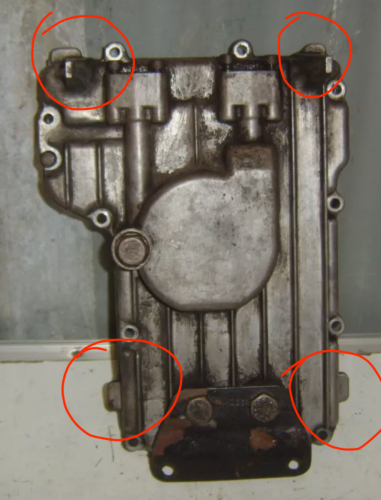

  20. Hi James . Have a look at these four points and see whether there is a corresponding point where you can insert a lever such as a very big screwdriver or a tyre iron . If so , be very gentle . Remember , you are NOT trying to wedge anything between the jointing surfaces , you are just trying to pop the gasket . Once you do get it off , the biggest job is going to be cleaning all traces of gasket off the engine and the new sump without digging into the metal . We'll cross that bridge when you come to it .
