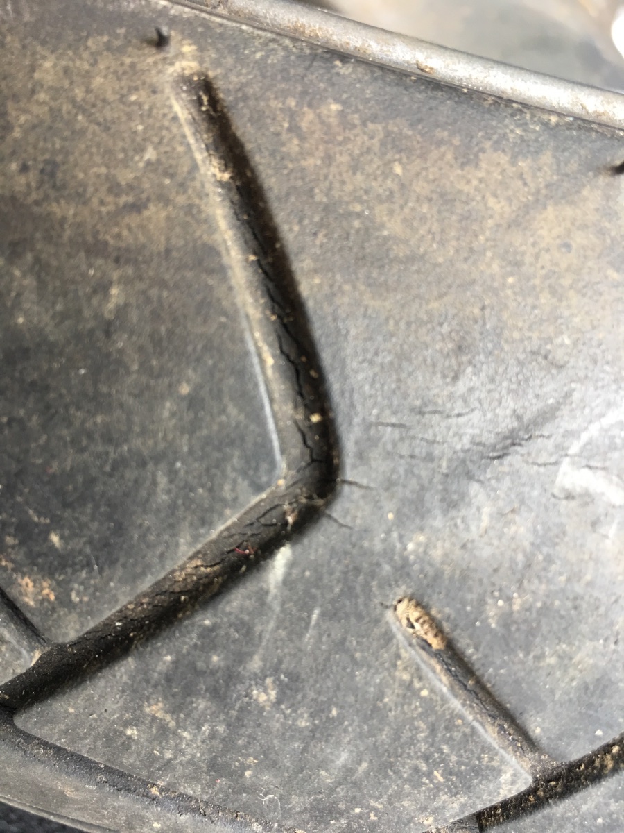

  15. I’ve just had the tyres removed from the wheels of the Trophy project, so the can be blasted & coated. They were dated 2002 and the front was cracked up n lots of places e.g. Still don’t know how this bike got an MOT? The upside was that it only cost me a total of £5 for both tyres including disposal, so big up to Spon End Tyres in Coventry
